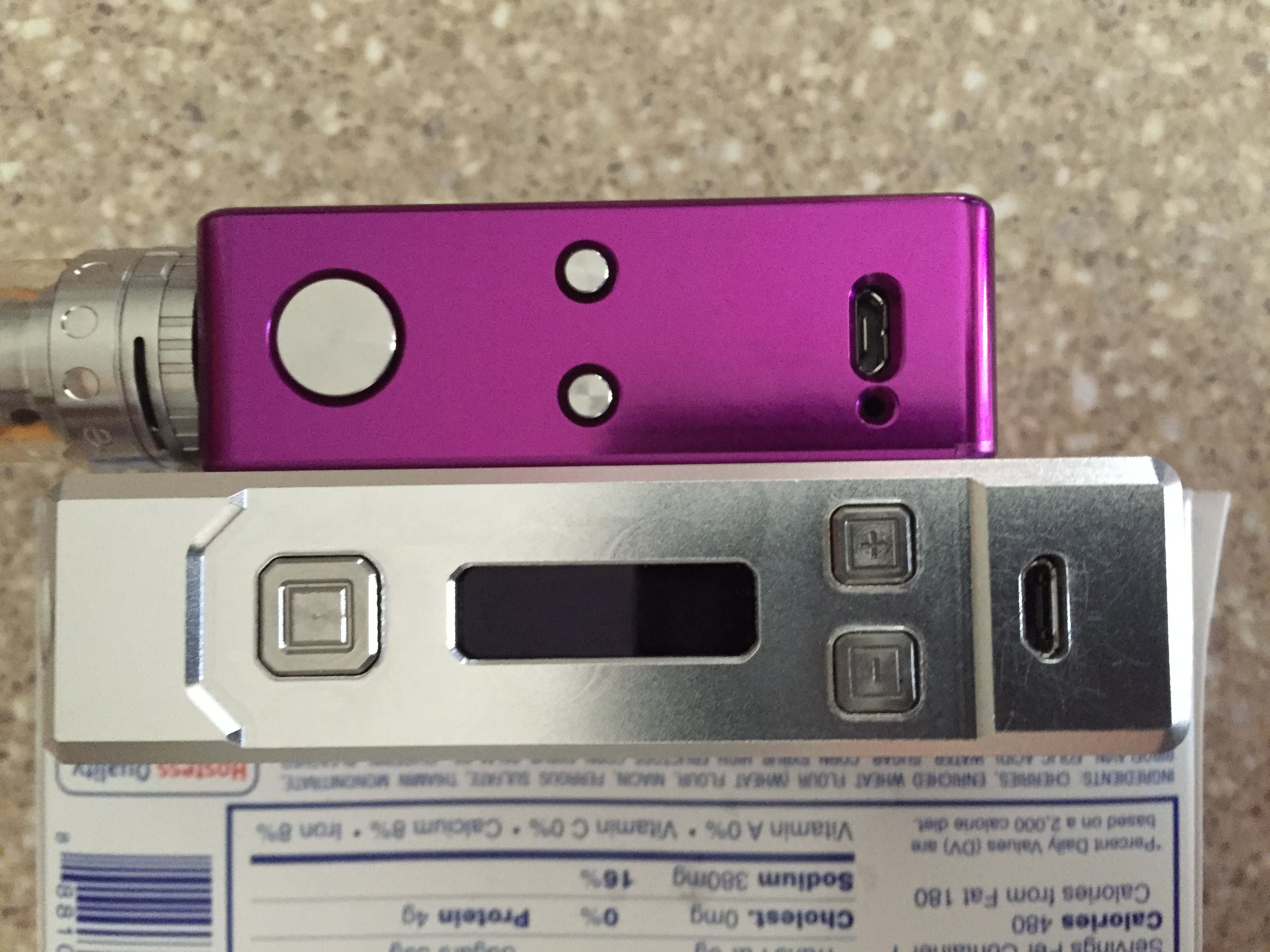

Reposition the usb connector of the DNA75
retird replied to martini3k1's topic in Installation and Assembly
After comment about modifying the Esquare I took the time to visit a Esquare and a DNA75 device. The Esquare uses the DNA onboard switches and a separate USB board.The DNA75 device uses the onboard switches and the USB is fixed to the board. Sometimes a picture is worth a thousand words.... -
