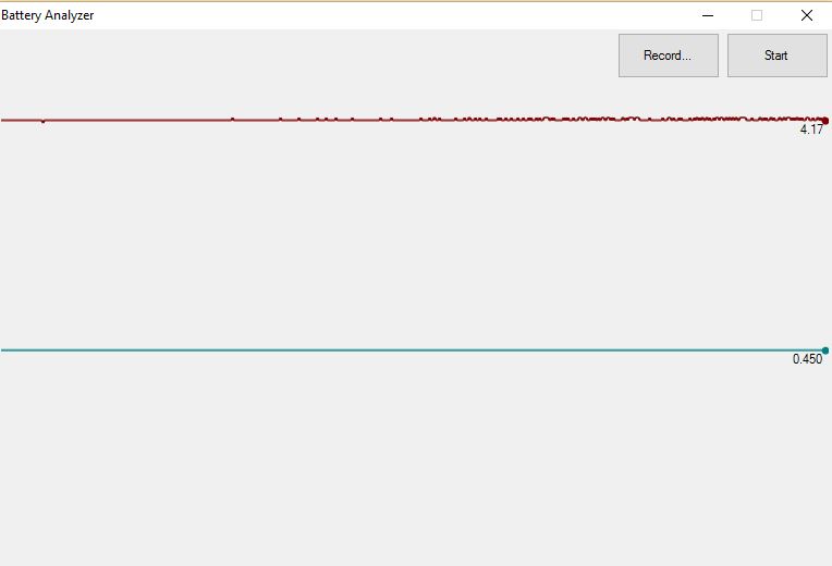

So I'm having virtually no problems with this mod and am really enjoying it. However, when plugged in via USB, the mod tops out at 99% charge (virtually brand new Sony VTC5). Problem being, when it stops at 99, my light doesn't turn from red to green like I have set up in escribe, and the lightning bolt symbol on the battery indicator doesn't disappear. When plugged into escribe at "99%", the device monitor shows a nearly completely flat signal for the charging voltage which I assume means that it isn't charging anymore. However, like previously mentioned, the lightning bolt doesn't disappear and the battery analyzer cannot be run, stating "waiting for mod to fully charge". I have just uploaded the CSV file for a Sony VTC5 and the mod is currently at 94% plugged in. Any suggestions if it still doesn't reach 100%/green light/no lightning bolt? EDIT: I have gotten the device to display 100%. However, the charging light is staying red (supposed to turn green at 100% as set in escribe) and the lightning bolt symbol remains
