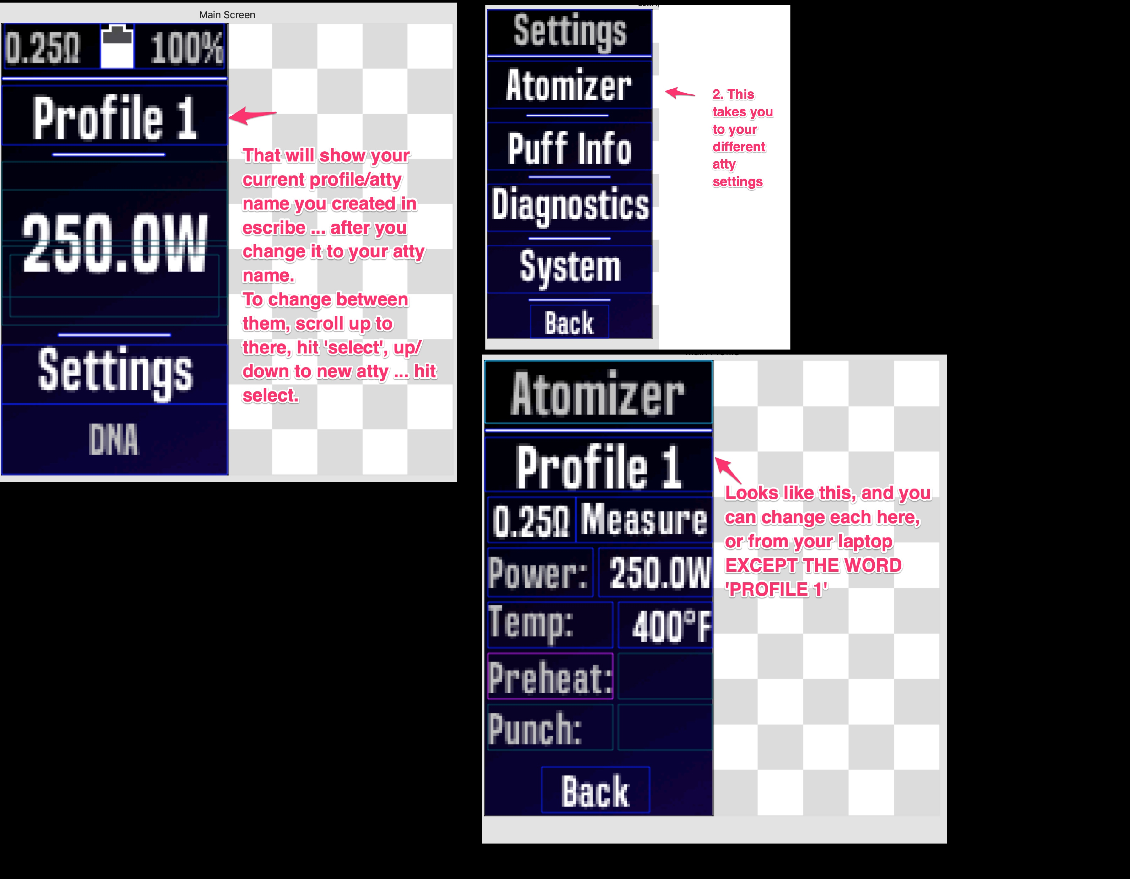

  2. No, not really. You can lock it, so no button works until you until you unlock. The only button you need to worry about is the select button while using the mod
