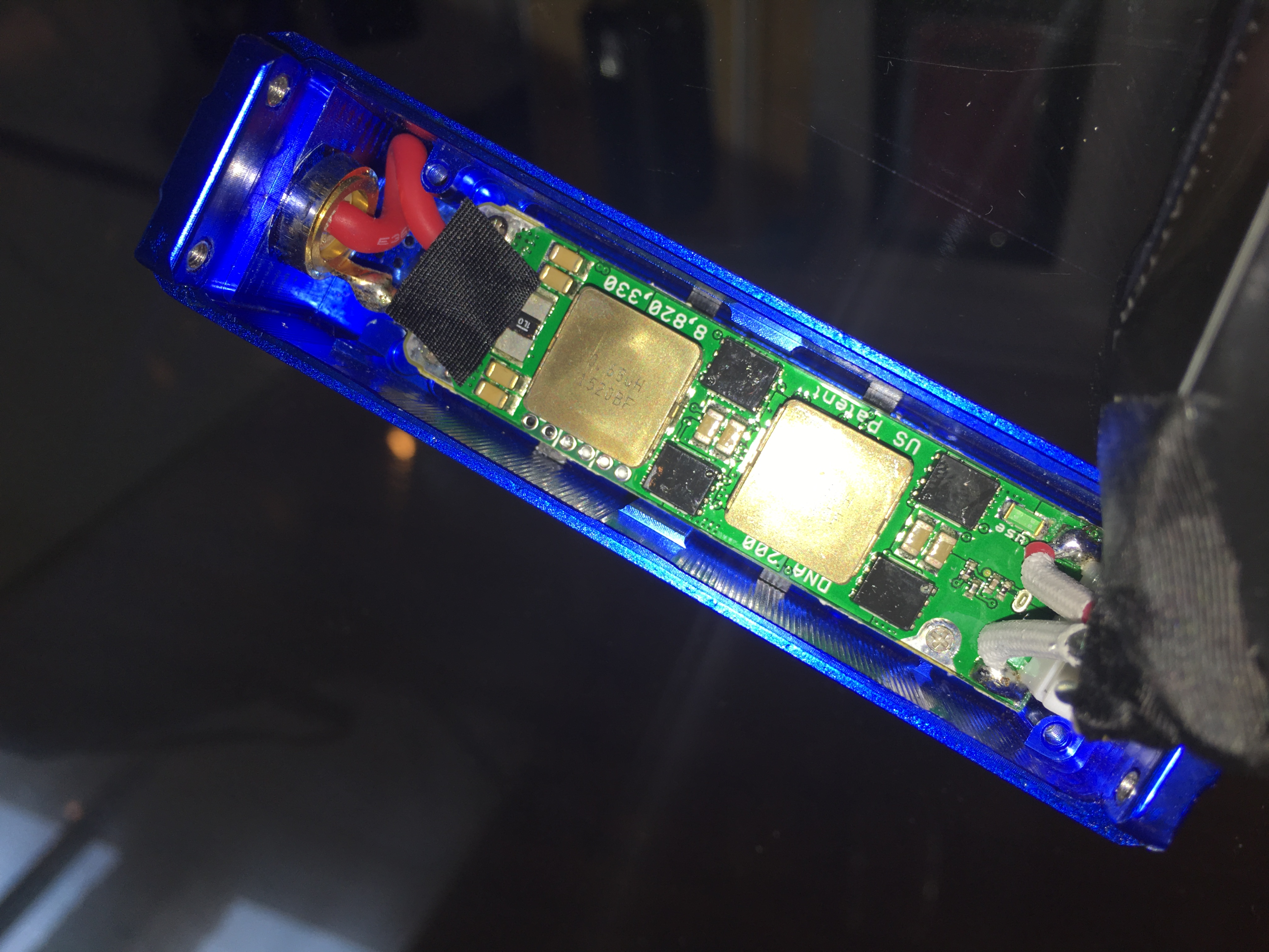

Even with a blown fuse they should communicate with escribe, I've also been using Ni200 @ 0.12-0.23 with 200w preheat for about 3 weeks with no issue however mine is a custom box. Maybe the issue is HCigar ? Seems to be the only common link in your issue. Do you have any pics of build particularly the wiring and chip itself

Just a stab in the dark here:
Notice how the positive wire is soldered.
It "appears" that the positive wire is directly over the top of some "vias".
Could this be causing an unintended short?
