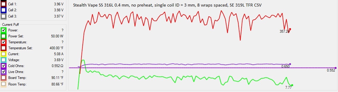

VapingBad Posted February 10, 2016 Report Posted February 10, 2016 Got my wire from Stealth Vape and only have time for a quick test right now so I used the thickest 0.4 mm and it is regulating temperature, not as smoothly as higher TCR wires, but it is doing it especially protecting against high temp. (time base 10 seconds)
