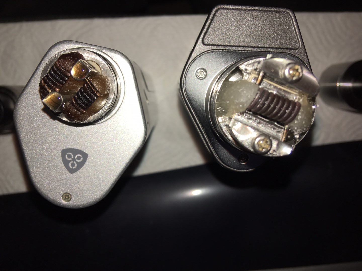

  14. Here are two setups I like, both using fused Clapton SS316L. The dual coil on the left is 3mm inner diameter and comes out at around 0.12 ohms The single coil on the right is 3.5mm inner diameter and comes out at about 0.38 ohms. I dry burn it in wattage mode to adjust for any hotspots, then allow it to cool down, wick it and swap to temp control. I like the csv on steam-engine.org for SS316L - its labelled there as "SS316L / Elite", but I've also attached it here for convenience. You should use the same csv even though your coil is likely to be different - the csv relates to the material. Beyond that, you'll need to experiment to see what works for you. Just start low with your wattage and punch and increase as required. I posted some more details of what works for me in this discussion: /topic/66214-topic/ I find this works well - but you'll just have to experiment to find what works for you. Good luck steamengine_SS_316L_-_elite.csv
