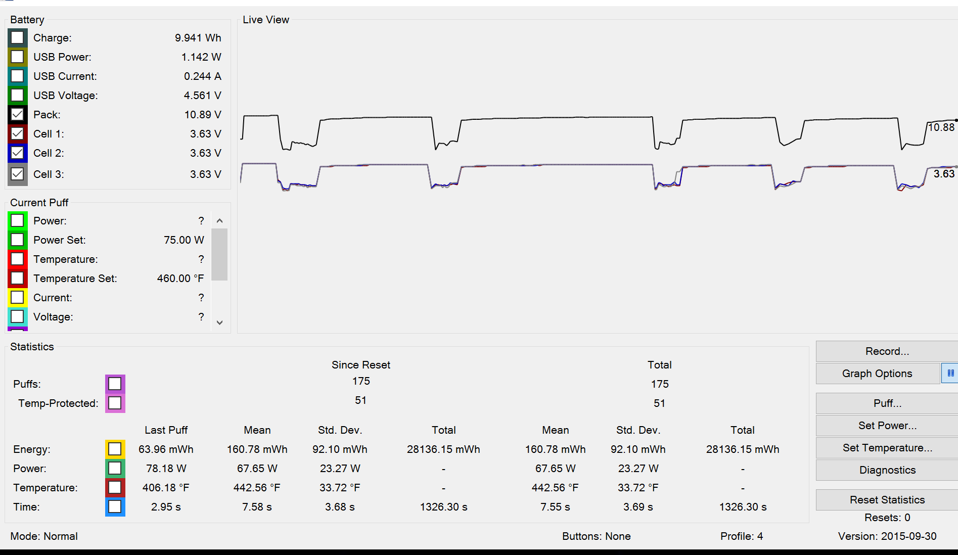

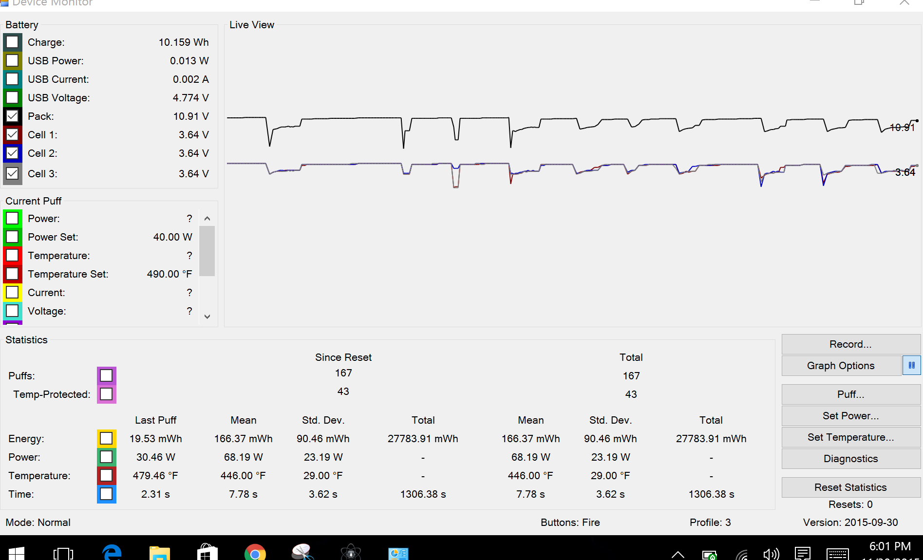

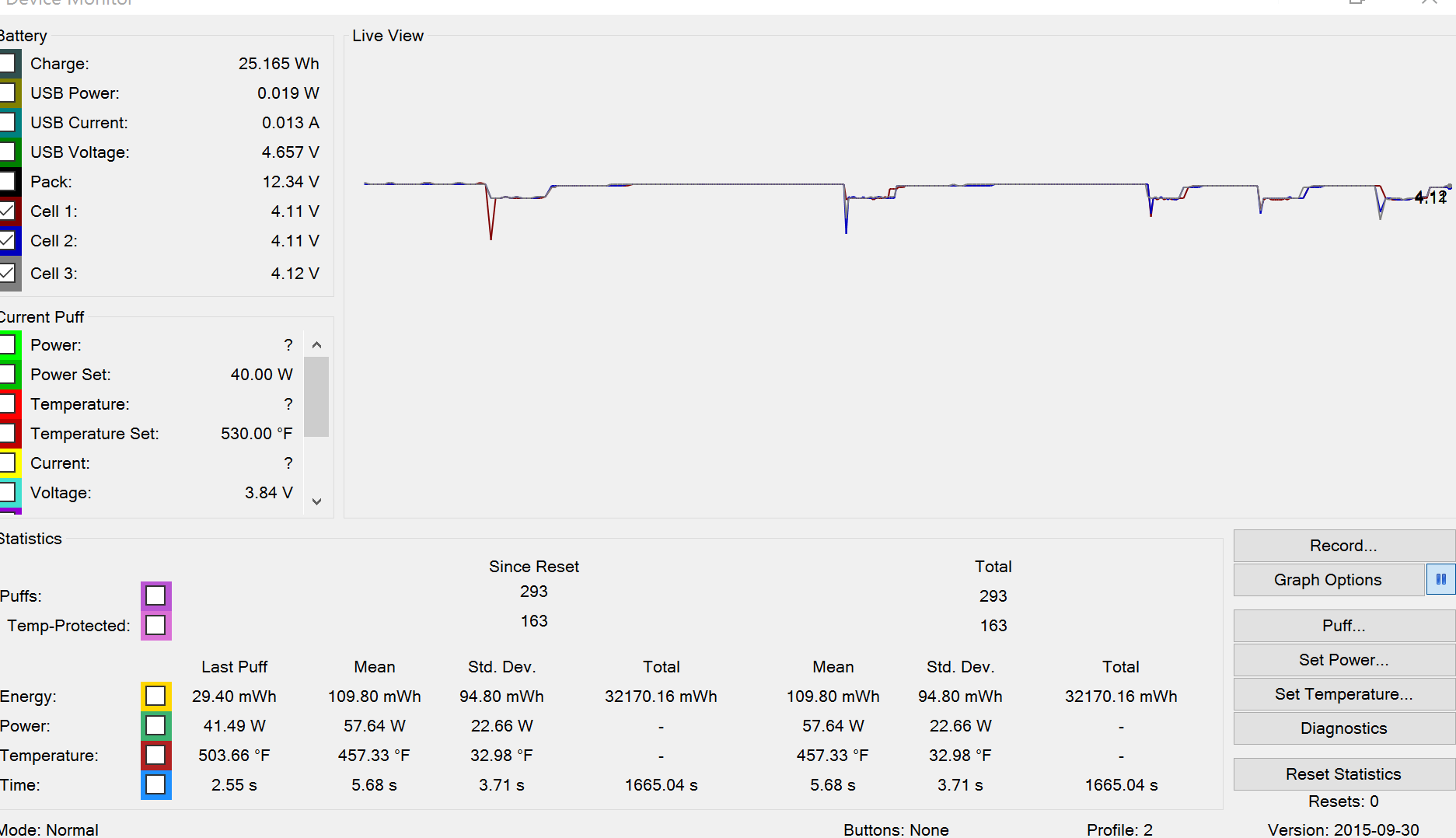

Because you have a high voltage sag from the batteries.  18650s will never perform as well as decent LiPos
Really? I am into RC and my lipos are horrible for battery sag. Same ones that the DNA200 often uses. And the electric car manufacturers have lots of smart scientists, researchers, and engineers. And oddly enough they are using 18650s for their battery packs. So you better call them and set them straight. :)
They also use Li-Po's for their battery packs...  just one example...  http://www.ronlund.com/rcheli-prod/ELEC_BATL6/CS5200-6S-50C.html
Only 140 W as the coil I had handy for the battery analyser was 0.557 ohm and the power limit for that is about 145 W, I'm sure it would look even more dramatic if I used a higher power and newer LiPo let alone a 90C LiPo.  Same charge level, same fire duration 5 seconds, same coil, though the LiPo has had a lot more charge cycles that the VTCs, the LiPo is only a 30C rating 900 mAh.
