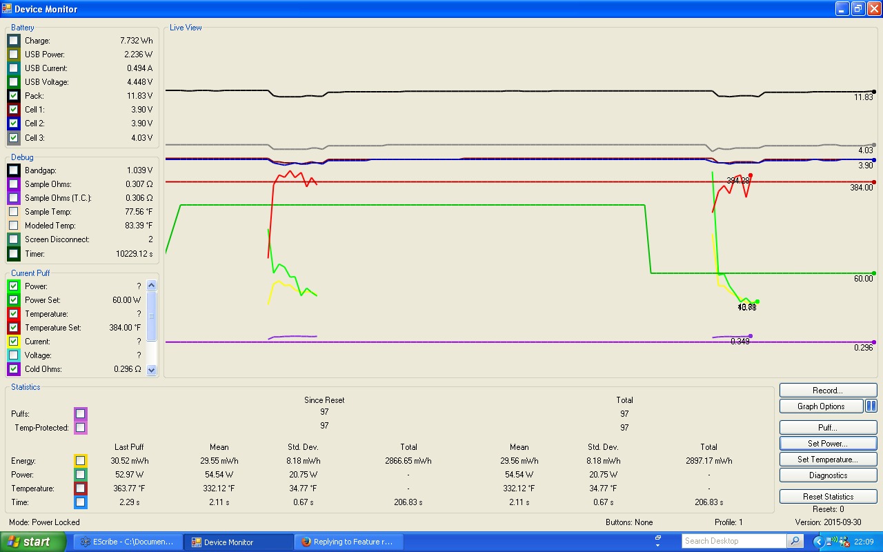

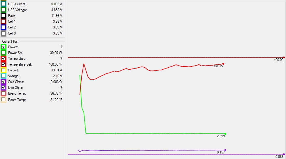

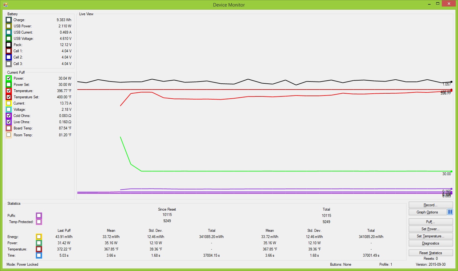

VapingBad Posted October 25, 2015 Report Posted October 25, 2015 "religious war" bit OTT.Both ways ultimatly adjust power, I keep the temp set for flavour, but am usually at the temp limit because my ADV is a genny, but on a dripper with more room and airflow I still keep at the same temp and adjust the watts & airflow. And I always have the preheat punch at max normally for 1.5 seconds, 200 W on cotton, but anywhere between 80 W and 150 W on gennnies as until the mesh oxidises more with age you are at risk of shorts and on some builds you can burn through a leg at 200 W.This has pre heat 100W, punch 11, time limit 1.5 s, time scale 10 sec. ETA the pre-heat is even more important/effective running below the temp limit than running at temp.No pre-heat needed running at temp, pre-heat turned off just using the temp limit to control everything which is fine, just addressing the previous posters point on pre-heat.

Dejay Posted October 30, 2015 Report Posted October 30, 2015 Thanks @VapingBad for posting the graphs!And sorry lol but there are some discussions where some people correct other people saying that the DNA only does temperature limiting and not temperature control and that it's totally wrong one way or another. Not trying to start something here but trying to understand! And imho your graph shows that the DNA can do both and that they are different. Those graphs seem to show that the temperature "reacts" to how you vape. So if you draw a bit slower the temp gets hotter and if you draw more forcefully the temp gets lower and you get those bumps in the temp curve. That means it should be a different experience. Maybe the difference between a more "organic" vape (Temperature limiting - vaping on a glowing ember) or vaping more digital (temperature control - vaping on a high tech machine). This might also depend on how homogeneously the atomizer's chimney and drip top you are using is cooling the vapor.PS: Of course I still very much prefer the temperature control approach and would love an option to change temp with + and - buttons directly
VapingBad Posted October 30, 2015 Report Posted October 30, 2015 ThanksI say temp limiting as it only technically limits the max temp, maybe being pedantic, but in my line of work being loose with technical terms can cause mistakes through miscommunication and being precise is part of the discipline. I often vape on the limit at a constant temp, I just don't use the temp to adjust vapour production as I match the temp to the liquid I use for flavour.
