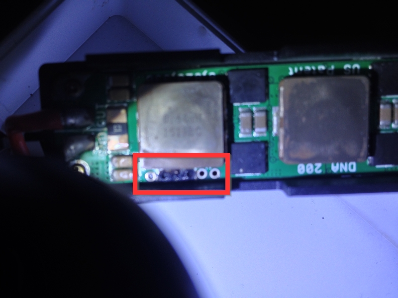

Disley Posted September 9, 2016 Report Posted September 9, 2016 My third SMY SDNA200 failed last week.The fuse has blown on this one.The previous two were replaced on warranty, so I didn't investigate why they failed.On both the screen said warranty repair, or warranty service, I don't remember.This last one was rarely used, it sat under my monitor, fully charger with an aeronaut dripper attached.I was reading something on the computer and a small puff of vapor came out of the atty, and a burned circuit board smell.I quickly removed the atty in case the battery had failed, but the mod and atty were both cold.The screen was dead, when I plugged it into the usb it immediately shut down my computer.I'm so over these mods.None of them lasted longer than six weeks.

Disley Posted September 11, 2016 Report Posted September 11, 2016 as you can see the part burned completely. I'm not sure what it is.I'll contact evolv, but I don't believe the mod will last long even if they fix it.
VapingBad Posted September 11, 2016 Report Posted September 11, 2016 That is where external buttons are connected, no "parts" are fitted there, maybe some loose bit of metal shorted that out.
Disley Posted September 11, 2016 Report Posted September 11, 2016 There was definitely no loose metal or the remains of when I opened it up.Could juice have caused this, if it got inside?I can't see any juice anywhere.What is the evolv position on this type of damage, would it be covered under their warranty?
retird Posted September 11, 2016 Report Posted September 11, 2016 Just contact Evolv (submit a ticket) and explain and attach your picture. They will advise you further.https://helpdesk.evolvapor.com/index.php?a=add
