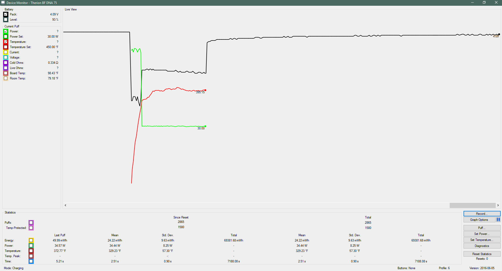

JamezC Posted October 21, 2016 Author Report Posted October 21, 2016 So, maybe a few weeks ago, I bought a Therion BF and I've been having issues with TC using SS 316L wire. Quite often, I'll be taking a drag, and then the power will drop off and I'll get the "temperature protected" error message. Other times, It'll cut off right at the beginning of a drag. Sometimes, It'll work fine for a day or two at most, and then it starts doing it again. I've done some googling and troubleshooting myself but have not found a solution to the problem. I've just been using it in power mode for the past day or so, and it's been working well, but I'd like to figure out how to use TC without getting that constant error message.I'm using a Stumpy RDA with dual 26g SS 316L coils, 2mm in diameter, spaced, coming out to 0.33 ohms. The connection is solid and the ohms are stable, so I've already ruled that out. I originally had the same coil configuration, but with contact coils, so I thought maybe TC was wonky with contact coils, but building spaced coils didn't seem to make a bit of difference.As for the other information:Power: 33WTemp: 450FPreheat power: 40WPreheat punch: 5Preheat time limit: 1sI'm running the latest firmware for the mod, and I'm also using Steam Engine's profile for SS 316L. I'd appreciate any help in figuring this out!

VapingBad Posted October 22, 2016 Report Posted October 22, 2016 You are not getting close to the temp limit you have set in that screen (450 F) and just vaping at 30 W, it could just be that the cold res had not refined when you got the message earlier. Refinement is a process where the board tracks the coil res against the board temp as the coil cools during idle to get a more accurate base resistance reading.

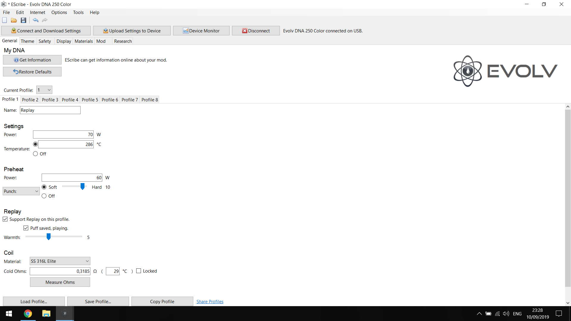

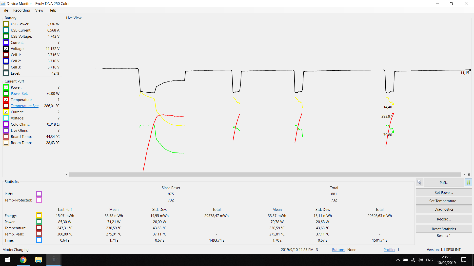

saschacolussi Posted September 11, 2019 Report Posted September 11, 2019 Still haven't tried the spaced coils, but here's what i was taking about. On the left the replay mode works just fine, on the 2nd puff it just stops working and on and on. Mod max output temp 315,5°C

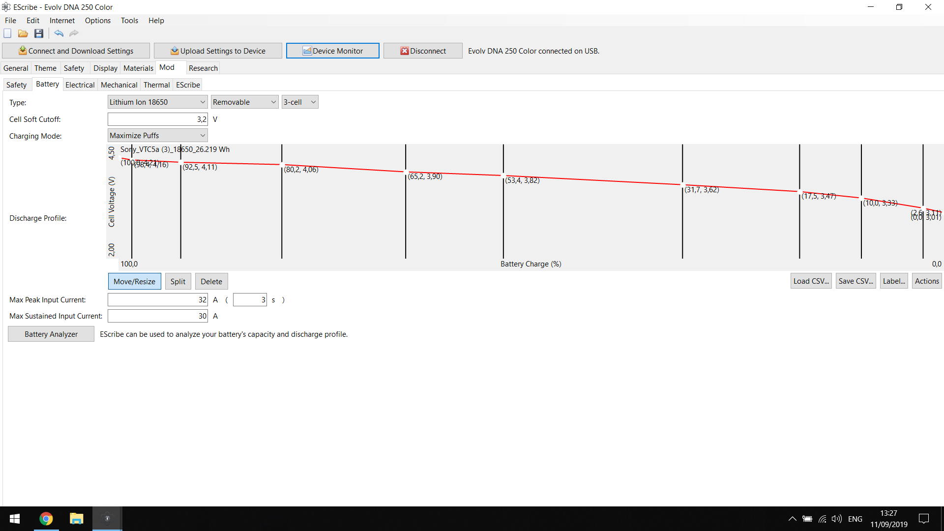

dwcraig1 Posted September 11, 2019 Report Posted September 11, 2019 With a live screen hoover your mouse on the batteries voltage drop and post what voltage it reads. Also post what your Cell Soft Cutoff is set to. Edit: I'm thinking that your voltage drop might be lower than your Cell Soft Cutoff.
saschacolussi Posted September 11, 2019 Report Posted September 11, 2019 Here's my battery cell cut off. I didn't manage to recreatethe situation above, but as soon as i get that i'll post it here, thanks for the help.

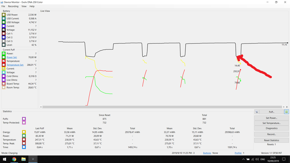

retird Posted September 11, 2019 Report Posted September 11, 2019 Your temp is set at 286C Your temp peak on the last puff shown is 300C.... 572F and if I'm seeing it right the power at 300C is almost 80 watts on your last puff shown but your set power at 70 watts.... What if you lower your preheat to 50 watts and the punch down to a much lower level? Could you be over driving your 70 watt setting with the preheat and punch being so high? Again.... contact coils are not usually used by most DNA users...
saschacolussi Posted September 11, 2019 Report Posted September 11, 2019 I tought i should do the opposite. Set the power to what i would usually use with the coil and set the preheat to something a little higher and punch around 10-11, so it would reach the temp 286C quicker
