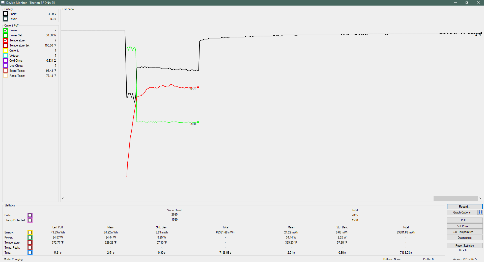

So, maybe a few weeks ago, I bought a Therion BF and I've been having issues with TC using SS 316L wire. Quite often, I'll be taking a drag, and then the power will drop off and I'll get the "temperature protected" error message. Other times, It'll cut off right at the beginning of a drag. Sometimes, It'll work fine for a day or two at most, and then it starts doing it again. I've done some googling and troubleshooting myself but have not found a solution to the problem. I've just been using it in power mode for the past day or so, and it's been working well, but I'd like to figure out how to use TC without getting that constant error message. I'm using a Stumpy RDA with dual 26g SS 316L coils, 2mm in diameter, spaced, coming out to 0.33 ohms. The connection is solid and the ohms are stable, so I've already ruled that out. I originally had the same coil configuration, but with contact coils, so I thought maybe TC was wonky with contact coils, but building spaced coils didn't seem to make a bit of difference. As for the other information: Power: 33W Temp: 450F Preheat power: 40W Preheat punch: 5 Preheat time limit: 1s I'm running the latest firmware for the mod, and I'm also using Steam Engine's profile for SS 316L. I'd appreciate any help in figuring this out!
