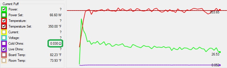

Neunerball Posted March 22, 2016 Author Report Posted March 22, 2016 I added a new material with the TCR 0.00088 in Escribe and created a new profile. Using the Device Monitor, while vaping on the Pure X1, it doesn't show the temperature curve, as I see with my SS316L coils. It seems, it's more like a power mode, rather than TC. However, it works nicely. Thanks again, for all the input!

Bobby Posted March 23, 2016 Report Posted March 23, 2016 There seems to be more to the Pure X2 technology of the Pioneer4you and YiHi mods than I initially thought.With a TCR of 0.000875 (=TCR of SS317 which is slightly less than SS316L) the relative resistance change is 0.0875% per degree C. No problem so far, but if the coil resistance @ room temperature is as low as 0.067 Ohm, the absolute resistance change is 0.0586 mOhm per degree C (= TC accuracy)I don't think the DNA200 (and other TC mods) can do true TC on coils with such a low TC accuracy (yet). Like with a SS316L coil of 0.064 Ohm (same TC accuracy), once the temperature setpoint is reached on this coil, TC will behave very erratic.
VapingBad Posted March 23, 2016 Report Posted March 23, 2016 Temp control is working fine for me with 0.03 ohm base res, and this is only a bog standard Rolo with dual 26 AWG Ni200 coils, preheat = 200 W punch = 11 t = 2 s. I know the TCR is x 6 so delta r is X 3 because the res is less than half, but I don't think a YiHi would regulate as smoothly as a DNA, not any of the SX350J family anyway. I just don't have anything with a TCR that low that I could build a 0.07 ohm coils from so this is the closest demo I can do.
