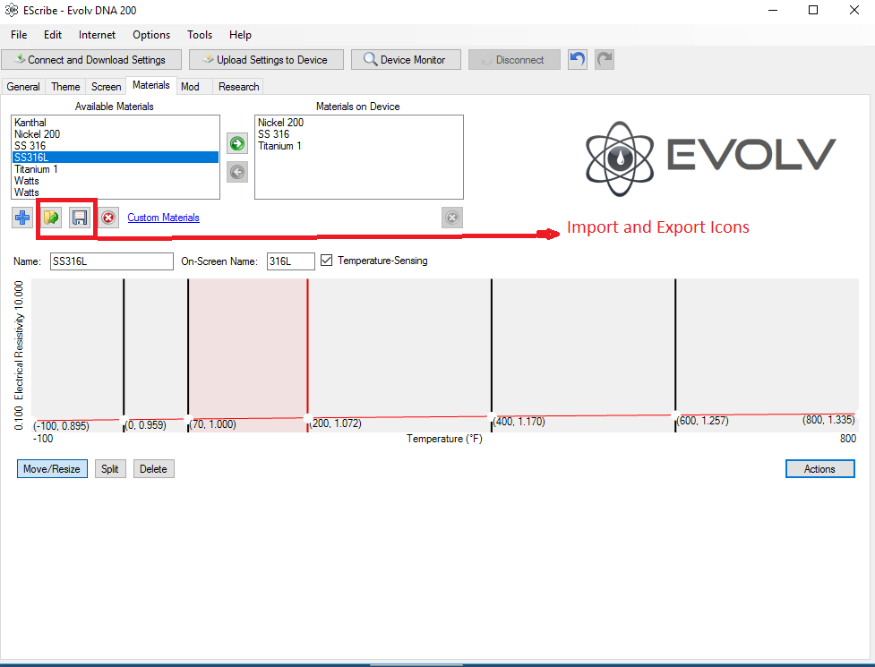

retird Posted October 26, 2016 Report Posted October 26, 2016 b1ame said:retirdDevice is LostVape Therion DNA133 (based on DNA200)I tried not to lock ohms - the same result.Where can I get profiles provided by Evolv?I'll post a screenshot a bit later, thank you!You can get the materials from Evolv EScribe: (you may already have them in the available material list)Open EScribe with no device connected.Click on EvolvDNA200. (under Edit New Settings)Go to Materials.Click on the desired material from the Available List.Select the "Export Material" Icon (below the Available Materials). Save to computer.With device connected to EScribe, then use the Import Material Icon below Available Materials to import the saved material(s). Add the Available Material to the Materials on Device and then build your profile in the General Tab as usual.

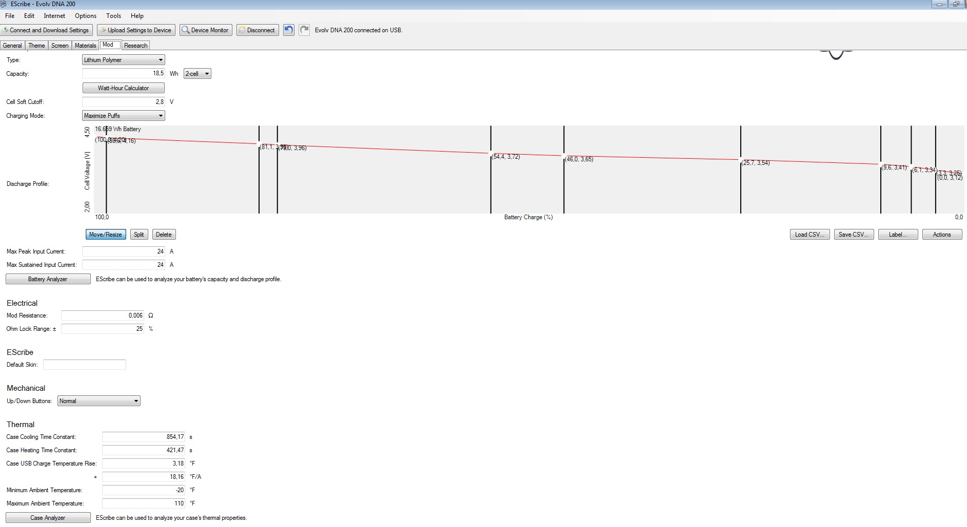

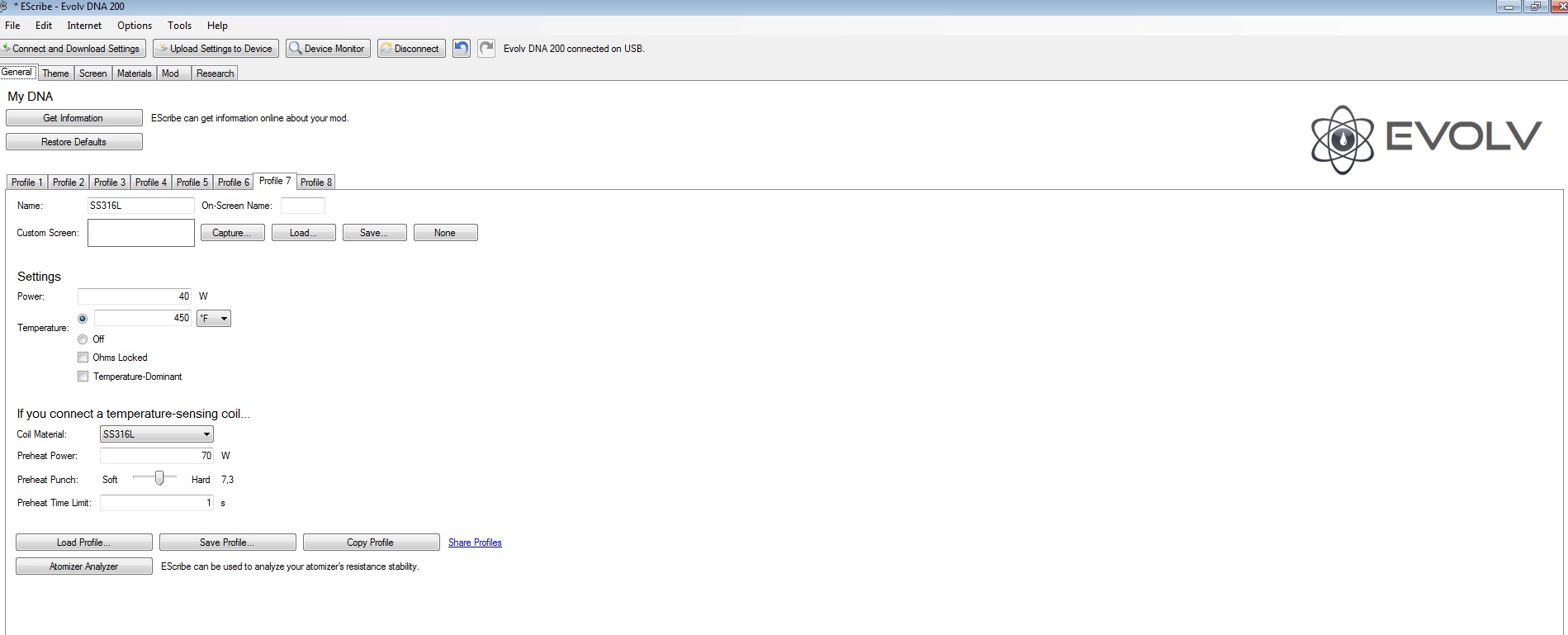

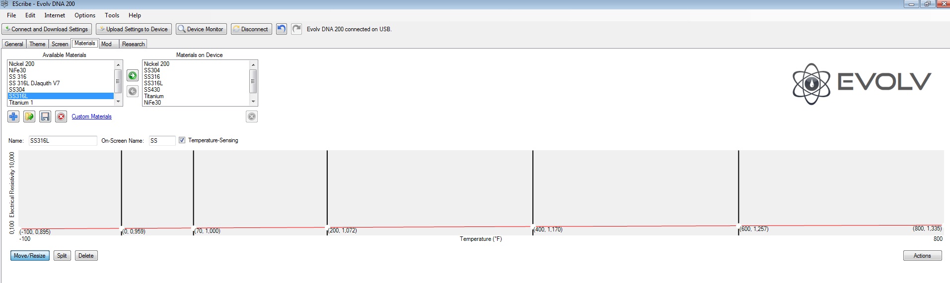

b1ame Posted October 27, 2016 Report Posted October 27, 2016 retird I already have SS316L in repository.. Even if the device is disconnected. This is Mod Settings (manufacturer's).(Not actually sure about battery type etc, because the mod uses 2 li-ion 18650 batteries (that's why they call it DNA133), but there is no option to choose li-ion type) This is SS316L profile:
retird Posted October 27, 2016 Report Posted October 27, 2016 THX for the screenshots.... I see nothing that jumps out to me except the coils you are using should be good at between 55 and 65 watts at between 450 and 530 degrees F. You might raise the preheat up to 100 watts and see if that helps. The coils I use are different specs than yours thus I can vape at lower wattage and temp but they are Aspire coils. I assume you have good wicking of the juice (not too thick).
