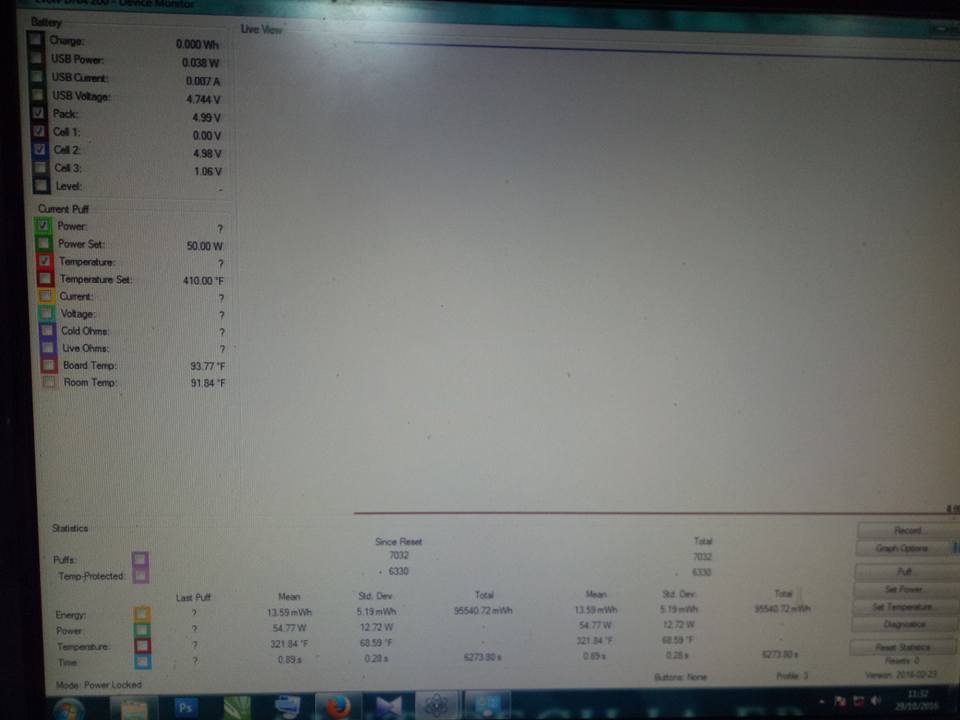

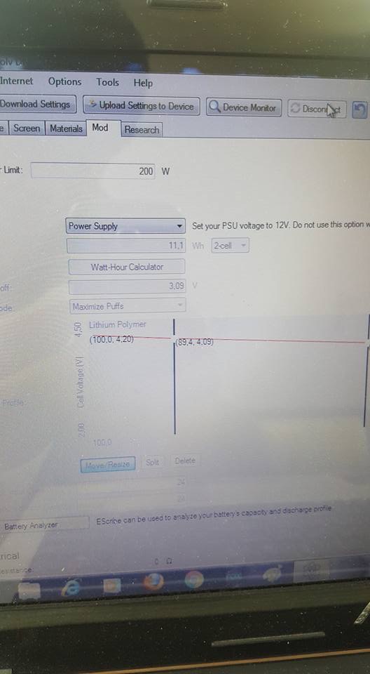

dparisan Posted October 29, 2016 Report Posted October 29, 2016 Hello, I have DNA 133, connected to escribe and detect that 1 0f my batteries are dead then i change the power source to Power Supply option on my escribe upload it again after that i unplugged the usb cable Then i found that that i still can firing for quite sometimes, even tough the battery indicator is empty⦠Why is that⦠TQ for the attention
VapingBad Posted October 29, 2016 Report Posted October 29, 2016 Power supply mode bypasses all the battery protection so don't use it with a battery other than for testing, but it looks like you have a wiring or connection problem with the balance connection I would try cleaning that first.

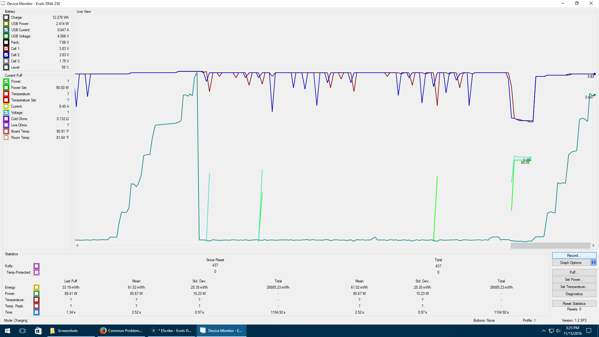

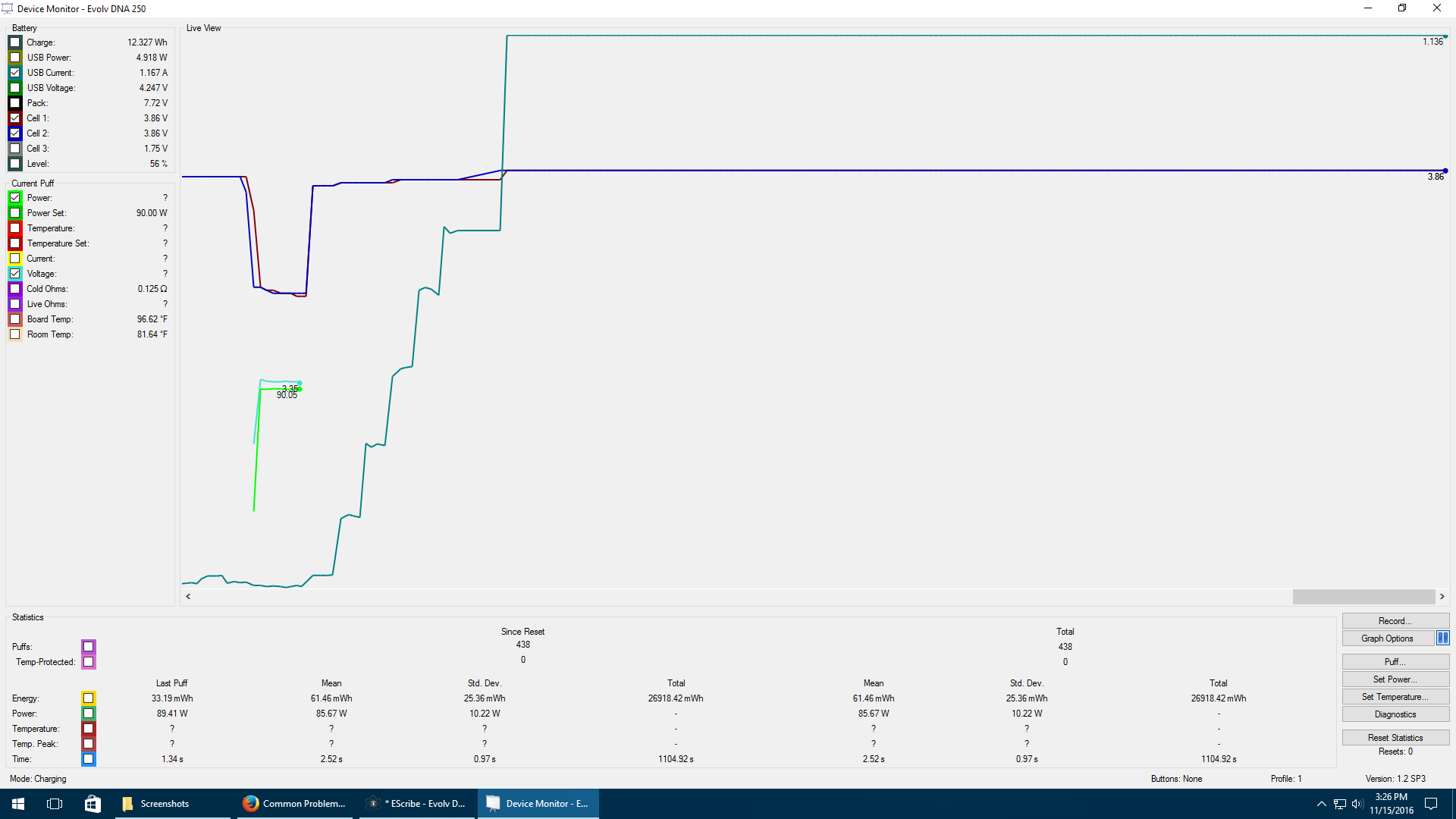

rbodnar217 Posted November 15, 2016 Report Posted November 15, 2016 I recently put together a dna 250 dual 18650. When I connect it to any type of charger or even device monitor the mod gives me a check battery error when I press the fire button. Maybe 1 out of 10 times it will fire when plugged in. It charges full 2 amps and works 100 percent otherwise. How can I fix it?
Spector NS5 RD Posted November 15, 2016 Report Posted November 15, 2016 rbodnar217 said:I recently put together a dna 250 dual 18650. When I connect it to any type of charger or even device monitor the mod gives me a check battery error when I press the fire button. Maybe 1 out of 10 times it will fire when plugged in. It charges full 2 amps and works 100 percent otherwise. How can I fix it? can you post a couple screenshots of device monitor, one trying to fire the device, another the mod sitting idle. make sure cell 1-2, pack, usb current and voltage boxes are ticked.
rbodnar217 Posted November 15, 2016 Report Posted November 15, 2016 I got one when the mod is just sitting charging and the other shows it trying to fire holding the button and a small part where it actually fired. I have tried different battery sets with no difference.
Spector NS5 RD Posted November 15, 2016 Report Posted November 15, 2016 rbodnar217 said:I got one when the mod is just sitting charging and the other shows it trying to fire holding the button and a small part where it actually fired. I have tried different battery sets with no difference. the phantom 1.75 volts on cell 3 looks strange, not sure if that's the problem or not. i noticed your running SP3 firmware on your device. there has been an update in the past week. SP5 is out now, why do you give that a try and get back to me.https://downloads.evolvapor.com/SetupES_1_2_SP5_ServicePack.exe
rbodnar217 Posted November 15, 2016 Report Posted November 15, 2016 ChunkyButt200 said:the phantom 1.75 volts on cell 3 looks strange, not sure if that's the problem or not. i noticed your running SP3 firmware on your device. there has been an update in the past week. SP5 is out now, why do you give that a try and get back to me.https://downloads.evolvapor.com/SetupES_1_2_SP5_ServicePack.exeOh wow I thought it would notify if something new was out and I had the newest! And bam problem seems to be gone instantly. Thank you very much for the help and quick response. And I found the 3rd cell to be weird as well. Maybe it was seeing it as an out of balance cell, long behold its gone.
