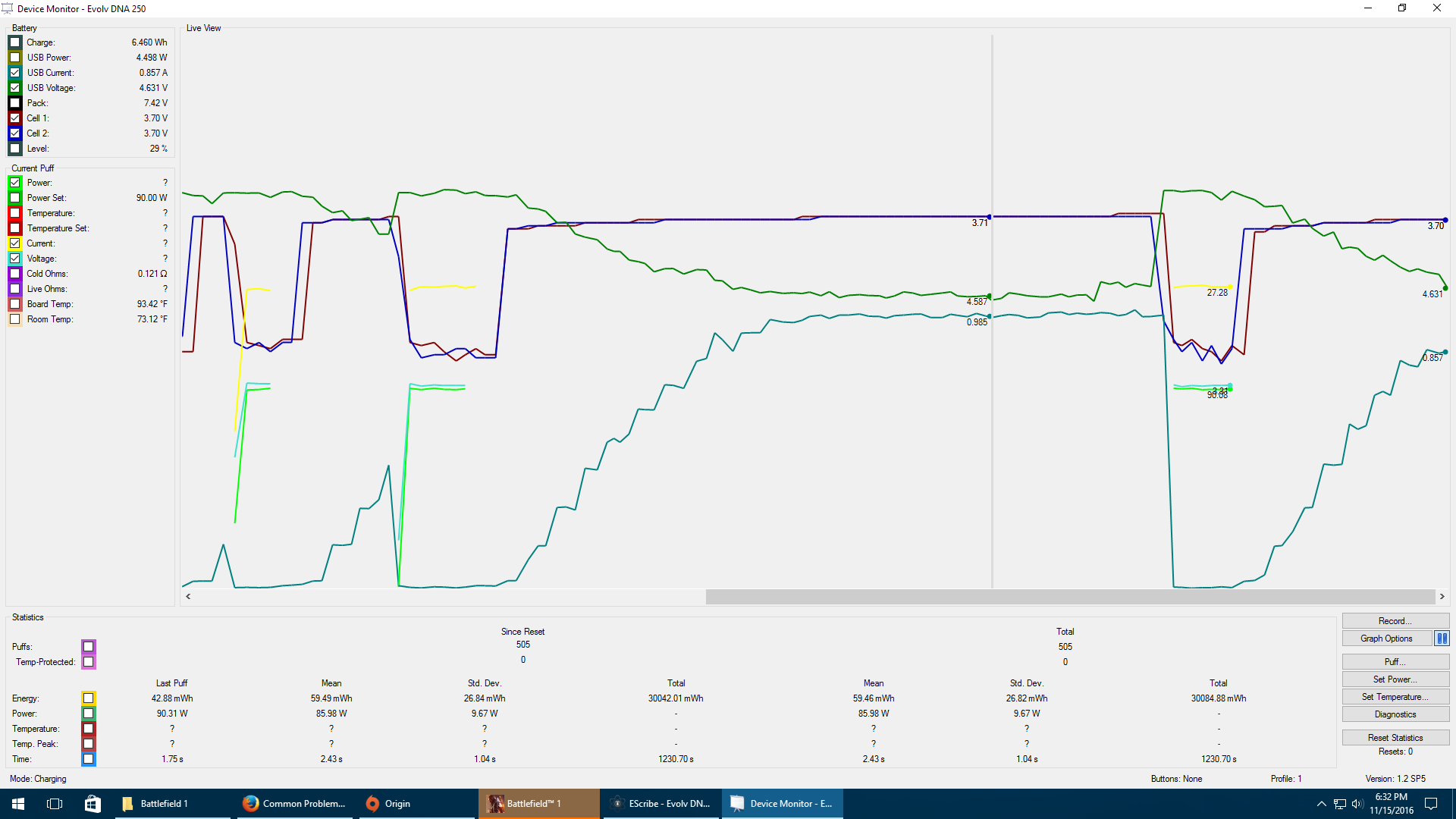

Oh wow I thought it would notify if something new was out and I had the newest! And bam problem seems to be gone instantly. Thank you very much for the help and quick response. And I found the 3rd cell to be weird as well. Maybe it was seeing it as an out of balance cell, long behold its gone.

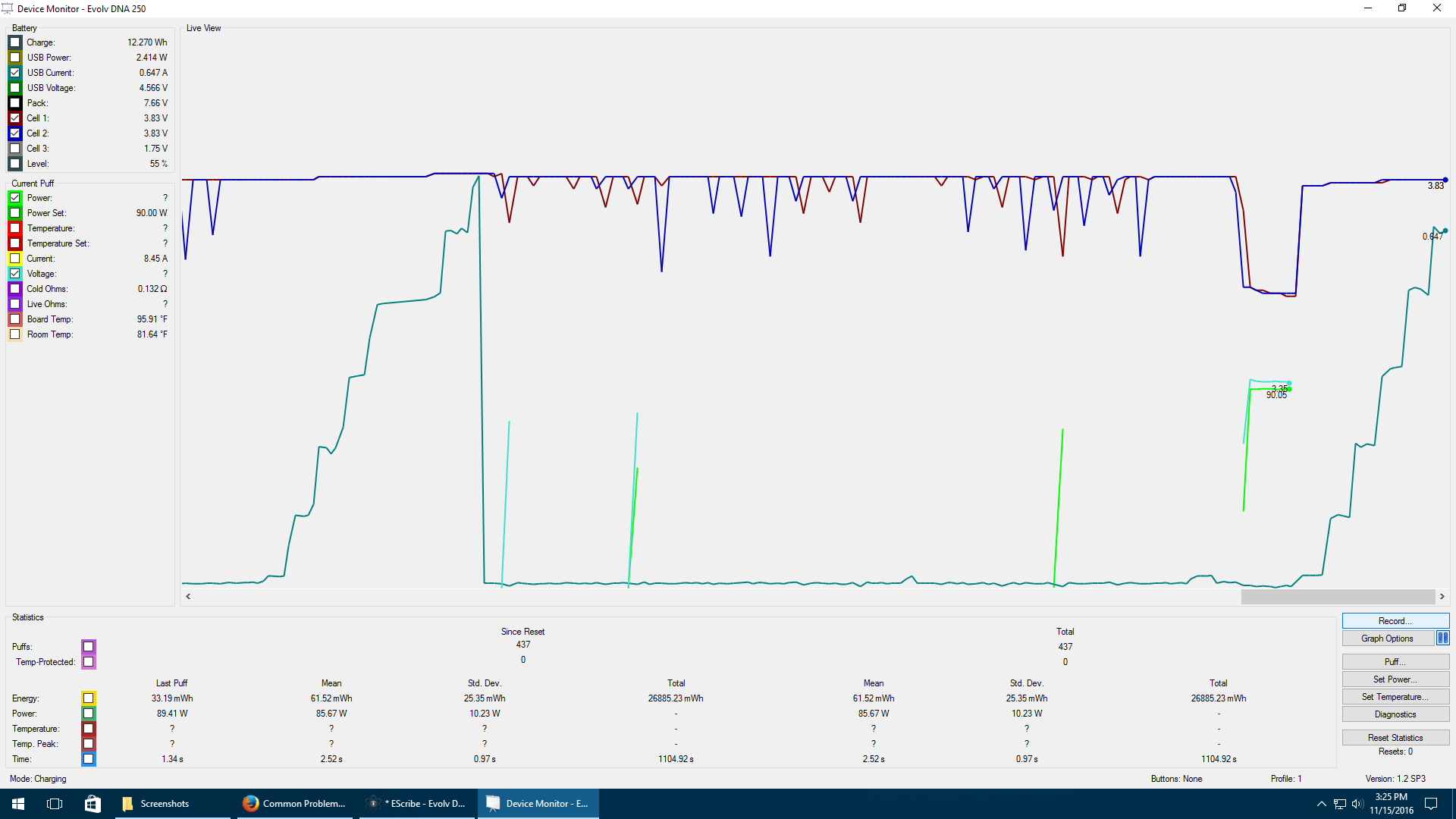

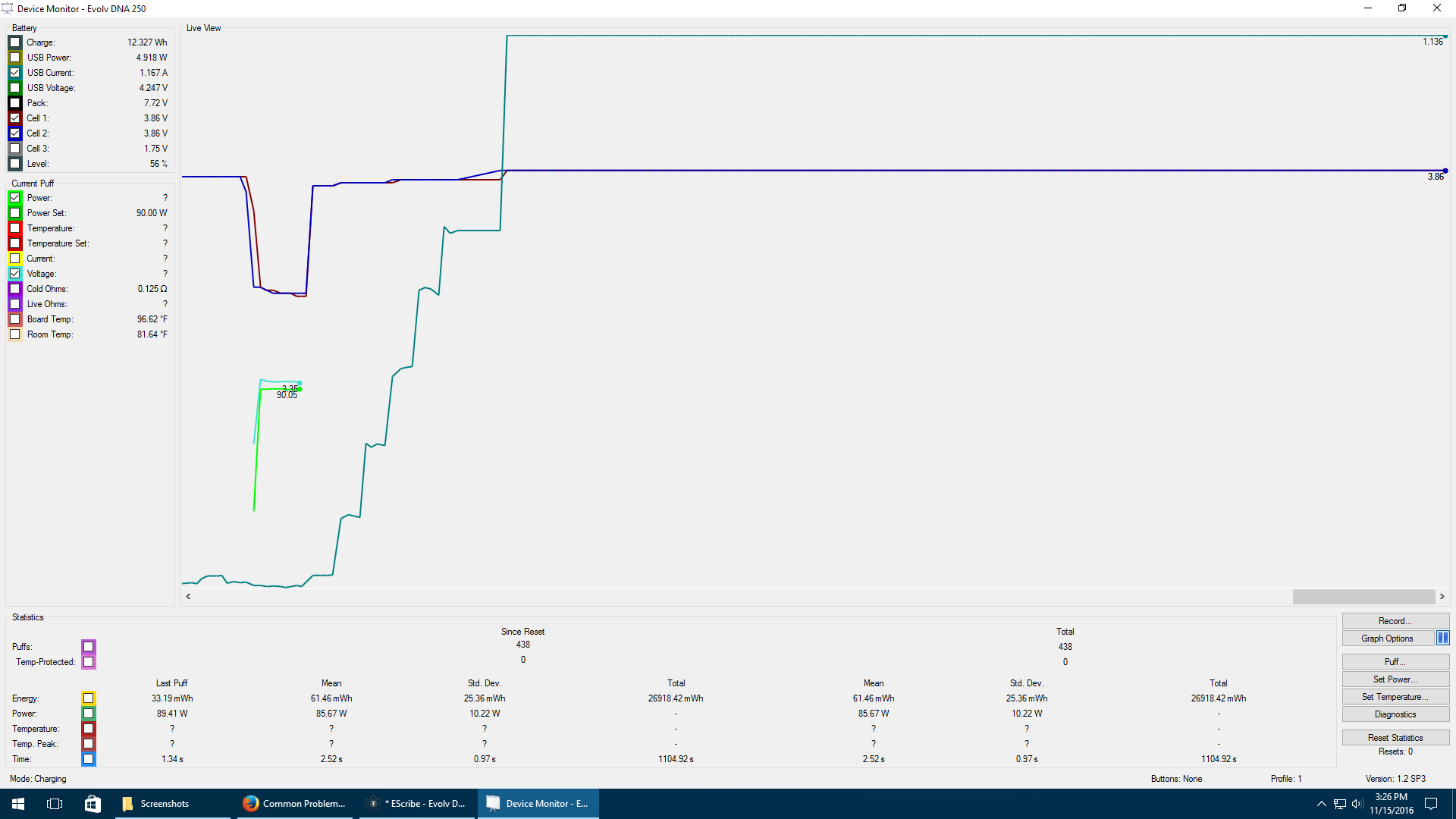

I got one when the mod is just sitting charging and the other shows it trying to fire holding the button and a small part where it actually fired. I have tried different battery sets with no difference.
I recently put together a dna 250 dual 18650. When I connect it to any type of charger or even device monitor the mod gives me a check battery error when I press the fire button. Maybe 1 out of 10 times it will fire when plugged in. It charges full 2 amps and works 100 percent otherwise. How can I fix it?
