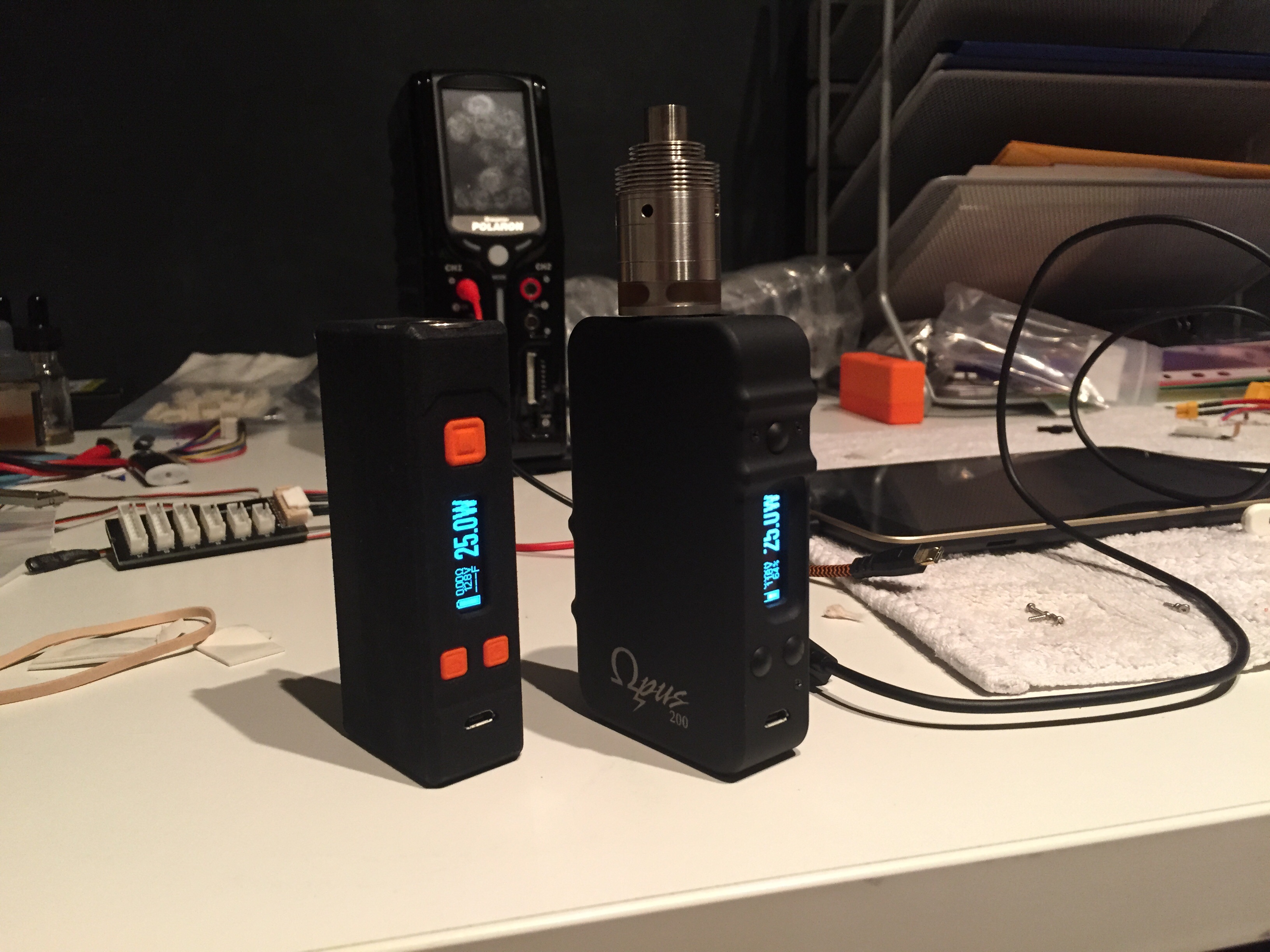

Wick Posted July 29, 2015 Report Posted July 29, 2015 FireBALL said:My take on a mod, as you can see it's a BOXER inspired design. It's off to Shapeways, let's see how good it turns out Good taste on clr combo... The orange seemed to easily get visually soiled and basically it's impossible to clean, so I swapped em out for the black buttons... But it did look pretty sick, and I did take crappy photo before I swapped them out...

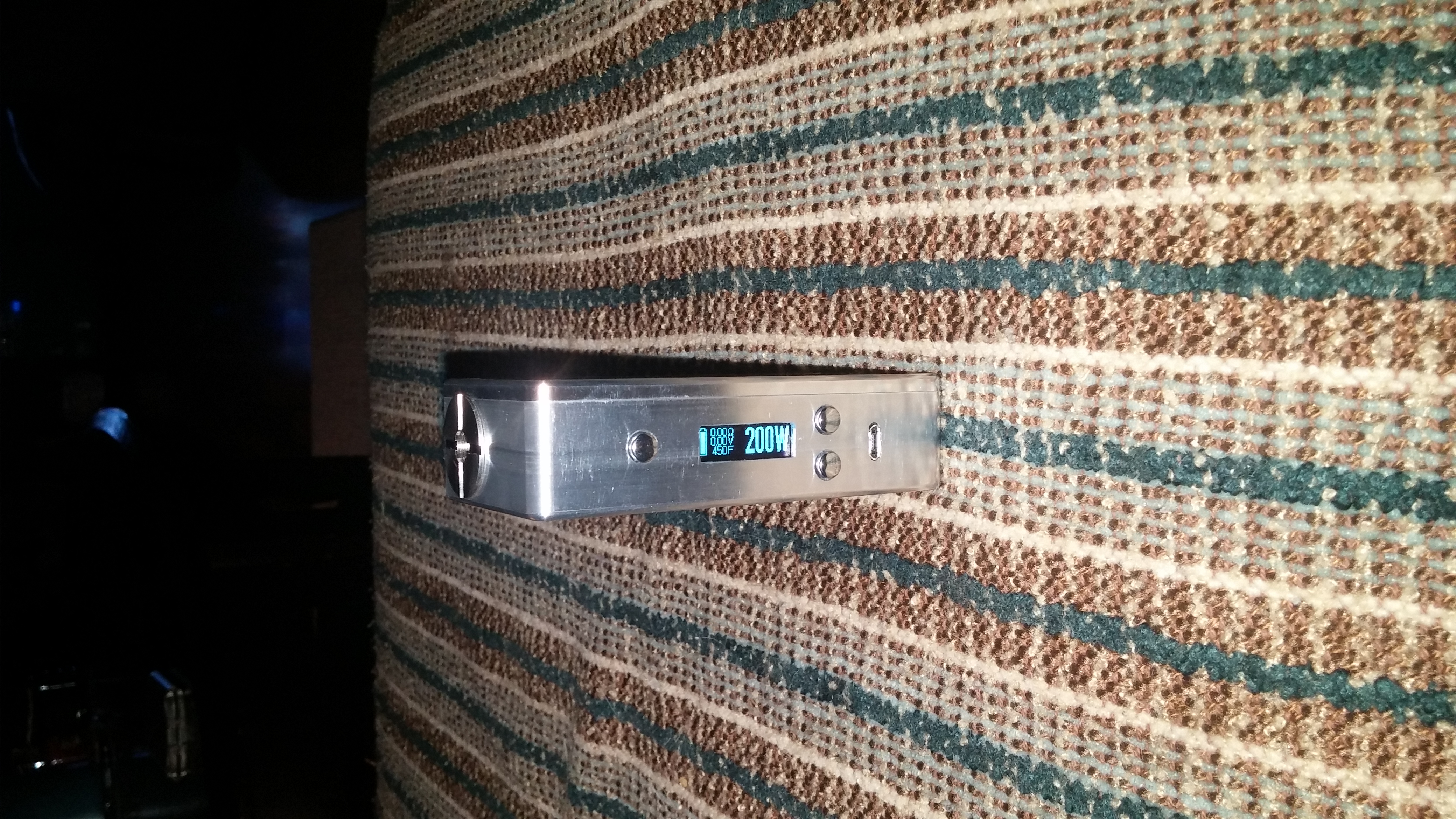

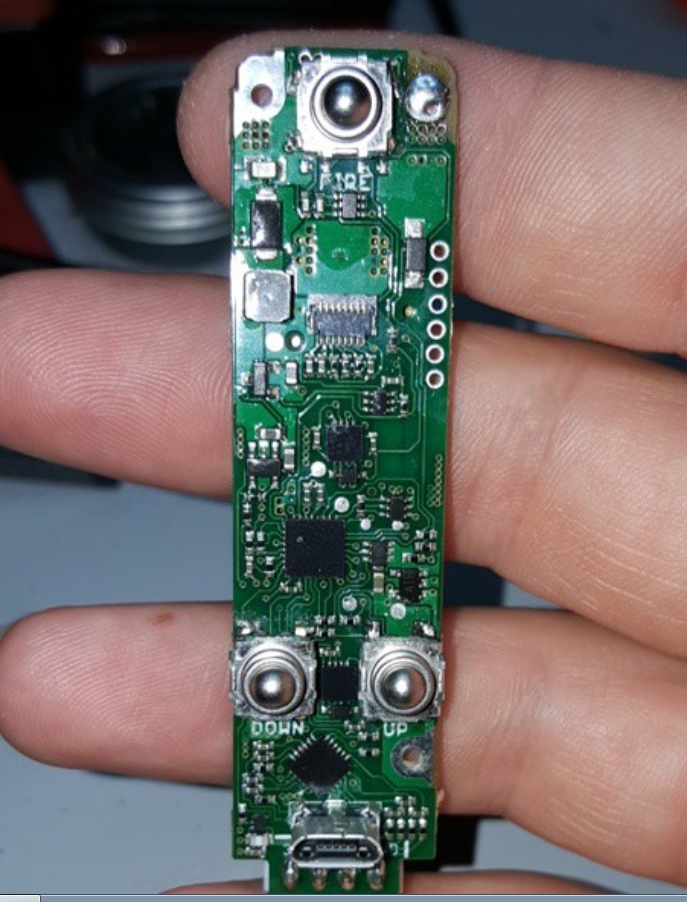

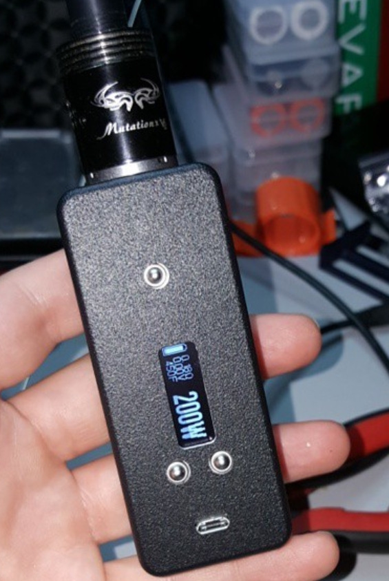

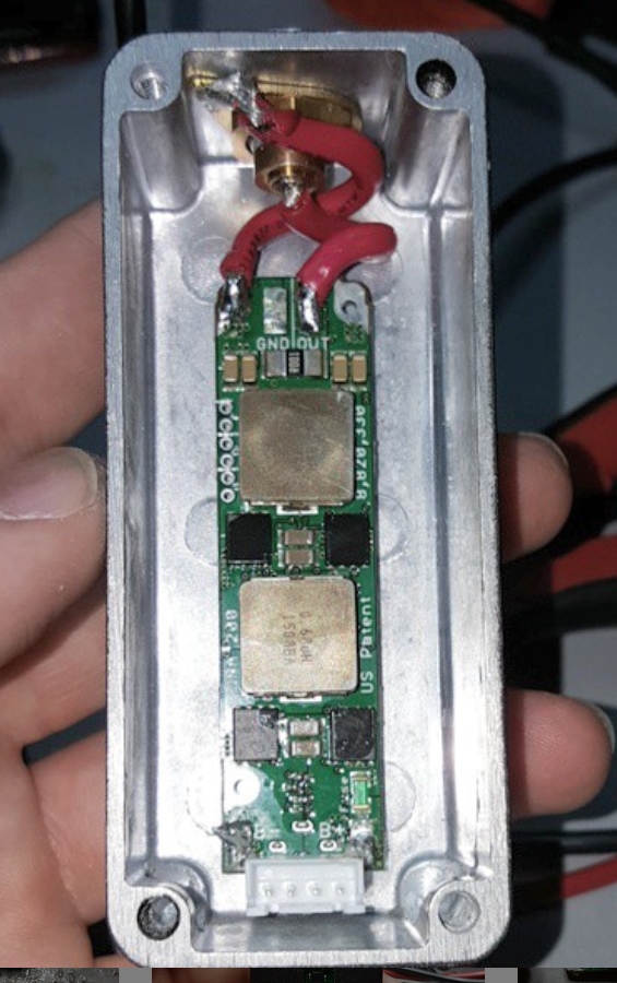

xevape Posted July 30, 2015 Report Posted July 30, 2015 I was not a fan of the onboard buttons....so I replaced them @XEVAPE

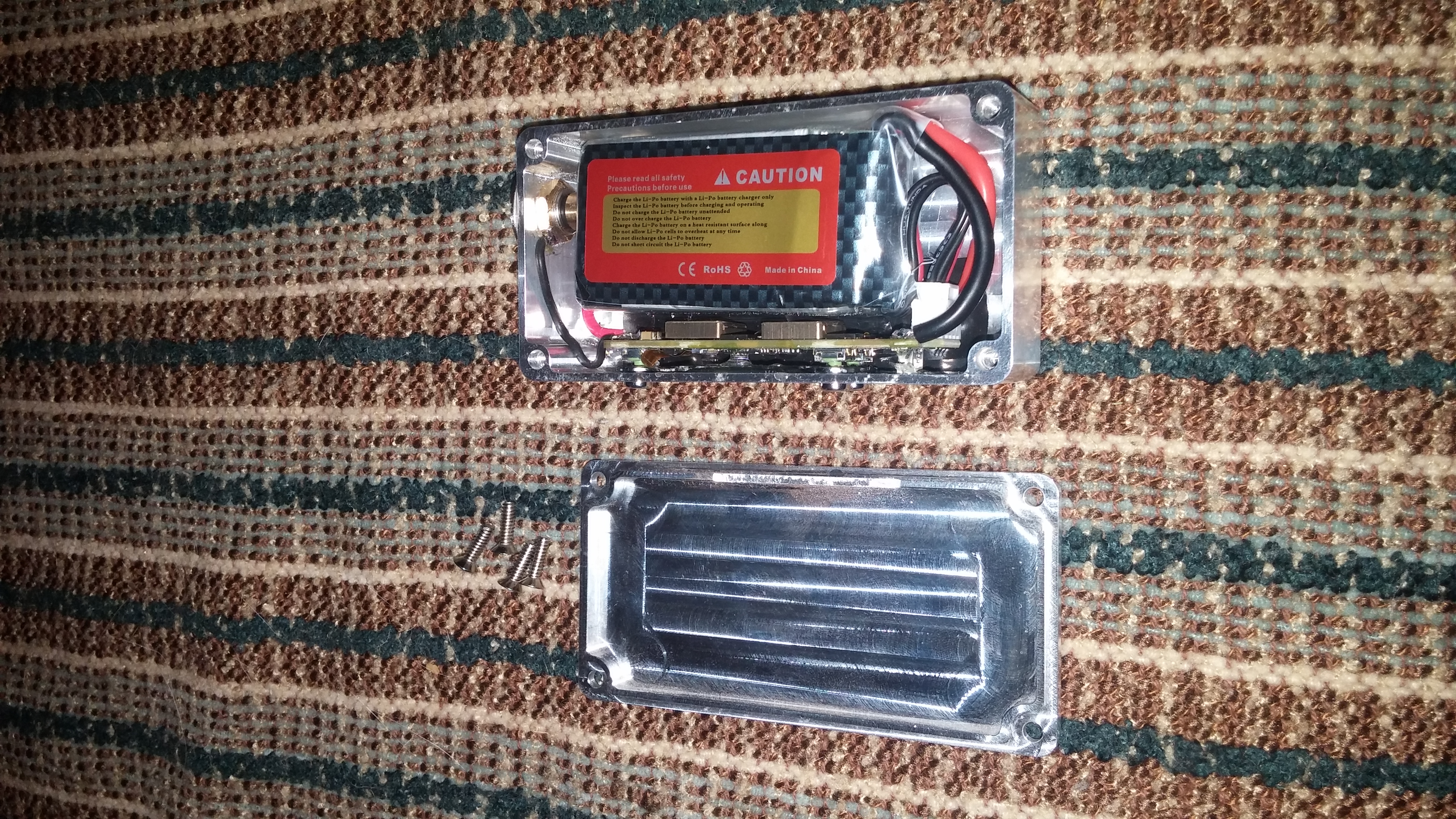

Always_Jonezen Posted July 30, 2015 Report Posted July 30, 2015 xevape said:I was not a fan of the onboard buttons....so I replaced them @XEVAPE Is that a Hammond 1590a? Man that is a tight fit. NICE WORK LOOKS GOOD. I'm fixing to start working on my 7th DNA200 and it will be in a 1590a I hope mine turns out that nice

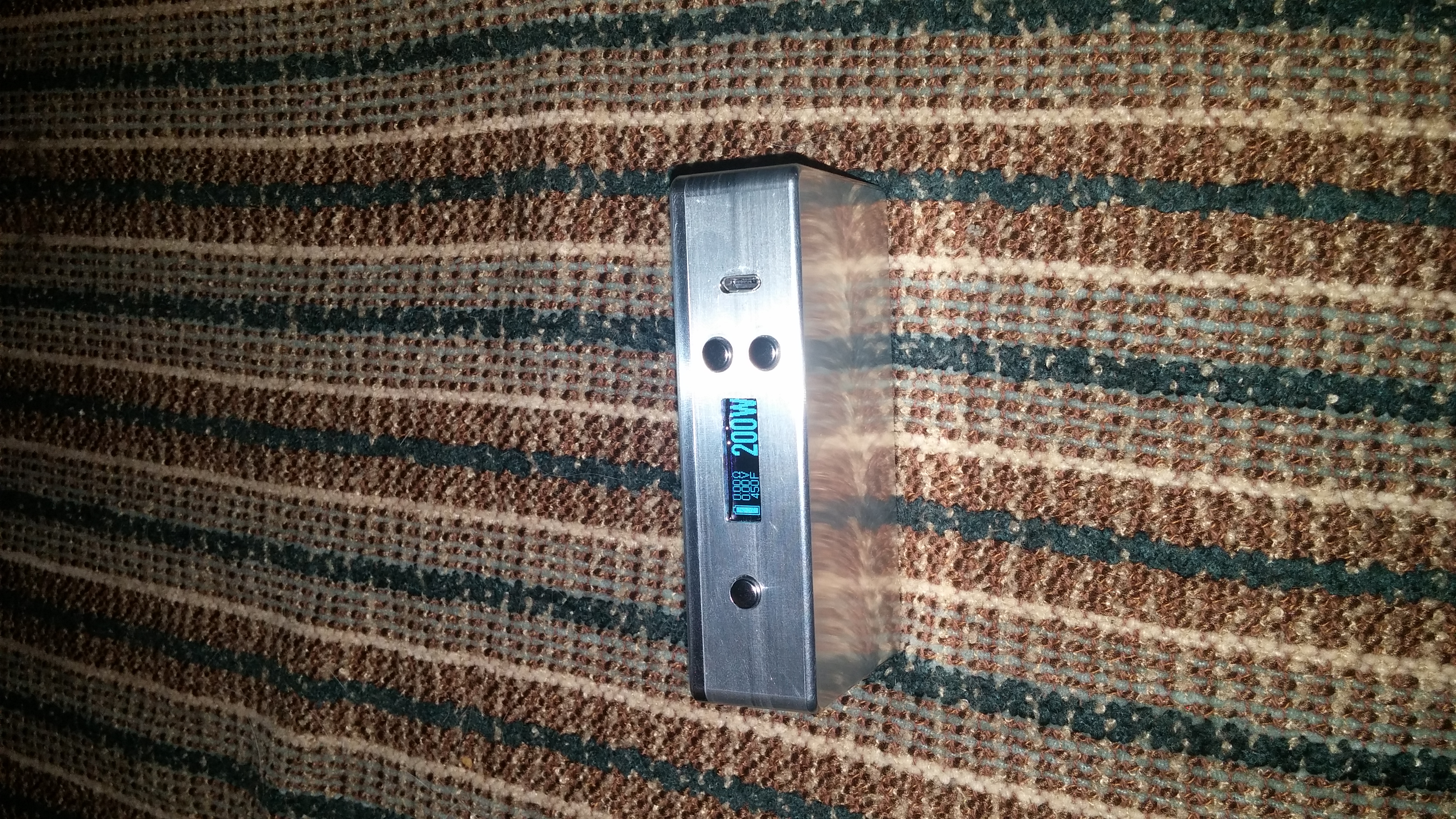

Always_Jonezen Posted July 30, 2015 Report Posted July 30, 2015 Here is 1 of the 5 of my latest creations
xevape Posted July 30, 2015 Report Posted July 30, 2015 Brandon said:How dare you!! Should have been designed with these buttons, just saying
xevape Posted July 30, 2015 Report Posted July 30, 2015 Always_Jonezen said:[QUOTE=xevape]I was not a fan of the onboard buttons....so I replaced them @XEVAPE Is that a Hammond 1590a? Man that is a tight fit. NICE WORK LOOKS GOOD. I'm fixing to start working on my 7th DNA200 and it will be in a 1590a I hope mine turns out that nice [/QUOTE]The top of the case does not fit, yet. I'm going to mill out the edges tomorrow at work and hopefully it does after. Also the 510 pushs against the lipo so I'm going to have to figure something out for that factor. However if you need small this is legitly the tightest fit you are going to get. The tact buttons make it so that the board fits flush and the Lipo holds it all in place. If I were to do it over again I would make certain that the lipo doesnt get in the way of the 510 however I, again, am going to try and do something about that tomorrow...Good luck and be careful.
xevape Posted July 30, 2015 Report Posted July 30, 2015 Brandon said:The audible clicks would drive me nuts. The clicks makes me feel more manly. I also took apart the original buttons and retrofitted the tact buttons to make them non audible clicks but that's a whole nother' story.

alee132 Posted July 30, 2015 Report Posted July 30, 2015 Wick said:Shapeways DNA200 Reference Case printed in blk. Just playing with plastic!!Just curious if you put a clear coat or anything on that print. Just from personal experience in the past I had my first shapeways printed mod in the dyed variety and I didn't put any coating on it. Eventually it started to show and I now put a matte clear coat on all my prints before assembly and they seem to hold up better for longer.
alee132 Posted July 30, 2015 Report Posted July 30, 2015 xevape said:I was not a fan of the onboard buttons....so I replaced them @XEVAPE Nice job on the switches! great job on fitting all that into a 1590a. I had to do some work to even make a 950mah fit. It doesn't look like the battery will fit with the lid on at all and if it does will it have any wiggle room for swelling at all?
alee132 Posted July 30, 2015 Report Posted July 30, 2015 xevape said:[QUOTE=Brandon]The audible clicks would drive me nuts. The clicks makes me feel more manly. I also took apart the original buttons and retrofitted the tact buttons to make them non audible clicks but that's a whole nother' story.[/QUOTE]Ya it looks like you kinda took the bottom of the original button and put the top of the KSJ buttons on.

Wick Posted July 30, 2015 Report Posted July 30, 2015 alee132 said:[QUOTE=Wick]Shapeways DNA200 Reference Case printed in blk. Just playing with plastic!!Just curious if you put a clear coat or anything on that print. Just from personal experience in the past I had my first shapeways printed mod in the dyed variety and I didn't put any coating on it. Eventually it started to show and I now put a matte clear coat on all my prints before assembly and they seem to hold up better for longer.[/QUOTE] No, but that is a great call.

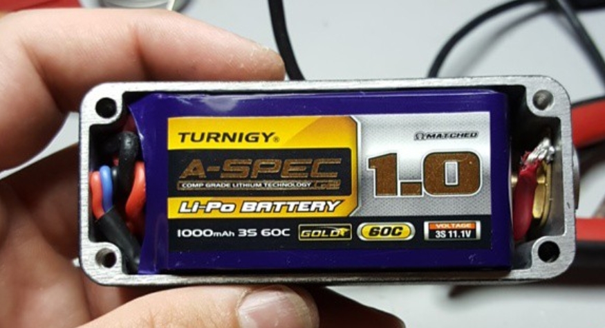

VapingBad Posted July 30, 2015 Report Posted July 30, 2015 I don't think the KSJ switches buy you any more room the limiting factor to how close to the case you can get the board is the USB socket and the outside face and on 1.6 mm thick case like a Hammond 1590A that leaves plenty of room for the on-board switches. 1590A with 950 mAh
Wick Posted July 30, 2015 Report Posted July 30, 2015 VapingBad said:I don't think the KSJ switches buy you any more room the limiting factor to how close to the case you can get the board is the USB socket and the outside face and on 1.6 mm thick case like a Hammond 1590A that leaves plenty of room for the on-board switches. 1590A with 950 mAh 100%... Unless it's the audible loud click your after, you can achieve the exact same look of the KSJ Series switches with machined ball nose actuators, allowing you an array of materials and finishes on them. It's been a while since I've looked at those switches but I'm confident in recalling that they did not compare mechanical cycle life wise to the last switches on Evolv's 40s (KSE Series), KSEs are rated for at least three fold the actuation cycles in comparable actuation forces. I would have to assume the new switches on the DNA200 to be rated similar or better than the KSEs of previous boards. Wick
xevape Posted July 30, 2015 Report Posted July 30, 2015 alee132 said:[QUOTE=xevape][QUOTE=Brandon]The audible clicks would drive me nuts. The clicks makes me feel more manly. I also took apart the original buttons and retrofitted the tact buttons to make them non audible clicks but that's a whole nother' story.[/QUOTE]Ya it looks like you kinda took the bottom of the original button and put the top of the KSJ buttons on.[/QUOTE]Nope these are soldered directly to the pcbhttps://instagram.com/p/5xDeB4AWCs/?taken-by=xevape
