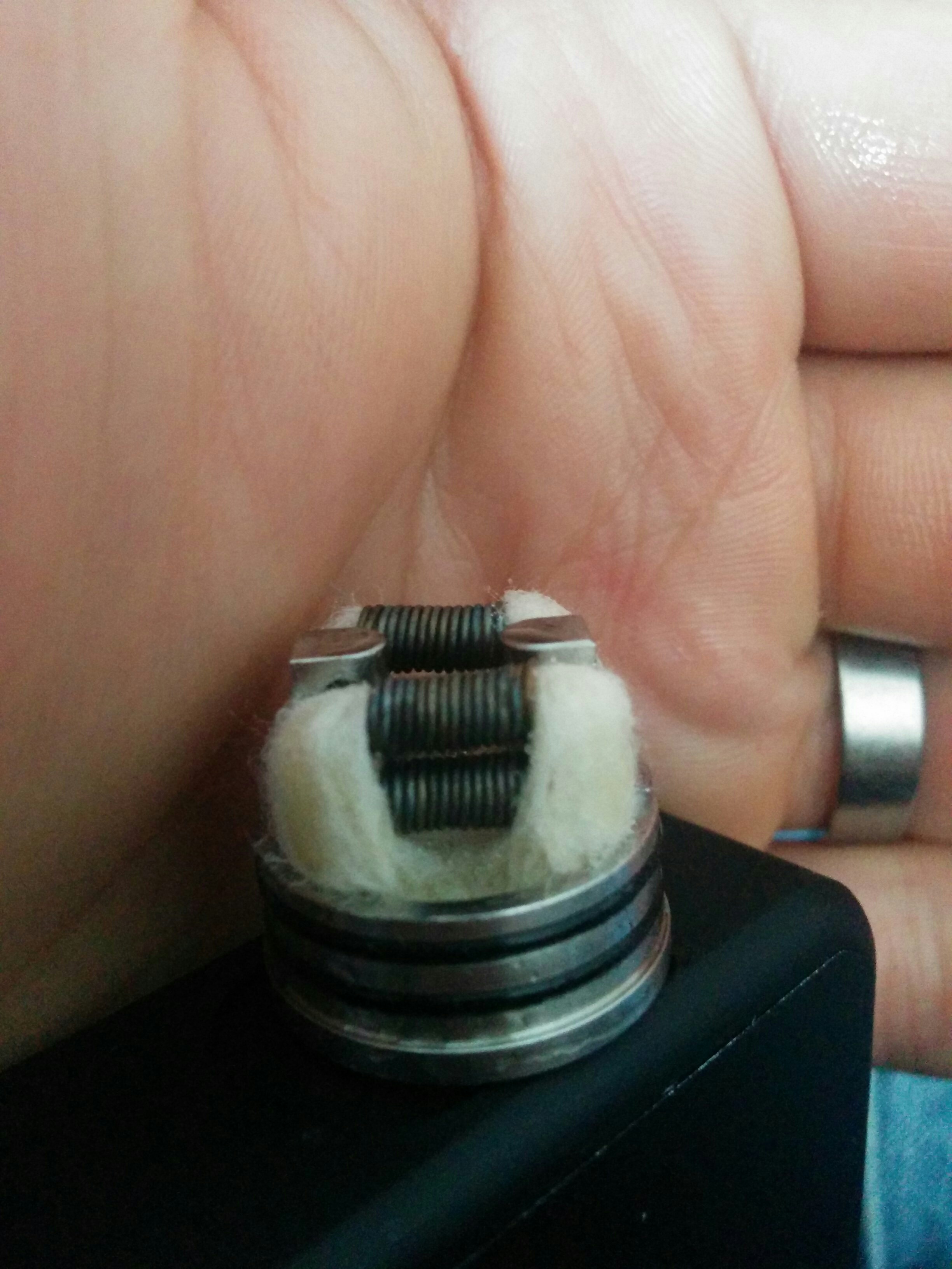

dwcraig1 Posted August 29, 2015 Report Posted August 29, 2015 Either the insulator on my Opus' 510 wasn't screwed in all the way or I forced it down with my Infinite Magma clone with it's extra long 510. I was having problems with changing resistance till I correcting it. Here's a picture of it prior to screwing it all the way back in. I then added a dab of Super Glue gel to keep it there. It didn't appear stripped so I'm not sure how it got that way.BTW, that glob of sealant you see here appears to be silicone that "they" used.

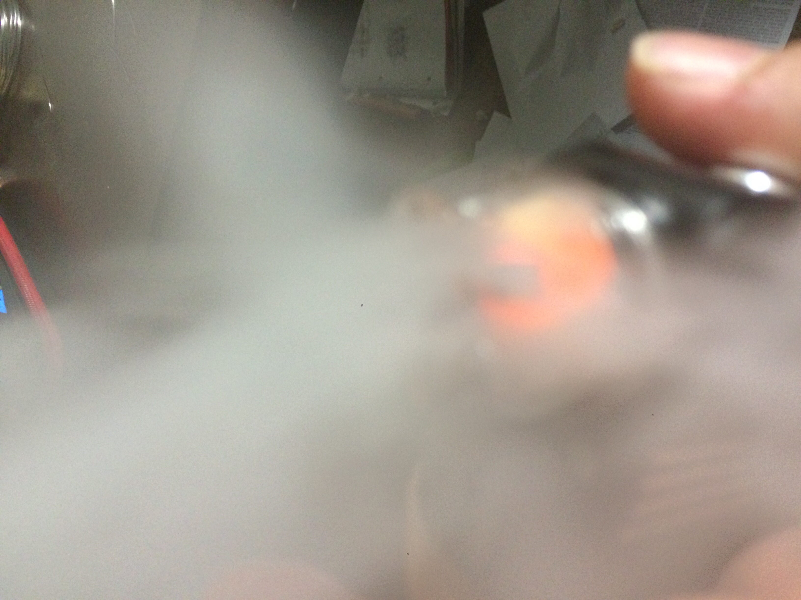

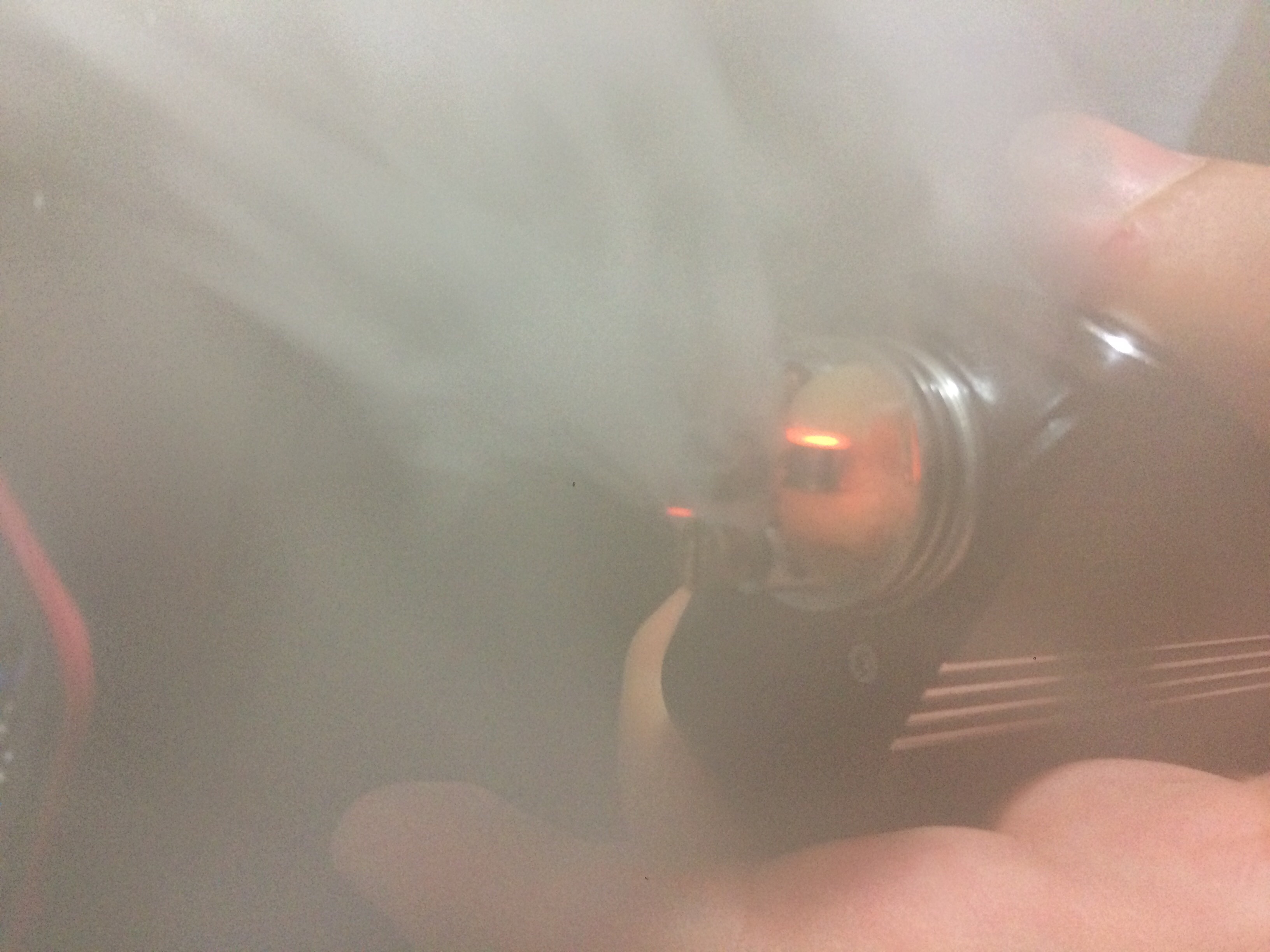

VapingBad Posted September 19, 2015 Report Posted September 19, 2015 You still have one loop getting much hotter than the rest on pic 2 so maybe your coil has some scope for improvement, sorry I can't post something more helpful as more of a hands on guy.
lexalove Posted September 19, 2015 Report Posted September 19, 2015 hersh83 said:So on the new setting I got longer time before temp protected but any long pulse and it's burnt and fires up??You need to throw that coil away!Anyone using Ti wire... do not under any circumstances allow the coil to glow orange/red and if for any reason it does throw it away immediately.When Ti glows it oxidises and Titanium dioxide is a known carcinogen which can cause lung damage.Looking at your picture I would guess your last coil is a slightly bigger diameter than the rest of the coil and not coming into full contact with your wicking material that's why it's getting hot. I've done the same thing on numerous occasions with Ti coils. I always put a 90 degree kink in the leg on one side of the coil so both coil legs come out on the same plane, I've had no issues since I've started doing that.
