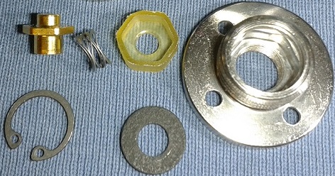

VapingBad Posted November 9, 2015 Report Posted November 9, 2015 scoopy said:Yea my black reference mods 510 doesn't sit flush neither but my original raw aluminium one did. So screwing that down further gave you less resistance? You will have to get a 1/2"x20 (1/2" UNF) thread tap and a pin wrench, adjustable with 4 mm pins.
VapingBad Posted November 9, 2015 Report Posted November 9, 2015 scoppyOne very important thing is you have to either take the centre pin out buy removing the circlip or disconnect the positive out when trying to turn the Evolv 510 or you will twist that wire and could rip the positive wire off the board.

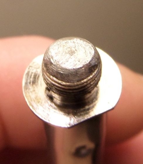

Willy Posted March 5, 2016 Report Posted March 5, 2016 Last year I bought the Fat Daddy Vapes 510 tool, about 1/4 way down on the page, right side --> http://www.fatdaddyvapes.com/shop.html Made of stainless, you get two of them for $5, I used them for checking my mods (as well as installing 510's), just take the jam nut off before checking the resistance to make sure you bottom out in the 510. FYI, I use a copper washer between the lock down/jam nut and a 510 when installing 510's so I don't mar up a 510. Also, they don't show in the pic, there is a hex machined in the top of the tool so you can use an allen wrench. I use them to install all my 510's including the Evolv's.ETA: Here's some more pics of the tool.

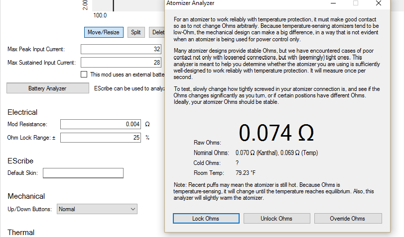

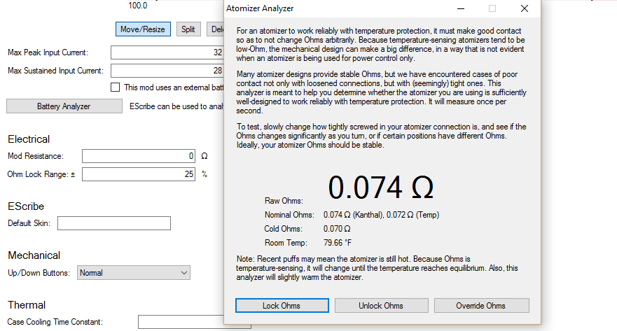

giz_60 Posted February 25, 2017 Report Posted February 25, 2017 You can try this..on the last 250 I bought, I too was having the ? when trying to obtain the mod resistance due to the wonky Atomizer Analyzer..took a build that I knew the ohms...ran the analyzer & subtracted..in this instance, the build was .07?...this may help you get a closer idea as to your mod resistance...of the 7 DNA devices I have, they range from .003 to .005 Just make sure that the coil is cold..
Wayneo Posted February 25, 2017 Report Posted February 25, 2017 Hot damn @giz_60, you da man. I'm gonna do this myself on my new 250.So, just to be clear .... we have 3 values to work with .... Raw Ohms, Nominal ohms (kanthal and Temp). And you're way was to set mod resistance to zero, then subtract 'raw ohms' from 'nominal ohms (kanthal).' So we really only have the atty resistance not accounted for.I wonder ... how does Evolv expect anyone to do this accurately now?
giz_60 Posted February 25, 2017 Report Posted February 25, 2017 Wayneo said:Hot damn @giz_60, you da man. I'm gonna do this myself on my new 250.So, just to be clear .... we have 3 values to work with .... Raw Ohms, Nominal ohms (kanthal and Temp). And you're way was to set mod resistance to zero, then subtract 'raw ohms' from 'nominal ohms (kanthal).' So we really only have the atty resistance not accounted for.I wonder ... how does Evolv expect anyone to do this accurately now?Ok..took me a minute to remember...old timers disease......Set mod resistance to 0...attach cold coil..turn watts or temp to lowest...quick fire to get mod to check cold ohms...run AA & subtract the cold ohms
