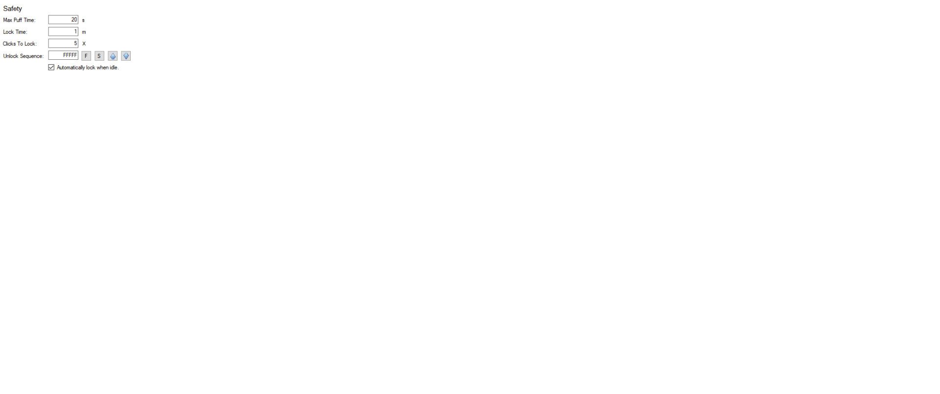

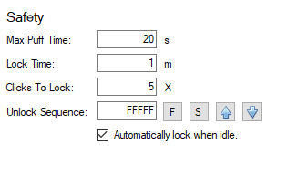

dwaindablane Posted May 7, 2017 Report Posted May 7, 2017 Is anyone else experiencing issues with the auto lock feature?When you un-check the box "Automatically lock when idle" in the general tab, it ignores the selection and continues to lock the device at the predefined time that had previously been set.

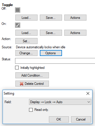

VapingBad Posted May 7, 2017 Report Posted May 7, 2017 dwaindablane said:Is anyone else experiencing issues with the auto lock feature?When you un-check the box "Automatically lock when idle" in the general tab, it ignores the selection and continues to lock the device at the predefined time that had previously been set.It's definitely working for me, check the toggle control source is Display\Lock\Auto-Lock and the on and off images are correct.
dwaindablane Posted May 7, 2017 Report Posted May 7, 2017 VapingBad said:It's definitely working for me, check the toggle control source is Display\Lock\Auto-Lock and the on and off images are correct. Hi VapingBad,Exactly where is this setting you have got your screen shot from, I don't see these options anywhere? BTW this is pretty much Evolv's default theme with a few changes.Cheers
VapingBad Posted May 7, 2017 Report Posted May 7, 2017 In theme designer \ screens then select the screen the lock is on on the rhs, then select the checkbox.
retird Posted May 7, 2017 Report Posted May 7, 2017 hum.... VB......I set the time out at 1 minute in the General Tab and checked Auto Lock on idle and uploaded.... Went to your theme and turned off Auto locked and it still locked at 1 minute.......Also set to 1 minute in General Tab and unchecked Auto and uploaded... still locked at 1 minute...What is the settings you set in the General Tab.... could there be a conflict???
dwaindablane Posted May 7, 2017 Report Posted May 7, 2017 I did notice that, but surely if I haven't put a 'Toggle' control on a screen to control that fuction, it just gets that setting from the main Escribe software, general tab. For me it just keeps locking the device after 1min and ignoring the check box. I have even reverted back to the Evolv default theme and still it happens, must be an issue.
giz_60 Posted May 7, 2017 Report Posted May 7, 2017 dwaindablane said:Is anyone else experiencing issues with the auto lock feature?When you un-check the box "Automatically lock when idle" in the general tab, it ignores the selection and continues to lock the device at the predefined time that had previously been set.Yup...same thing happening here as well...I caught that earlier on, but just kinda got used to it... Keeps locking no matter what you have it set for..either on the 'General' tab OR on the 'Lock' screen in the theme... 1
VapingBad Posted May 7, 2017 Report Posted May 7, 2017 I spose the general tab would over rule the setting, but I have been controlling it on the mod a lot lately, sometimes I have it a 5 mins sometimes 60 mins and sometimes off. I have just done a quick test setting to 1 min and checking it locked after a minute, then turning looked off and checking after 2 mins that it is unlocked, the second test failed, but connecting to EScribe it cleared the checkbox on the general tab and it is still clear on the mod. So it is looking like auto lock is not working, but I recall it working during the testing, for now I would max the lock time as a workaround.
retird Posted May 7, 2017 Report Posted May 7, 2017 Yep.... noticed this a while back and just set it to 240 minutes to lock.... workaround is just 5 click to lock/unlock for me....

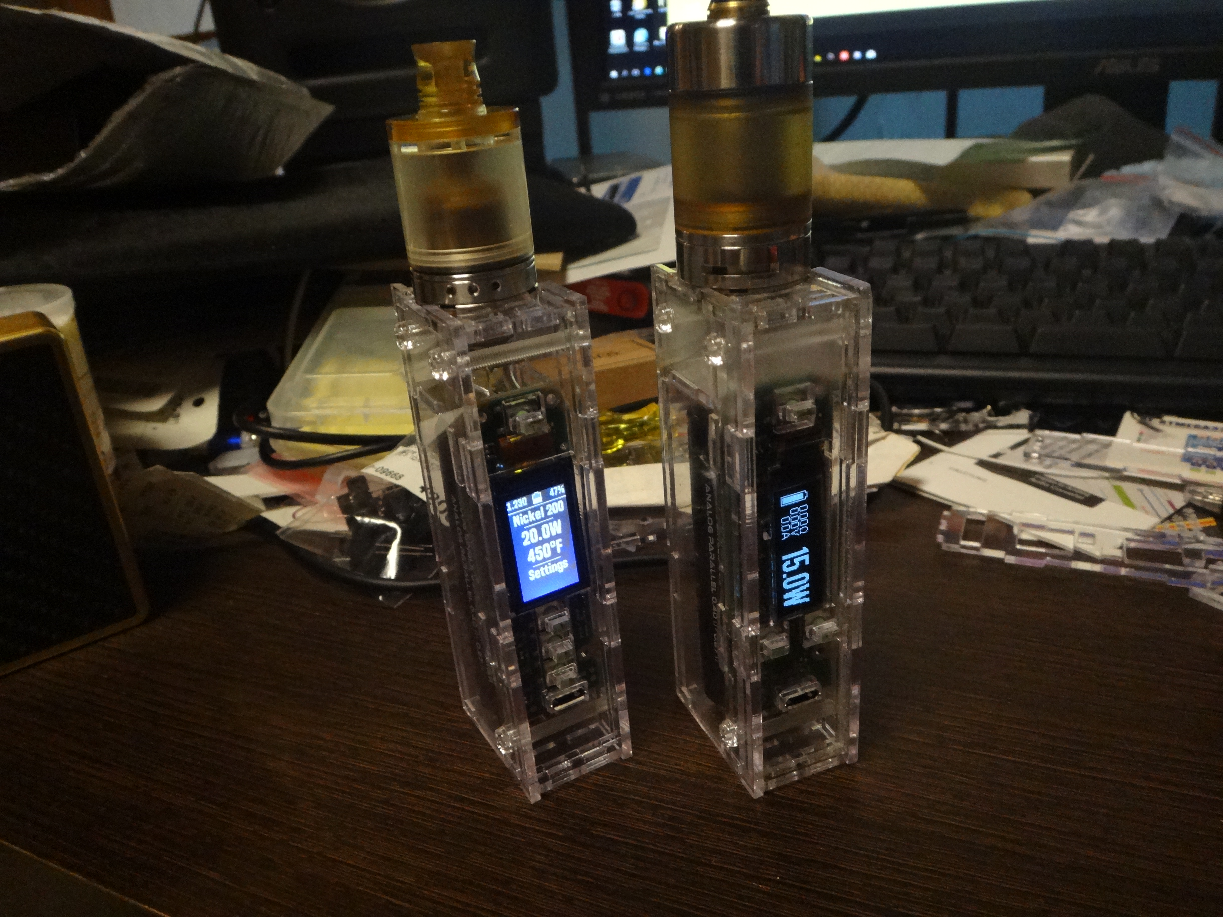

eucalyptus. Posted May 13, 2017 Report Posted May 13, 2017 Hello. DNA75C has arrived. I made MOD. Comparison with DNA 75 and summarized the points I noticed. If it is helpful. However, it is Japanese.http://ecig.eucaly.net/archives/15506415.html 6
