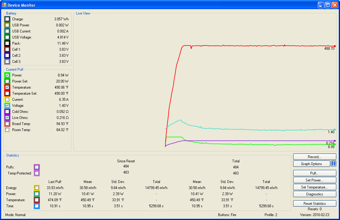

If you noticed, my SS316L coil does and acts the very same way as a Notch coil. I don't think it is the Notch coil, but SS in general. The DNA200 plus everything else I've used over compensates trying to adjust the temperature if the wattage is too high. Other wire types like nickel isn't a problem at all. Here is one of my nickel coils for an example. -

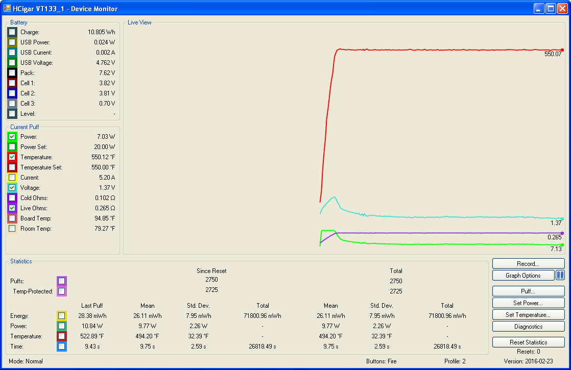

What does your Device Monitor show now? I switched to Power Dominant and regulating temp by the wattage instead of the temp. So it is like running SS in power mode except you have the extra TC benefits. I am MTL this SS316L and I set the preheat (I turn it off when using Temperature Dominant) to 20 watts for 1.5 seconds. And maxed out the punch. And this is how it looks now. -

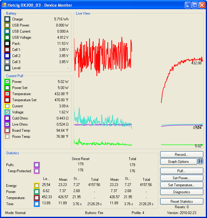

Yes it works like I thought it would. Here is a SS316L single coil set at 20 watts on the left. Changed it to 5 watts. See how it smooths out? -

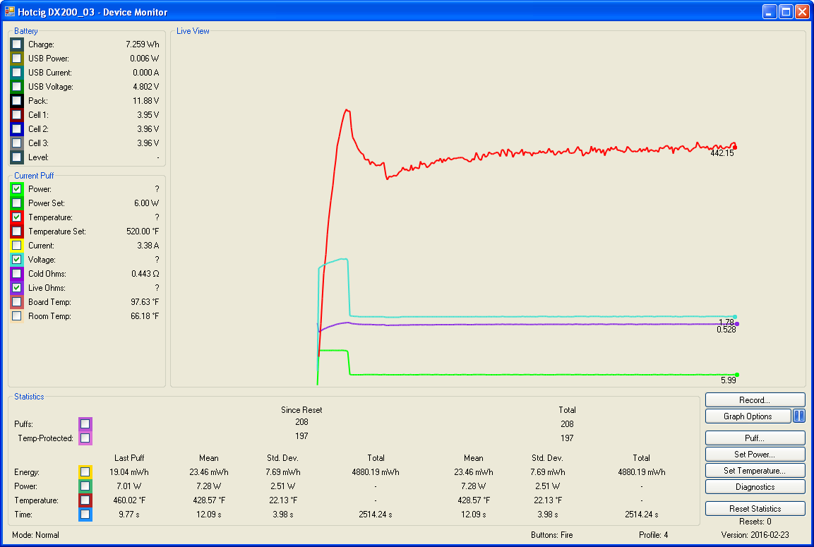

Yeah I am not a big fan of SS and I had a very bad experience from it with smell and taste I may go into later. But since the TCR value is so low for SS, the resistance changes far less in regards to temperature than other TC types. Although I just got an idea and I think if the wattage is set slightly too low, it might smooth out. -
