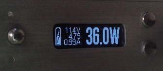

  9. It takes a short time to go into idle after you plug in the USB lead for them to display, I have Pack V, Wh & USB current.

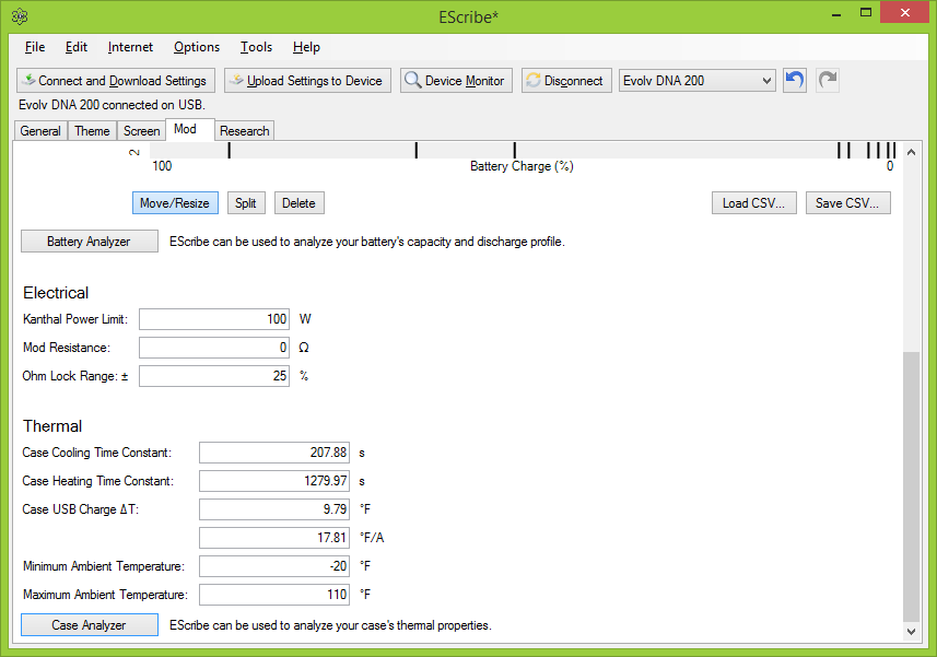

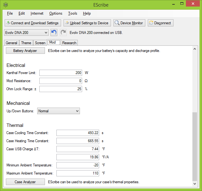

  20. I was meaning the cooling and heating time constants were different, I am not worried about and just posted as the topic came up.
  21. I have so many computers in here I struggle to get the temp below 28 C at this time of year and both time I have run case analyser it spends the first hour waiting for the temperature to drop, I got quite different results each time, but the were different ambient and doff versions of escribe.
