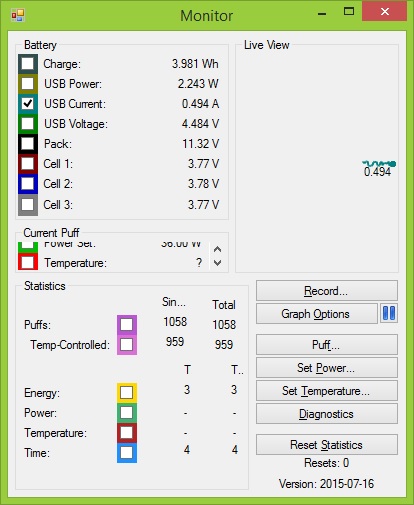

USB-Charge at 0.09A early firmware SetupES_2015-07-16.exe
