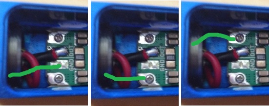

  14. I think that that is the USB chip/driver on the PC and not the DNA that limits the current when data handshake is present.
  15. Well this is where the wire would go, but wouldn't like to say how to attach it well to the 510.
