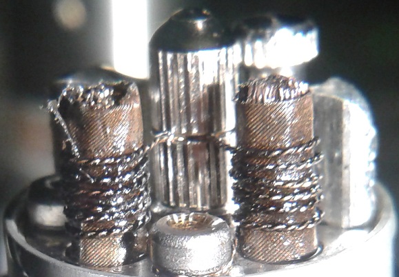

  2. I love high up horizontal builds in the Aromamizer, just using the top connections with 2 mm coil, there are no legs to get hot, rewicking is super super easy and flavour is superb, the wicks limit the airflow to a slowish lung inhale which is perfect for me. This is triple twisted 0.2 mm (32 AWG) Ni200, 0.4 mm Ti or NiFe like this works great to.

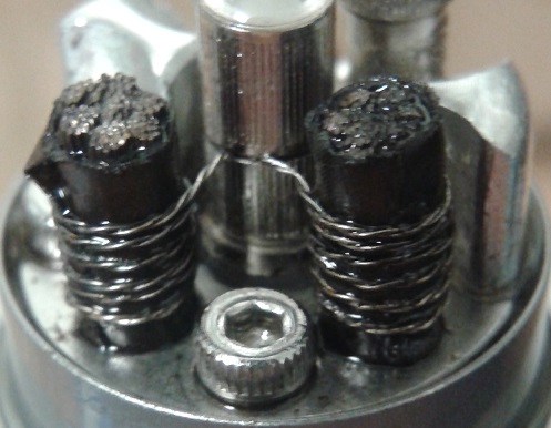

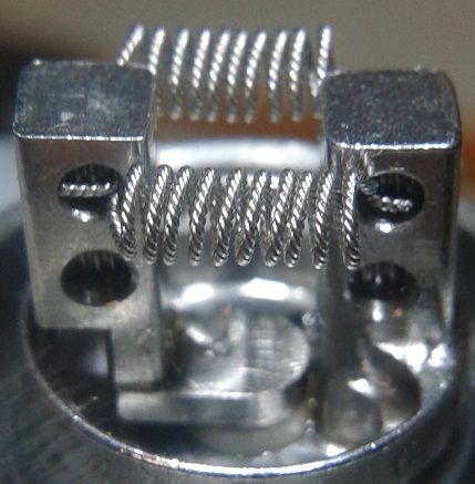

  6. I'm not understanding what u mean about "power double with ss wicks in gennies"[/QUOTE] Double the value I set for watts, so running the genny at 40 W I would typically start with 80 W preheat as you have to be more careful the high currents with dual Ni coils can cause arching to the steel wick, but as the wicks age I can go higher and often get to 3 times.[/QUOTE] What's a Genny?[/QUOTE] Stainless steel rope wicks with stainless steel mesh covering, this is 0.16 mm (34 AWG) Ni200 so with very high current if there is any short through the wick you will pop the coils before you see the problem. And with thicker wire the current can cause an electrical arch to the wick can burn a hole in it or weld to it. Fantastic vape, especially with ribbon Ni200, but the only situation I have found where high preheat can be a problem.

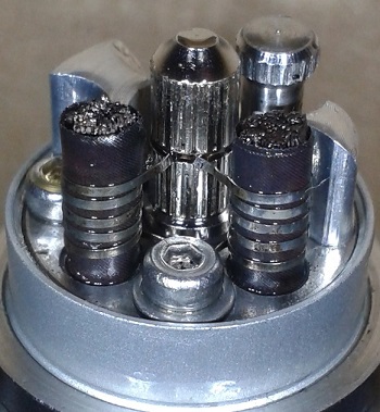

  15. Everything seems to work fine in my first 15 mins, loving the temp increment and material screen field.
  16. Viruk StealthVape.co.uk do quality grade 1 Ti in the UK, I prefer their NiFe30 myself, choose rebuildable supplies shipping and look around the site there are a couple of freebies you can add to your order.

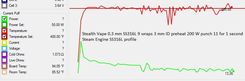

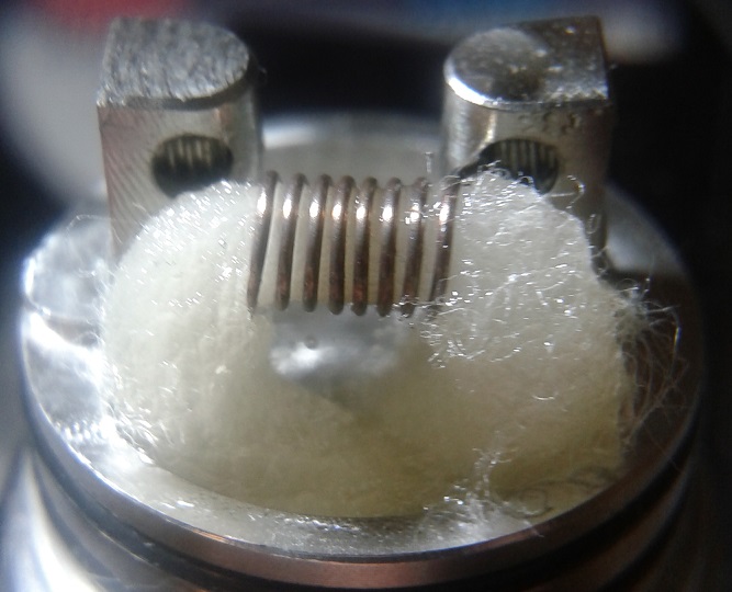

  19. Opps you wanted more res BRD, I'm dyslexic sorry, the first one was over 0.5 ohm, but I just wanted to show the DNA 200 can regulate 26 AWG Stainless Steel.

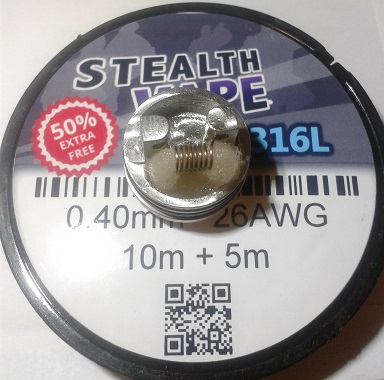

  20. Reduced the res (removed 2 wraps) upped the temp 40 F as this build is a bit lost in a Velocity

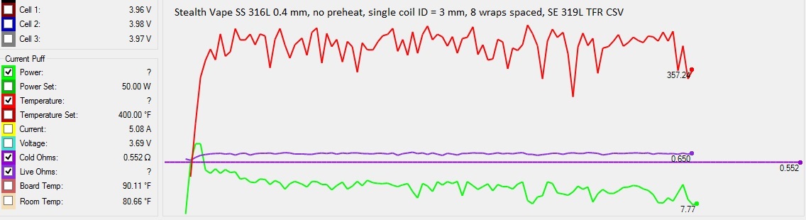

  21. Got my wire from Stealth Vape and only have time for a quick test right now so I used the thickest 0.4 mm and it is regulating temperature, not as smoothly as higher TCR wires, but it is doing it especially protecting against high temp. (time base 10 seconds)
  22. Steam Engine quotes the TCR as 0.000879 but the materials profile will be more accurate http://www.steam-engine.org/wirewiz.asp just select the wire type, choose DNA200 in hte results section then click "Download TFR table as CSV". Then in EScribe chose custom wire type in a profile and load that file it worked well fro me with 0.29 mm ss317L.
