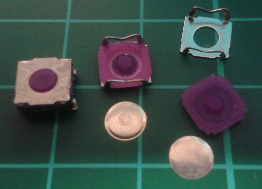

  7. If it uses the onboard button it could be the board mount screws were loose so the the board is a little further away from the button actuator. You can also lift the top of the button off and clean the inside ans the disk, sometimes this revives a problem button, this is a DNA 40 button, but the 250 one comes apart the same way.

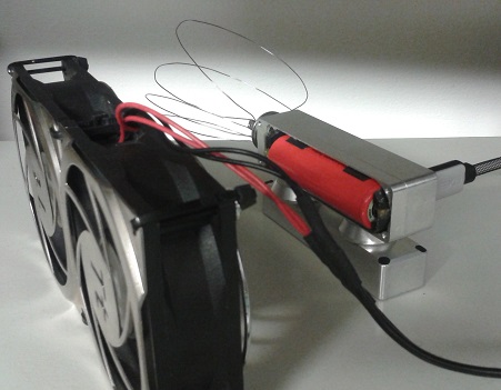

  13. It depends on the power level, but with a 75 I get away with 4 parallel loops of 0.5 mm about the radius of a tennis ball, they don't get too hot the heat sinking back into the case is more an issue and I use an old computer fan that keeps the case & battery cool but it is not essential. This is what I used to do custom battery test, I just use a single 3" fan now.
