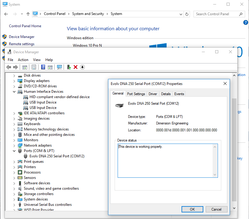

Two DNSA 250 boards will not connect to escribe
VapingBad replied to RCM Vapes's topic in EScribe, Software and Firmware
The 250s need battery power to connect IIRC, sorry I have not got a board handy to double check, but you can power via crocodile clips to check as it is only tiny current when not vaping. Edit: Just took the batteries out of my VTC167 and it will connect, I have a feeling older fw will not, but that may be from the beta group, try powering the board, different cables and rebooting your PC. Otherwise the boards may have issues, but that is extremely like for 2 boards. -

Does the computer make a noise when you connect them and do they show up in Windows Device Manager under Ports (COM & LPT)?
