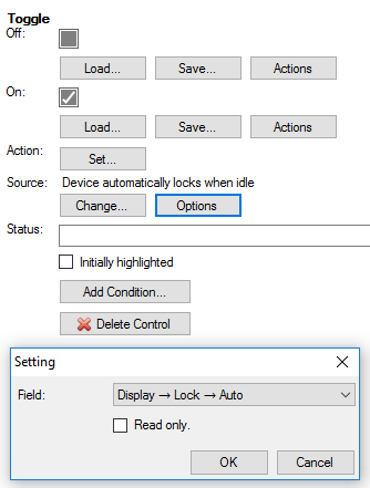

I spose the general tab would over rule the setting, but I have been controlling it on the mod a lot lately, sometimes I have it a 5 mins sometimes 60 mins and sometimes off. I have just done a quick test setting to 1 min and checking it locked after a minute, then turning looked off and checking after 2 mins that it is unlocked, the second test failed, but connecting to EScribe it cleared the checkbox on the general tab and it is still clear on the mod. So it is looking like auto lock is not working, but I recall it working during the testing, for now I would max the lock time as a workaround. -

In theme designer \ screens then select the screen the lock is on on the rhs, then select the checkbox. -

It's definitely working for me, check the toggle control source is Display\Lock\Auto-Lock and the on and off images are correct. -

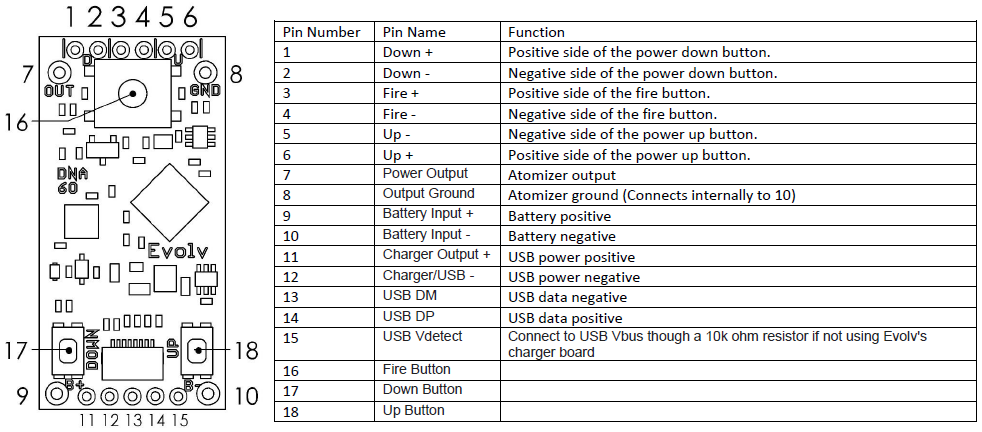

No just both power wires matching each other, not a big deal for such a short run though.
Looks good to me, I would use the same gauge for both power lines between the board and charger (conns 11 & 12).
