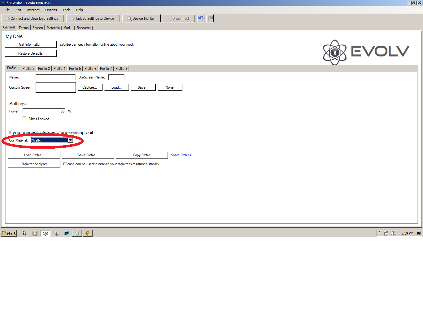

"ohms too high" means your coil resistance is to high for the wattage your are asking. the 167 max voltage output is around 6.2 volts. you can not lock ohms in power mode only TC mode. in EScribe, you can set up a profile for "watts"
