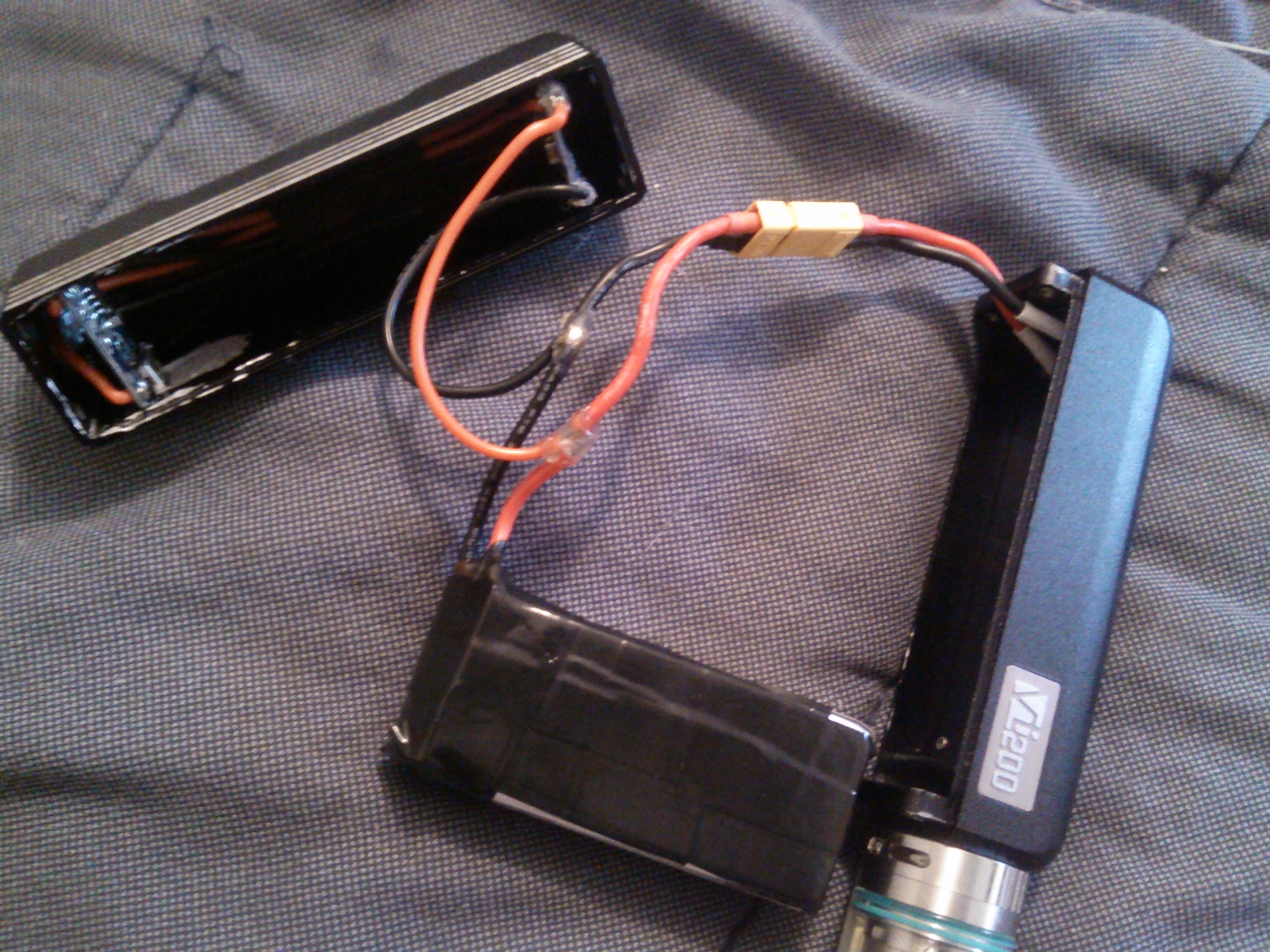

nice, an official dna 75 build thread. thanks dwcraig1! i hacked open a dead vt200. sent the dead board to evolv for replacement. rather than putting the replacement board back in i decided to put the 75 board inside. modifications required to install board are : chop off plastic oled screen stand offs (dna75 board components get in the way of it sitting flush), rewired/re-soldered stock 1300 mah 3s lipo for 1s 3p config (2898 mah according to battery analyzer). i'm bypassing the onboard usb charging ic for a higher (2) amp combo i put together. i dremeled/installed the usb socket on the side of the mod (limited space for it). my dremel skills are.........not great. that's about it. really enjoyed building this. plenty of current available to the board with this batt and the 3p lipo charges fast at 2 amps.

thanks awsum. with my 75 and the hcigar 3s lipo i rewired for parallel, the most sag i see is 3.8 volts at 75 watts preheat. if i find a sled that looks solid i'll let you know.

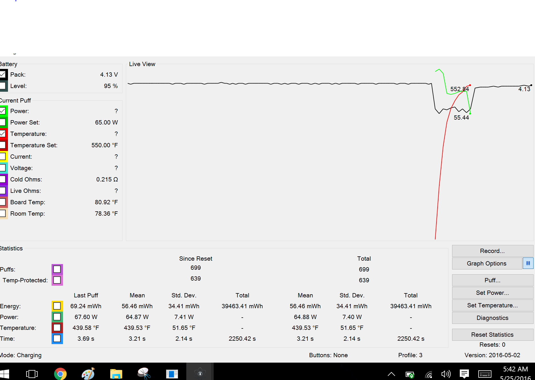

what mod is this? is everything set correctly in escribe, mainly under the mod tab? can you take and post a screenshot of what you have everything set to in under "manufacturers settings"? also a shot of device monitor while firing the device at 80 watts.

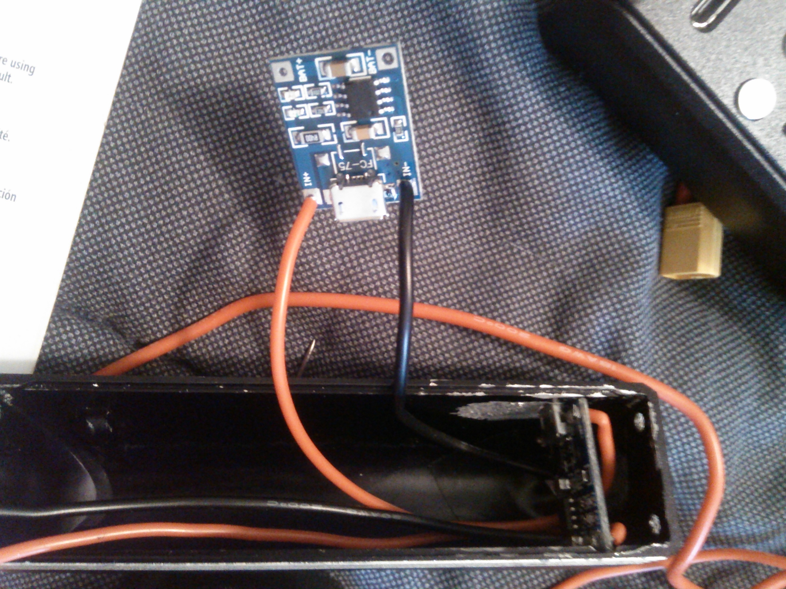

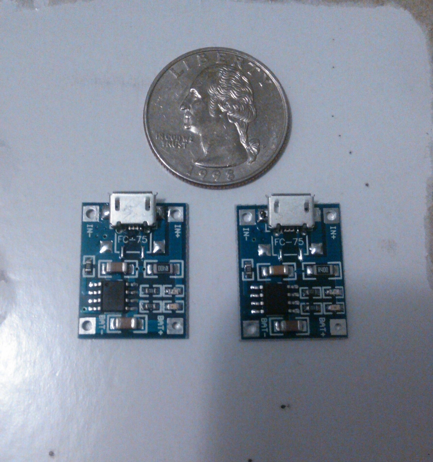

i'm going to open up my homemade vt75 and test the current going to the battery with my klein mutli meter and get this figured out. will post back. edit......the multi meter inline with the battery-to-board circuit confuses the board/charger. i could not get the usb current above .17 amps. at .17 amps i was at about 0.163 amps on the battery side/MM side (if the numbers are even accurate). oh well, i'm not complaining. this 3000 mah charges decently fast with the on board charger. although, i do have some tiny 1 amp micro usb lithium battery charging board. there's room inside for them. maybe i'll put them inside somewhere. you can stack these charging boards (parallel the outputs) to double the charge rate from 1 to 2 amps.
