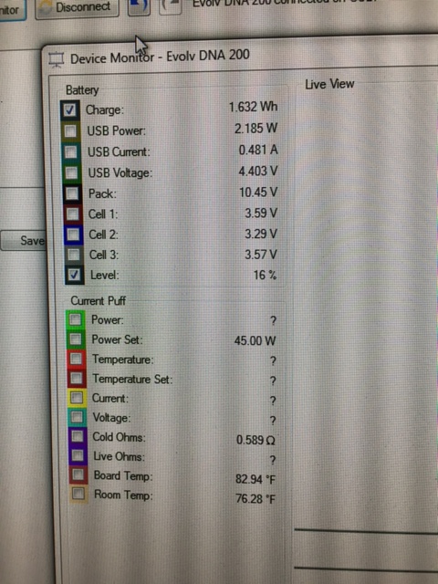

  2. So I went to have a vape today with 19% battery left and it wouldn't fire at all. No flashing battery bar, no errors. I checked in device monitor and saw the cells were 3.57, 3.59 and 3.29. I have the soft cell cut set at 3.2. I'm watching to see what happens while it's charging and it's slowly equalizing out after about 20 minutes of charging. Bum lipo pack?
