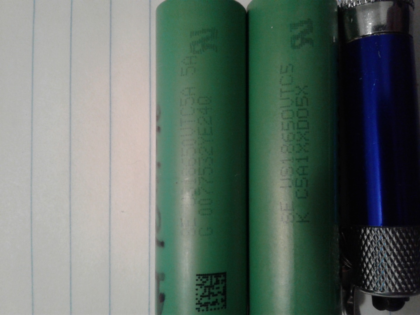

lol, I just posted a CSV for the same cell as in your pic. Doesn't matter where the cell was made. Same brand, same model. Use a Windows pc. Mac's are picky on what they will and won't do with escribe. TBH, I wouldn't even worry about the battery meter on a DNA 75. GET it close and call it good.
this is a discharge curve obtained from a Sony VTC5 that is about 1 year old with about 6 months worth of use. SONY VTC5 DISCHARGE CURVE FOR DNA 75 (CELL SOFT CUTOFF - 2.66V) Sony VTC5 Battery Curve (8.100).csv
left is VTC5A / right is regular VTC5 if you really want a CSV file for the VTC5 i can run it myself and post the curve later. just know it only makes the battery bar/meter more accurate with any given CSV curve that pertains to the corresponding cell. it will NOT improve your battery life.
if you got them in march of 2015, most likely they are not the new VTC5A. both are 2600mah, the VTC5A has a little bit better chemistry that translates into a slightly better performing cell.

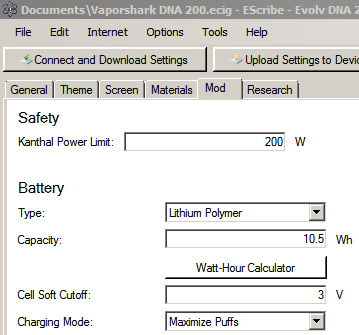

i'm pretty sure restoring it to factory settings will reset the board to evolv's settings, not vaporshark's, which you do not want to do. vaporshark actually took the time to set the battery curve, mod resistance and run case analyzer. so you can't connect to escribe? if you can go into escribe......under the "MOD" tab make sure you're settings are at these are my battery settings for my VS DNA 200 they will work just fine for yours. maybe cut the watt hours down to an even 10 watt hours to be on the conservative side. -
