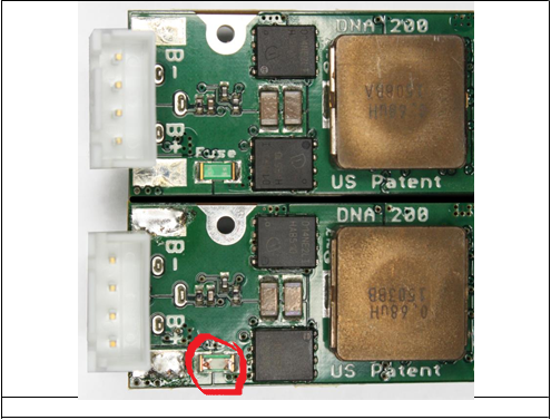

  1. Did you blow the on-board fuse? Edit: The DNA 200 doesn't have reverse battery polarity protection, so probably blew the fuse when wired backwards...
