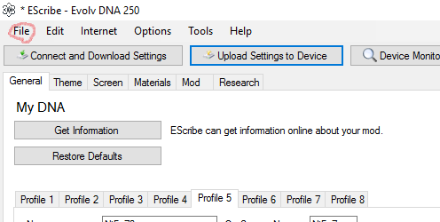

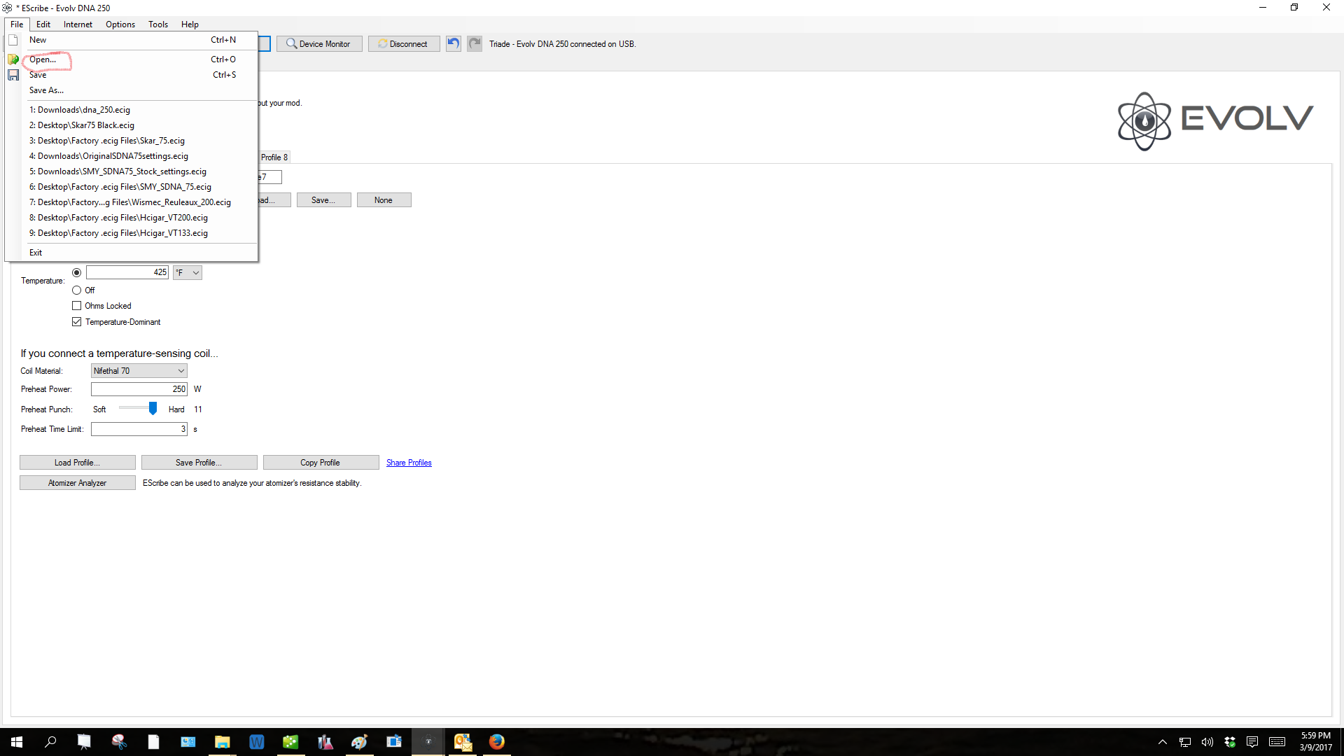

  2. Top of screen in Escribe is...'File' 'Edit' 'Internet' 'Options' 'Tools' 'Help'....Click 'File>Open' the pick the .ecig file...
  3. In Escribe, go to 'File>Open' and choose the .ecig file & it will load into Escribe. Then click 'Upload To Device' Edit: Read post #2 above...??
