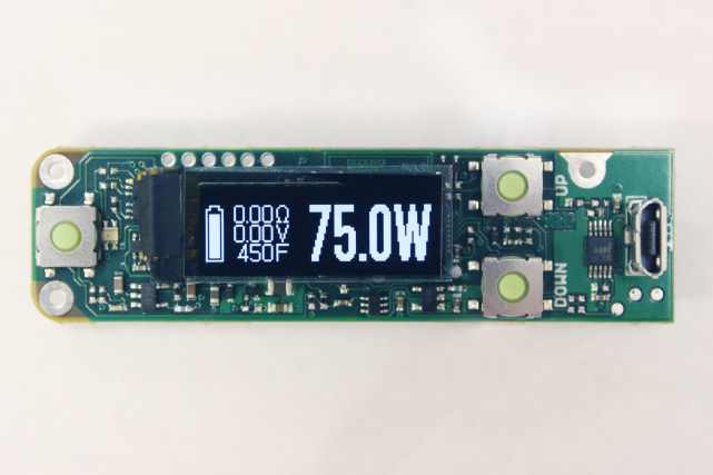

  2. Well, that at least that verifies that the wire was the cause of the down/left button to act like it did. It would appear, now this is pure speculation based on info available, that there was an issue in the past of the down/left button not working, so someone tried to remedy the issue by adding the wire to connect the switch direct instead of through the board circuitry, and soldered it to the wrong pin. If you have a meter, you check continuity between the switch...where the wire was soldered to...and the #4 pin.

  5. I didn't see the second board in your picture till I blew it up...if the #5 pin on that board is connected to the #5 pin on the DNA 75 board, then the down button on that board is connected to the 'up' circuit on the 75 board. Judging by your picture, that wire appears to have been added on...Remove it at your own risk, but that's what I would try.
  6. Sure doesn't look like a 75 board...check the difference from this picture off of Evolv's website... Button layout is completely different, as well as components on the board....markings on the board, etc...you may have a cloned board. But it appears that the black wire has been added & connected to pin #5 is probably why the down button is also activating 'up' as well. You might try removing the black wire & see if that fixes your issue.
