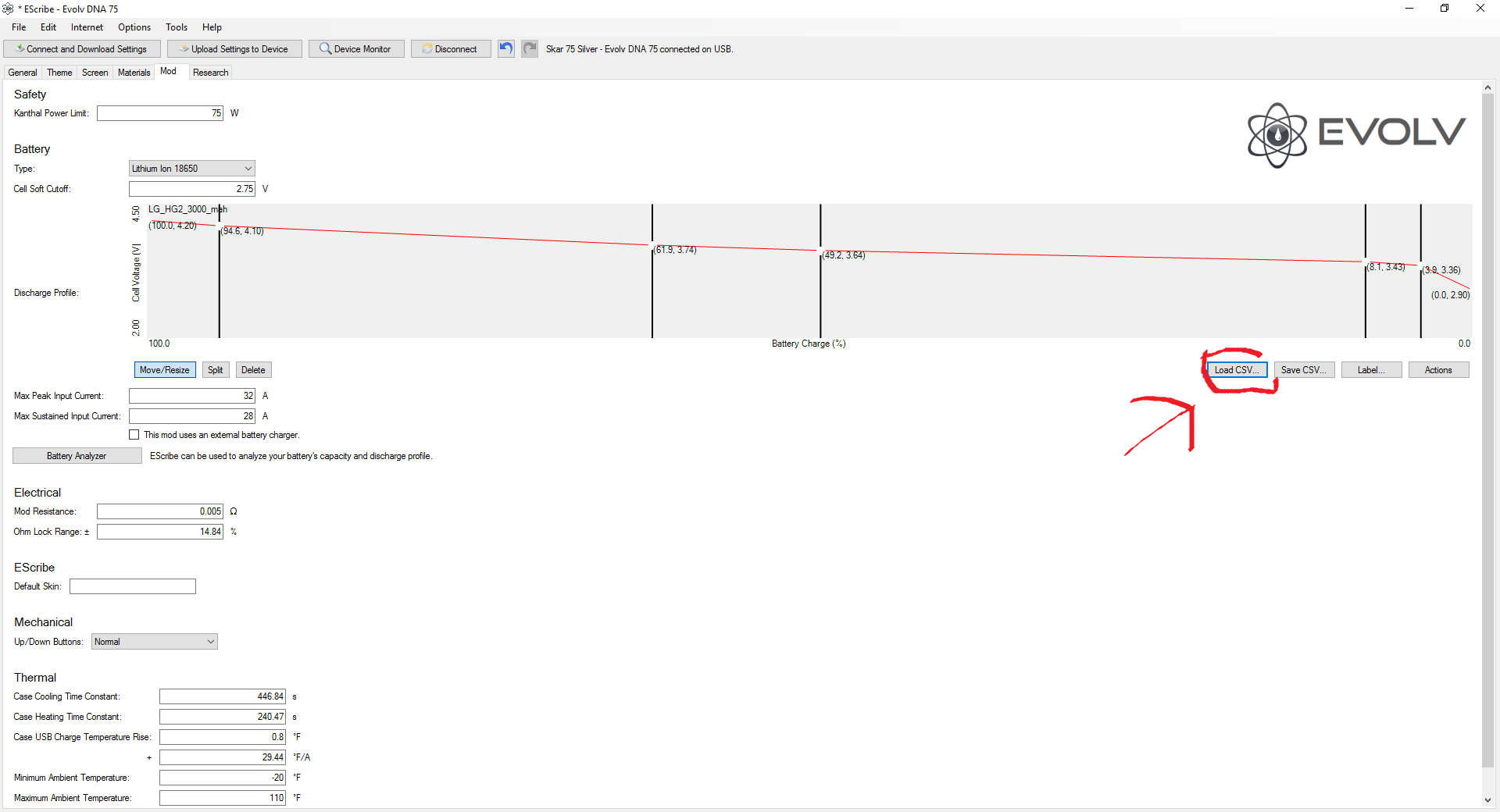

EScribe battery setting for Finder75
giz_60 replied to Putracci's topic in EScribe, Software and Firmware
For the 75 chip, you will need to run the battery analyzer to get the correct Wh value. It is not user definable with the 75 chip. The Wh that I came up with for that battery is 10 Wh, but you cannot manual enter it into the 75 like you can the 200/250. Here is the .csv for the LG HG2 that you can load into Escribe. There are a lot of post with info on running the battery analyzer in the forum! LG_HG2_3000_mah .csv -
