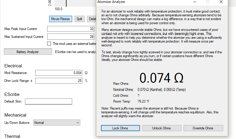

  1. Ok..took me a minute to remember...old timers disease......Set mod resistance to 0...attach cold coil..turn watts or temp to lowest...quick fire to get mod to check cold ohms...run AA & subtract the cold ohms
  2. Or...if you are using Windows...Snipping Tool...included in Vista & later versions...
  3. You can try this..on the last 250 I bought, I too was having the ? when trying to obtain the mod resistance due to the wonky Atomizer Analyzer..took a build that I knew the ohms...ran the analyzer & subtracted..in this instance, the build was .07?...this may help you get a closer idea as to your mod resistance...of the 7 DNA devices I have, they range from .003 to .005 Just make sure that the coil is cold..

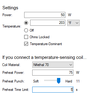

  11. Ok, I just set my DNA75 up like you had with the preheat & at 230°c,10w power, 75w preheat, my device was dropping out of TC & into power mode because at 10w power, the board is not seeing enough temperature rise...when I raised the power setting to 50w, it worked fine. Edit:...looks like retird beat me to it while I was typing...

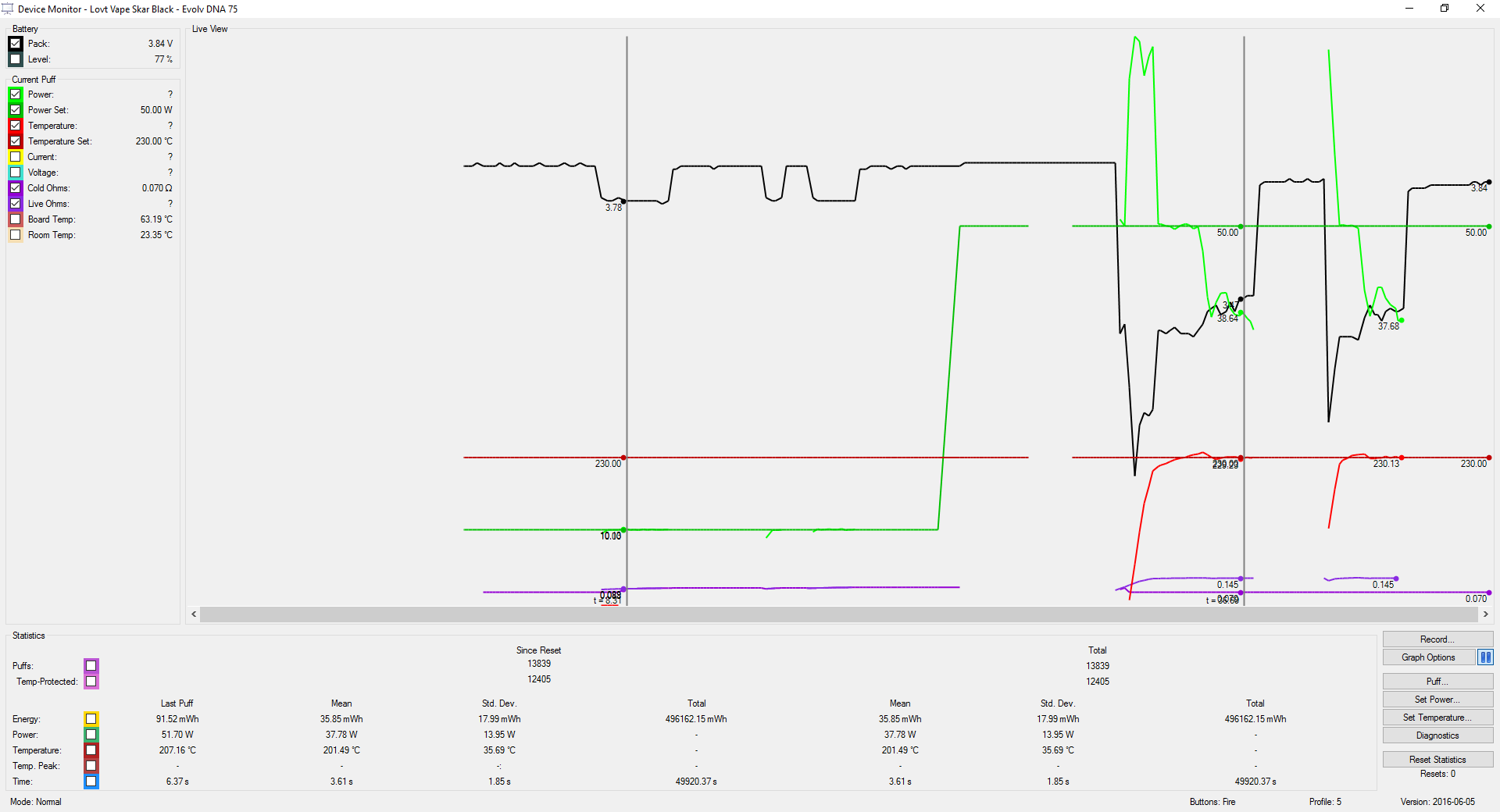

  13. Are you saying that it is not getting hot at all? Are you getting any messages on the screen? Can you post a screenshot of Device Monitor showing you firing the device?

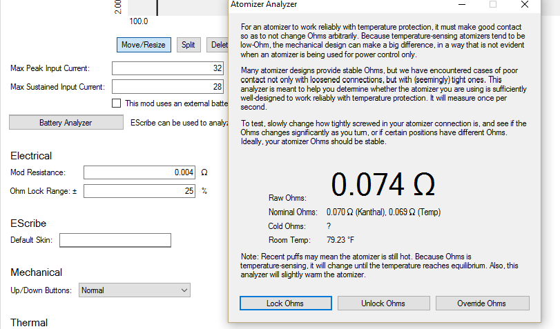

  17. Will need some more info...wire type?...atomizer?....TC or power mode?...etc...Have you checked resistance stability with the Atomizer Analyzer in Escribe?
