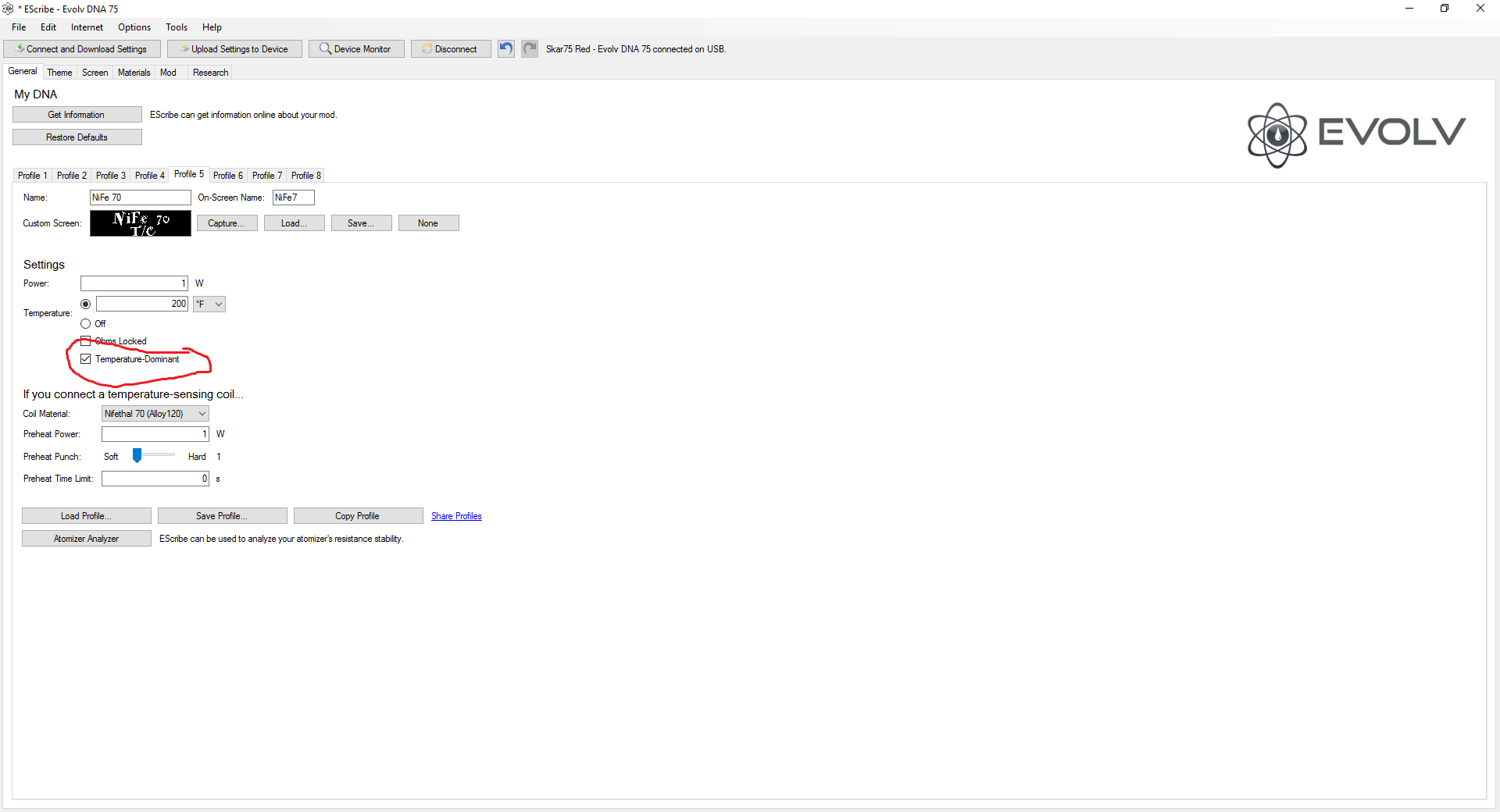

  9. The battery indicator flashing is the 'Check Battery' message...Can you post a screen shot of 'Device Monitor' in Escribe & of the 'Mod' tab? Edit: Device Monitor screen shot while firing the device...check 'Pack', 'Power' , 'Power Set' , 'Cold Ohms' , 'Live Ohms'

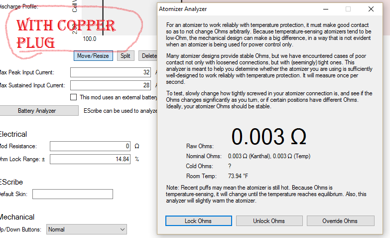

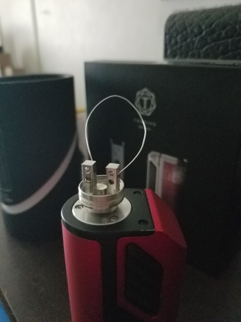

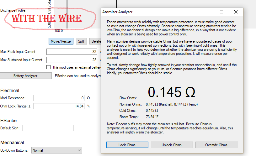

  13. And you have everything tight on the build? 510 pin is clean & tight? Try taking just a short piece of wire (not coil) & wire it across the deck...then try the test again...here is what I got doing this (just now)...had to use my 75 to use the plug, but the results should be the same on your 250...
  14. If there was that big of a difference, then something ain't right somewhere...what kind of atty, wire, coil build, etc...are you using?
