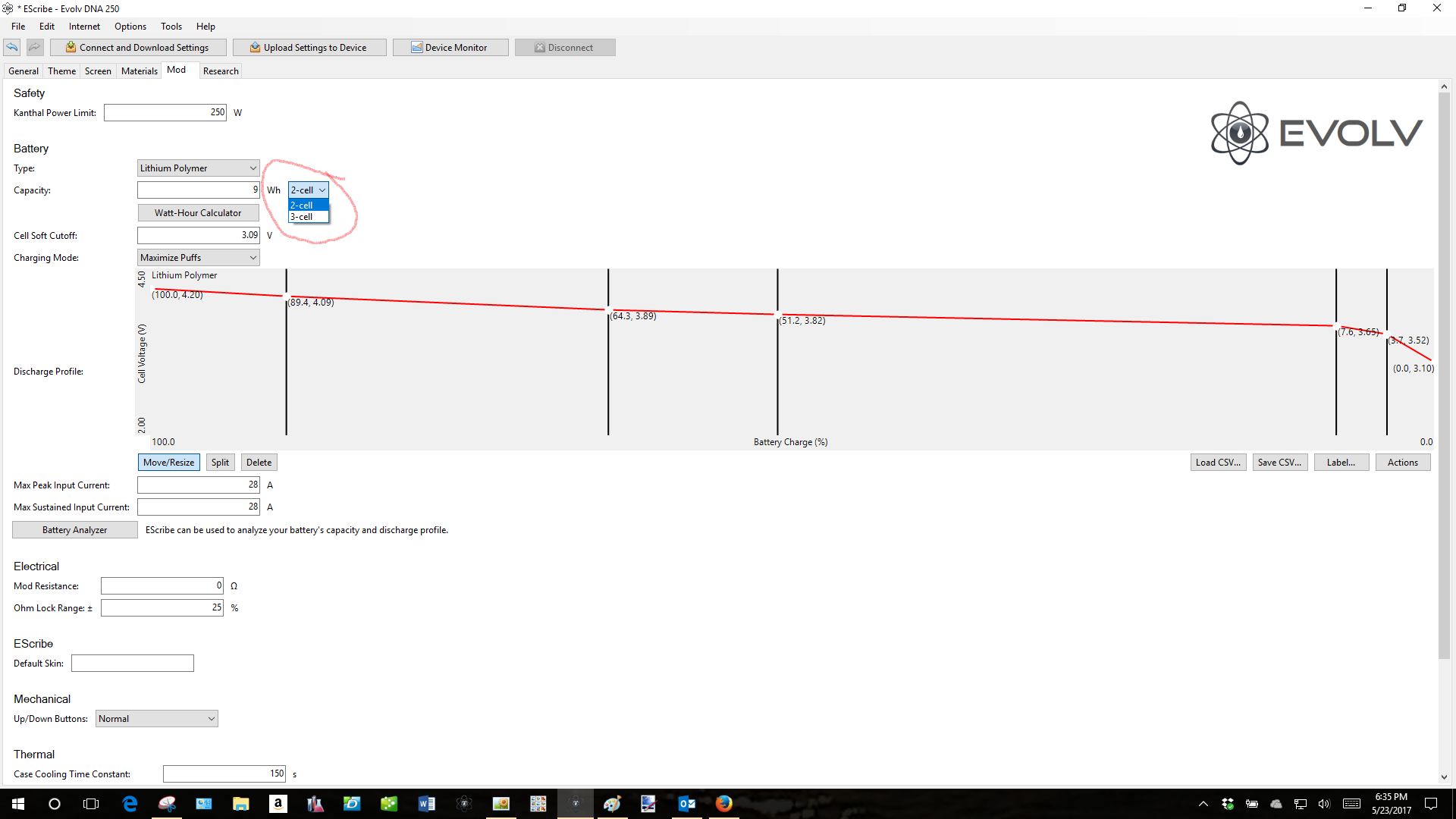

If that photo is from a Therion 166, it is looking for to many cells. Go into the 'Mod' tab in Escribe & make sure it is set for '2 Cell' & not '3 Cell'...then be sure to upload to device!
