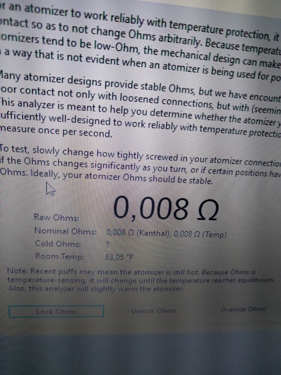

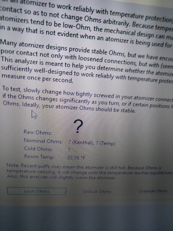

  3. Hi everyone, My device can't read under 0.008 ohms. I noticed this while shorting atom to know my mod resistance. No matter if I change atomiser or if I change wire (for instance I used a thick copper wire) but when I attach it, it start to read for example 0.011 and while I screw it began to go under and under, while the connection become more stable, until... 0.008 and then only "?". Picture attached. Please help! Shod I try to check 510 connector or maybe it could be a fault in the board? Thanks

  5. Hi @James, thank you for support. 1) My mod is a tugboat and I found someone who told me to set mod resistance to 0.007 and that's what I did. But my mod came to me set with a "zero" value. So I trusted that guy and set it to 0.007 at first day I received it. I'll search how to run this test, anyway. 2) yesterday I thought that maybe my .12 ohm resistance was too low, so I built a looped wire of 20cm (no wraps) of SS 316L with a total resistance of .90 ohm to be sure that my too low resistance was not causing the issue, but with no good results. 3) My SS wire came from zivipf.de a German well known wire as one of the best on the market. Also asked around discovering a lot of people are in trouble with SS. Also, my zivipf wire is going really flawlessly for someone (304L,316L,317L) but not for me, so at the moment I was not able to say what exactly is causing this behavior This weekend at vapitaly expo I'll get some 304 SS to try... Let you know and thanks for helping me

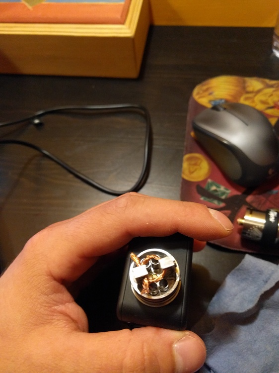

  7. Same story here... With 316L SS 0.60 first attempt and 0.50 second attempt, 6 wraps per coil - inconsistent temp curve staying at what device monitor says. No issue with nichel on the same atomizer. Later I'll try to use another atom and see what happens. To simplify tests o don't wrap and don't wick my coil just letting the wire looped and check device monitor while pulsing and firing. It just does not work. Downloaded csv files but did not change preheat and let it at 80 °C, how it wat set before on ni200 Check this pic
