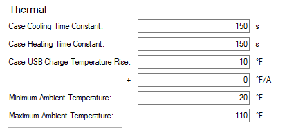

On a side note...have you run the case analyzer yet? Having the proper Case Thermal values is quite important when vaping in TC mode. At the bottom of the Mod tab, if your Case Thermal values look like the following screenshot, then you have the defaults..highly recommend running the case analyzer...will take awhile (couple of hours or so)...make sure your batteries are at least 50% drained prior to running the analyzer....and I would leave the computer alone while it's running because if for some reason the connection to the USB port is disrupted, it stop & you will have to start again..take it from experience... -
