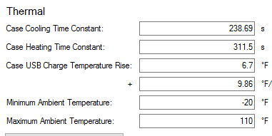

Those values are going to be slightly different from mod to mod, especially the case thermals...would be best to run the test for YOUR mod...that way you have the correct values....

It doesn't take any special tools, just have to make sure your batteries are at least 50% drained...it does take awhile for the analysis to run...but here is a screenshot of the case thermals off of my Therion

Sounds you are talking about 'Case Analyzer' for the case thermal values...The mod resistance is a different calibration process... -
