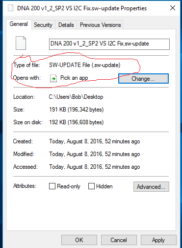

  19. KTMRider.... I tried to install service pack on my non-VS device using 1.2 and got same error message.... noticed while extracting the Zip file it didn't give the normal Evolv logo icon on the desktop file...
