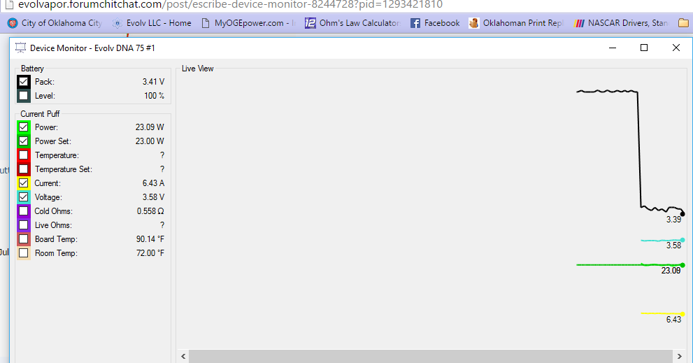

Curious.... could you post screenshots from Device Monitor of it (while charging).

hum..... both are regulating very good with the temp of the Therion not fluctuating as much as the Lavabox... , cold ohm's slightly different.... I guess the vape is great with both. So you can watch the Lavabox display the whole time you vape and the temp doesn't flash even once? If I recall the later firmware versions tightened the temp regulation so the temp doesn't swing as much above and below the set temp and what I don't know is how far above the temp setting must the temp reach in order to trigger the temp protect flash.... Maybe others can shed some more light on this but adjusting the temp and wattage a bit on the Lavabox may cause the flash to trigger but it is clear it is reaching and maintaining the set temp. So with the Lavabox can you get the flash if you chain vape it? In other words the flash can occur. -
Early Firmware and EScribe Suite Discussion Thread
retird replied to David Campbell's topic in EScribe, Software and Firmware
Yep, looks pretty good but what I also wanted to look at was the data on the left side of Device Monitor....the ohm's temp settings, wattage settings, board temp and etc. Kinda like this: -

I assume the coils used on all three devices are exactly the same ohm's? I assume all devices have the "mod resistance" properly set for that device? All devices with Evolv boards are not built the same and manufacturers configure them differently. With Yihi a SX Mini Q is a SX Mini Q.... every Q is the same whereas there are many devices with the only thing common to them is they have an Evolv board in them.. they can have different guage of wire, different 510 connector, different battery sleds, and etc. A minor adjustment in temp and wattage on the one device that is not reaching temp (to the point of flashing the message) should give you the flash... In Device Monitor you can check the boxes for power, power set, temperature, and temperature set and then see how close to the temp you are for each device. Probably not the best explanation and could write much more but that's the short version.... If you want to post a screenshot of each device from Device Monitor while firing the devices (with the boxes checked that was mentioned earlier), we can certainly look at them and see what they are doing....
