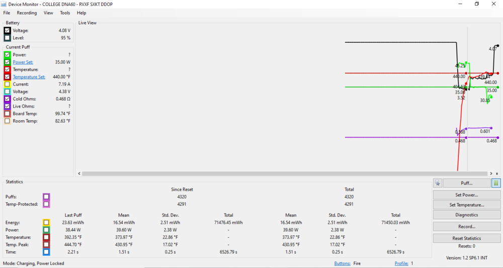

dwcraig1 Posted May 8, 2021 Report Posted May 8, 2021 Here I have EScribe's Device Monitor open and a DNA60 connected. I have taken a puff and hit the pause button. Then by hoovering the mouse curser over areas on the graph it will show the values at any given point. Note my cell was at about 4.1 volts before I fired it at 45watts preheat then 35 watts. During the 45 watt firing the cells voltage dropped to 3.52 volts. 3
