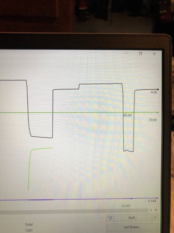

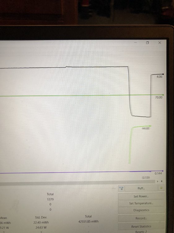

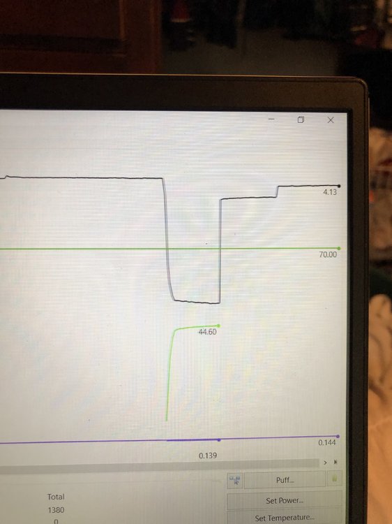

Okay so I’m this picture, I have a fully charged Samsung 40 t. The device is set on 80 watts. During a regular hit, it is hitting at 4.17 volts. Once the screen went black, it appears to be hitting at 46 watts, it also appears the volts went down. But after this, if I keep hitting it.. it still says upper 4 volts
The weak battery thing isn’t really an issue. I just assume that’s because I’m running it too high. And when it hits at half watts with the screen black, the voltage stays the same. The only thing that changes is the watts

I’m only getting a low battery message trying to fire at ninety. But the main problem is everytime I hit it and it’s in the black screen, i have it set at 70 and it hits at forty something. But as soon as I fire it again it’s normal
Yeah, I’m at work all day. I restored it again, and don’t hit over seventy watts, and the problem doesn’t occur. It’s only if I’m running high wTtage, as well as weak battery on a full charged batt

Yes, I was using watts profile two, that file I don’t think got a clear recording, because I didn’t know what I was doing. The problem I’m having is clearly going on in the pictures

This problem literally only occurs if hitting mod after screen has gone black. It will continue to hit at seventy or right under over and over until the screen turned off, then hitting the button to fire and waking it up at the same time, it will fire at 40 something

i deleted the post with the wrong recording.. this one above should show it firing like i feel its not supposed too
i posted the wrong recording. this is it. set at 70, hitting at 69, then 44 josh 2 record.csv
here is the recording of it firing normal, and having the problem. my device is set on 70 watts the whole time, it fired at 69 and then once the screen went black it fired on 42 or 43. can you see this? josh recording.csv
