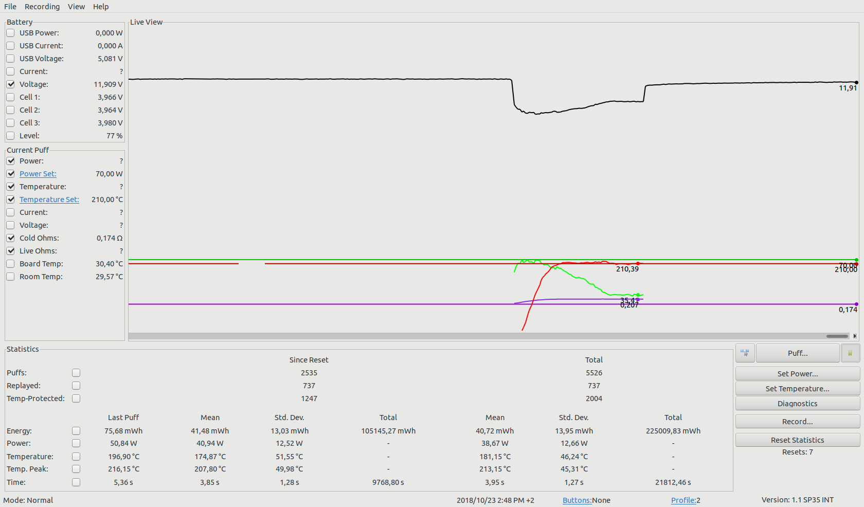

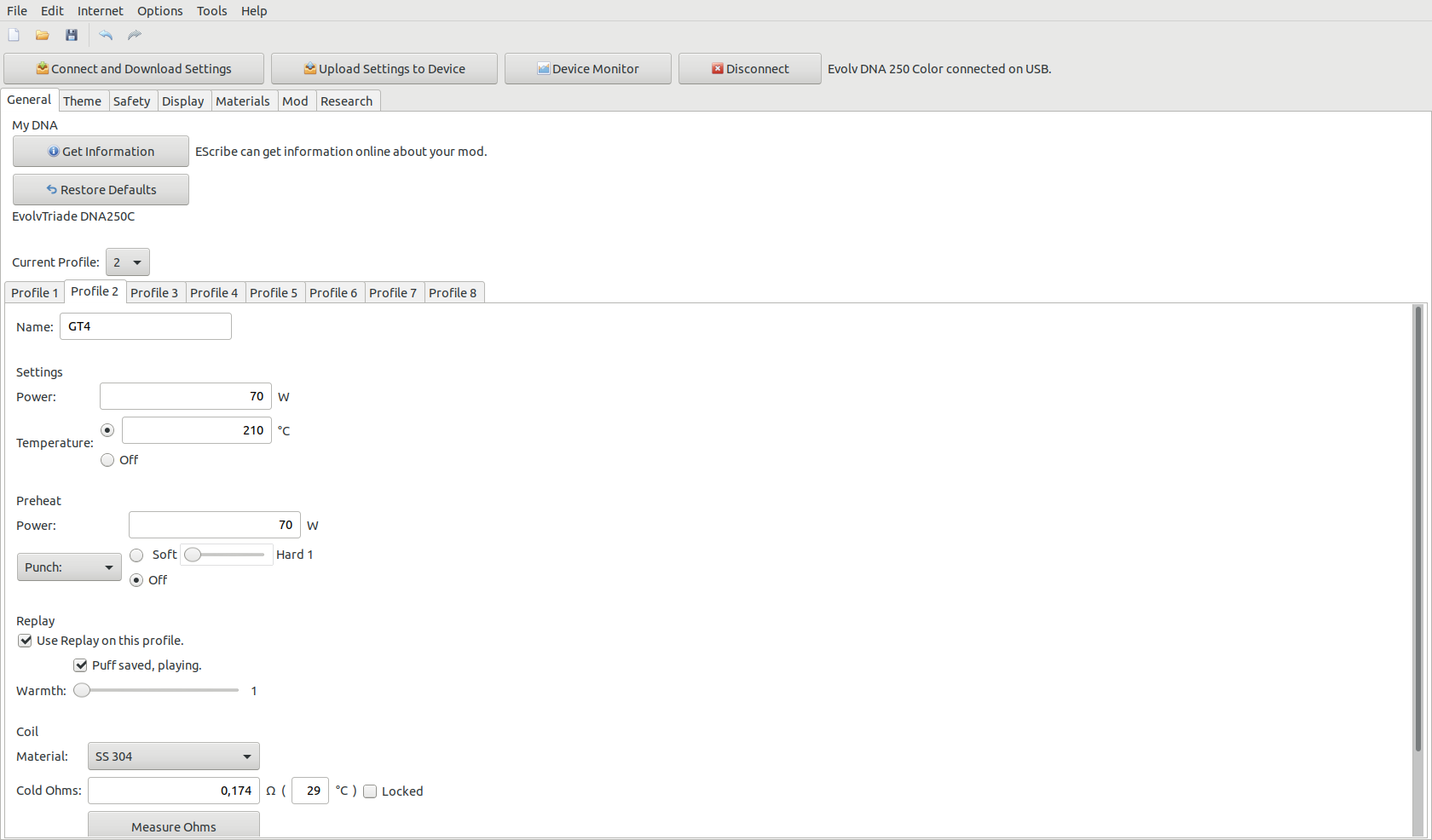

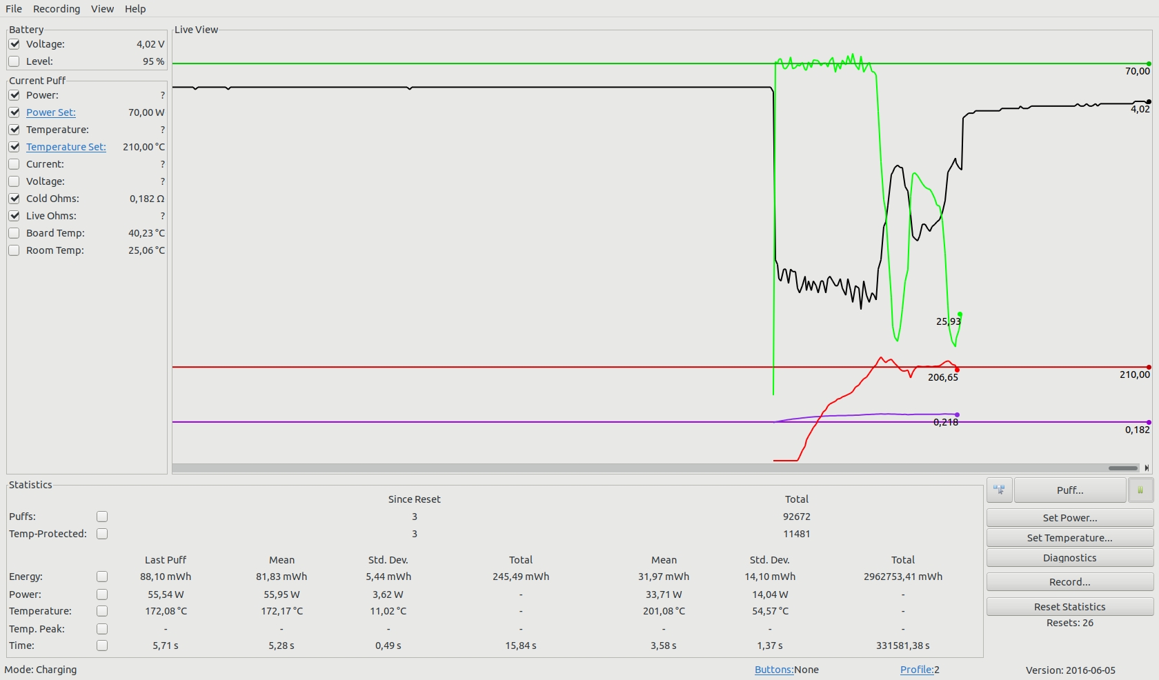

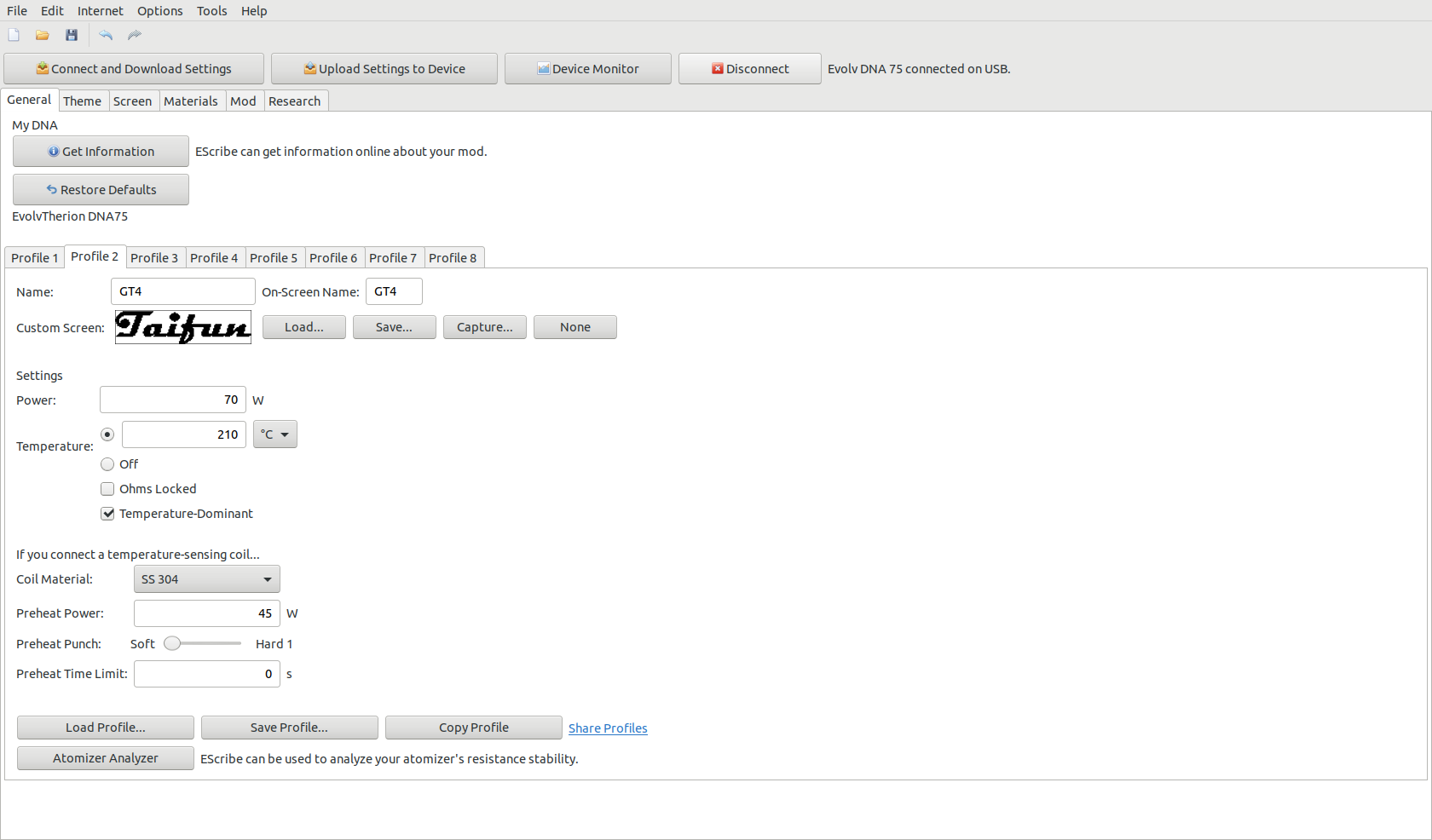

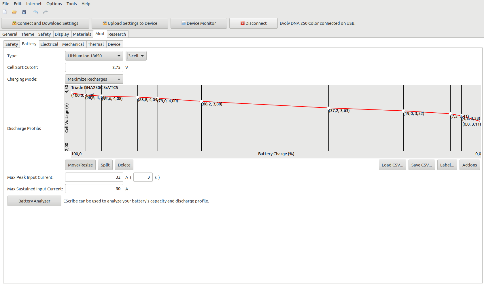

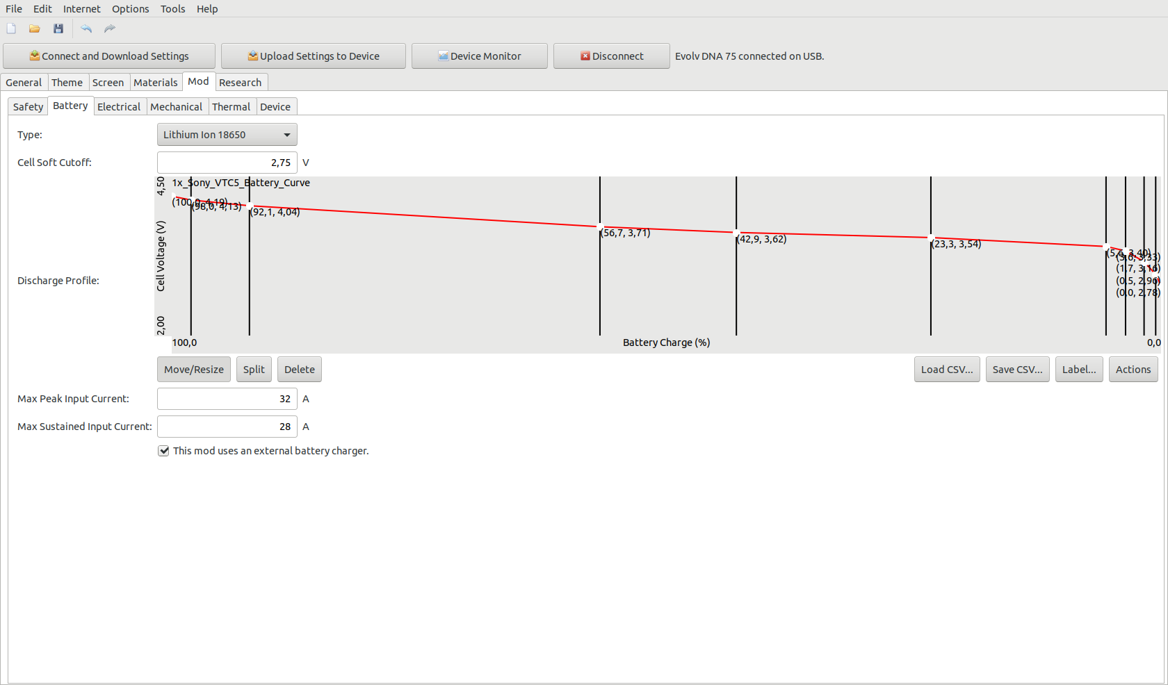

Lanzarotechris Posted October 23, 2018 Report Share Posted October 23, 2018 (edited) I still struggle with the REPLAY mode. Yesterday for example I tried my new atomizers (a Das Ding clone and a Corona V8 clone) with my Triade DNA250C and with my old Therion DNA75. On the DNA75 I used them both on Wattage and TC mode, on the DNA250C I used both on REPLAY and TC mode. Result: In Wattage and/or TC Mode on the DNA75 the taste is much better. More crisp and more flavour. In REPLAY mode it tastes flat... I also have to raise the Wattage and Temp to get even near a god taste. When I compare them both on the same Wattage (40 W) and Temp (235°C) there is a big difference in taste (and clouds, for which I don't really care, but it is noticeable). The coils are on both atomizers simple dual SS304 round material (0,4 mm) and the Ohms are around 0,2 and 0,3. I even used the same liquid, which is a fruity stuff (VG70/PG30). It's really frustrating, as I expected much more taste from these atomizers, especially as they are both told to be something "special" in relation to flavour. Did not have the time yet to compare both mods on the monitor, but will try soon. But I watched something like 10 wicking videos yesterday and it seems I did nothing wrong in that area. Any ideas what I can try to get better taste out of them ? In comaprison to the new atomizers I have no problems whatever when I use my Tsunami GT III or GT IV on both mods. They taste both great, but I can go about 10 Watts lower on the DNA75 (50 W with TC enabled) to get the same vape as from the DNA250C (60 W with TC and REPLAY enabled) on a single SS304 round wire with 0,17 Ohms). Both are set to 210 °C and the DNA 250C is set to no Preheat and the REPLAY is set to minimum warmth, no punch. I compare them with identical settings with the Tsunami GT IV (single coil, SS304 round material, spaced) @ 210 °C, 70 Watts, no Preheat, no Punch, Replay set to minimum warmth. The only obvious difference I see (despite the different curves they produce) is the difference in the measured Ohms (0,174 vs. 0,182). There is also a huge effect in comparison to the last escribe version, as the new one is sooooo slow, even the monitor is stopping at some point without reason. I have to wait for even a minute to get it running. I also recognized that the 2 mods have different screens in the settings... for example I can not see (or measure) the Ohms on the DNA75 as you see on the pics. Why is that so different ? I don't think that it should matter which DNA I connect to have the same GUI and settings/possibilities/values. There should also be no difference when I use the same settings for the same atomizer to (re-)produce the same vape. Or as someone yesterday in a wick video said: I am a customer, and you can not expect that everyone is a trained technician or electrician, to use these devices (which by the way I am, and even I struggle with it!). EVERYONE can buy them, so the target should be that also EVERYONE should get a decent vape out of them regardless of his knowledge. Right out of the box I should say. Without needing a master certificate to handle them properly. Companies (not only Evolvapour, but also the atomizer manufacturer, mod manufacturer, etc.) should think a moment about this... as the target should be EVERY smoker in the world. Regardless how sophisticated or intelligent he is in handling these devices. Just thinking... I also can not deactivate the battery charging on the DNA250C (which is useful when On the DNA75 I can under the battery options I can set the tick to "This mod uses an external battery charger". On the DNA250C this is missing. Instead I have a dropdown field to choose the charging mode, which also lacks the option to choose an external charger. At least you should be consistent with the options when you make a software that supports different mods/models. Edited October 23, 2018 by Lanzarotechris additional info about battery screen Link to comment Share on other sites More sharing options...

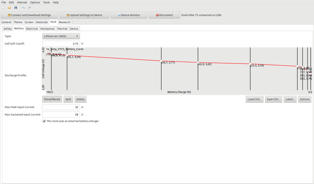

Wayneo Posted October 25, 2018 Report Share Posted October 25, 2018 On 10/23/2018 at 1:07 PM, Lanzarotechris said: I also recognized that the 2 mods have different screens in the settings... for example I can not see (or measure) the Ohms on the DNA75 as you see on the pics. Expand Different architecture and generation boards. On your 75, click Atomizer Analyzer button. On 10/23/2018 at 1:07 PM, Lanzarotechris said: I also can not deactivate the battery charging on the DNA250C (which is useful when Expand Different generation board. Click Diagnostics in Device Monitor. 1 Link to comment Share on other sites More sharing options...

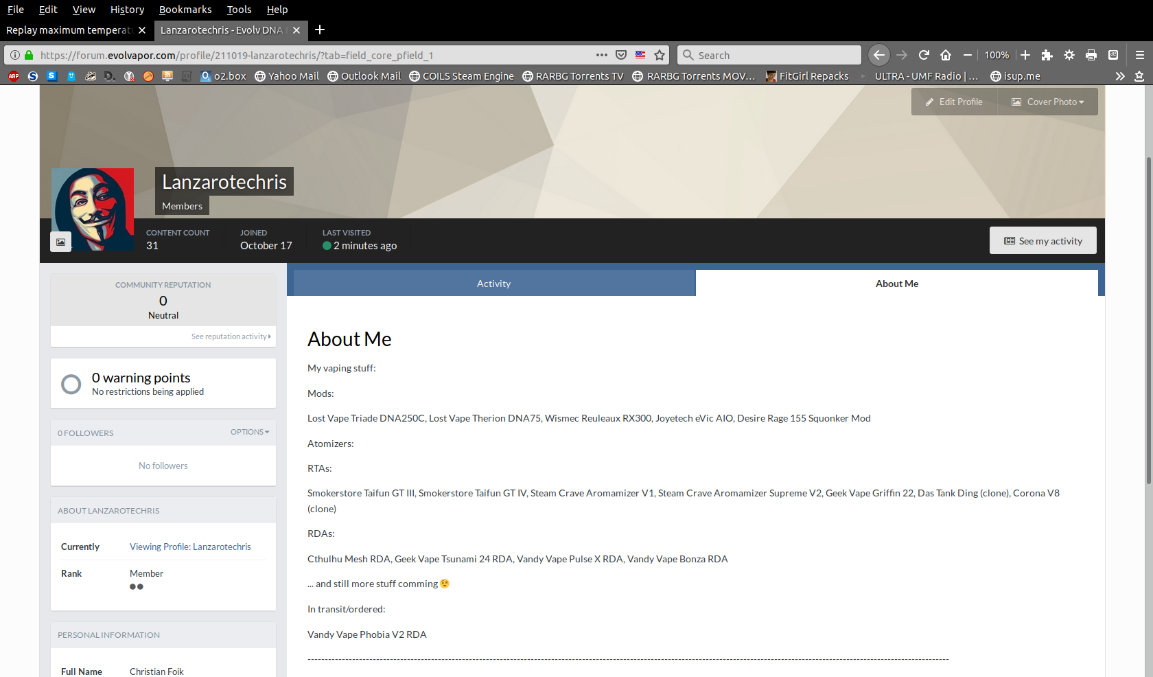

Lanzarotechris Posted October 26, 2018 Report Share Posted October 26, 2018 (edited) Thanks a lot... I was really missing the 2nd setting as I use an external charger. Any idea why the different curves on the monitor, or why the ohms are different ? Like I said: same atty, same settings, only different mod (DNA75 vs. DNA250C). The ohms should be identical, right ? (and yes, I have had let them cool down) BTW: just a thing about the forum navigation... where can I and others see my "About Me" page ? I can't see it if I don't log in (external visitor like), but I can also noone's page too (I chaecked a few members pages and there is no lik to "About Me". Is it only for the staff or what is its function ? I thought it would appear for at least forum-members who are interested and visit my profile page. Edited October 26, 2018 by Lanzarotechris additional text Link to comment Share on other sites More sharing options...
Wayneo Posted October 26, 2018 Report Share Posted October 26, 2018 On 10/26/2018 at 2:37 AM, Lanzarotechris said: Any idea why the different curves on the monitor, or why the ohms are different ? Like I said: same atty, same settings, only different mod (DNA75 vs. DNA250C). The ohms should be identical, right ? (and yes, I have had let them cool down) Expand Damn, I wished you hadn't noticed that. And here's where we get into different mods again. This will all sound Greek, you might need to read it a couple times. If both mods were properly thermally calibrated your room temps would be closer. If both mods had their internal resistance properly set, your mod would take into account those unique minute differences in connection losses up to and including the 510 connector of the mod. Now even if both those were done, the non C mod (Your 75) uses the info above to derive the 'refined' value of the ohms of that coil at 70F based on that derived room temp at the time. (So long as you didn't lock the resistance). Here's the difference A Color mod uses the current Ω and same current derived room temp as its base values, and writes that into the profile it was created. Hence 'a' difference. BUT if one were to refine your SS304 coil to 70F it would drop the value even further to ~.1725Ω (using the tcr of 0.00100) compared to your .182Ω on the 75. These all play into it. On 10/26/2018 at 2:37 AM, Lanzarotechris said: BTW: just a thing about the forum navigation... where can I and others see my "About Me" page ? Expand I dunno, I can't remember seeing or noticing an 'About me'. 1 Link to comment Share on other sites More sharing options...
Lanzarotechris Posted October 26, 2018 Report Share Posted October 26, 2018 (edited) On 10/26/2018 at 4:58 AM, Wayneo said: Damn, I wished you hadn't noticed that Expand hehe, THAT never will work with me,... I have a special sense for little details 😉 But if you have said something like it is calibration related I could live with that. But I guess I should try stop comparing the DNA75 with the new C-models. (But it was so easy to handle and to set up... still my favourite, except for the battery problem) https://forum.evolvapor.com/topic/70404-therion-dna75-outer-battery-not-discharging-how-to-fix-it/ And what about the slow monitor software ? any thoughts on that ? Until the version before, it was flawless... Got a ubuntu upgrade too last week, but as the windows version is also laggy, that could not be the reason. It just stops measuring after a minute or so, and then I have to wait for 1 or 2, and then it stops again after a couple of minutes... Hard to work with, as I have to constantly wait for the right moment to make the puff... About the "about me" page.. its in your profile... on the main page you get the activity view and on top of it there is a 2nd "tab" called "about me". I filled it out right after the registration, but it seems noone can see it, which is a little bit silly, right ? With a right-click on it I get this link : https://forum.evolvapor.com/profile/211019-lanzarotechris/?tab=field_core_pfield_1 looks like this: Edited October 26, 2018 by Lanzarotechris added screenshot Link to comment Share on other sites More sharing options...
Wayneo Posted October 26, 2018 Report Share Posted October 26, 2018 @Lanzarotechris I'm a Mac High Sierra user. I also find 'starting up' escribe slower with this latest version. No idea about the next release. After trying 3 different browsers Safari, Firefox and Chrome I still don't see the About Me. No idea about your battery issue. Happy vaping. Link to comment Share on other sites More sharing options...
