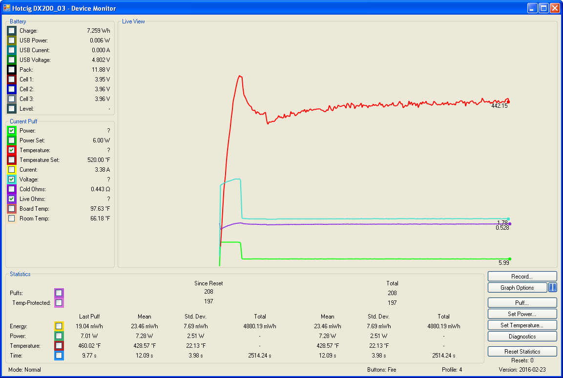

In Temp mode the coil performs as shown in this screen shot:
I'm wondering why the temp is not more smooth and the temp is fluctuating so much?  (SS316 material setting used) Could it be that a "notch coil" specific TCR is needed.  They heat very quickly and cool quickly thus that could account for the performance as shown in the graph.

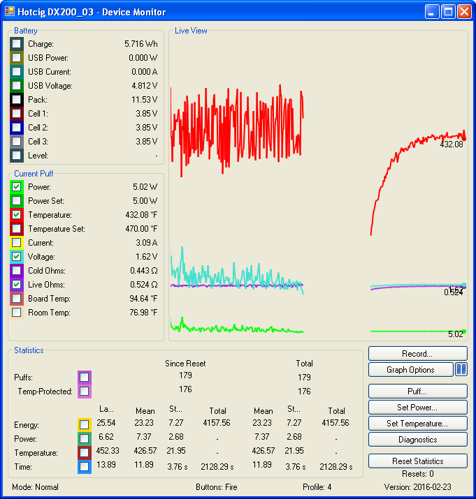

Yeah I am not a big fan of SS and I had a very bad experience from it with smell and taste I may go into later. But since the TCR value is so low for SS, the resistance changes far less in regards to temperature than other TC types. Although I just got an idea and I think if the wattage is set slightly too low, it might smooth out.
Yes it works like I thought it would. Here is a SS316L single coil set at 20 watts on the left. Changed it to 5 watts. See how it smooths out?
The Notch coil has a lot of mass (surface area) ....  strange animal in temp mode.... I've tried many different temp, wattage, and preheat settings and when the vape doesn't reach set temp it is pretty smooth but a setting that reaches temp setting gives a very different and less smooth graph after it gets to temp...  I contacted Wismec last week but no response yet....
THX for your interest.... will continue to play with this animal.... 9_9
What does your Device Monitor show now? I switched to Power Dominant and regulating temp by the wattage instead of the temp. So it is like running SS in power mode except you have the extra TC benefits. I am MTL this SS316L and I set the preheat (I turn it off when using Temperature Dominant) to 20 watts for 1.5 seconds. And maxed out the punch. And this is how it looks now.
