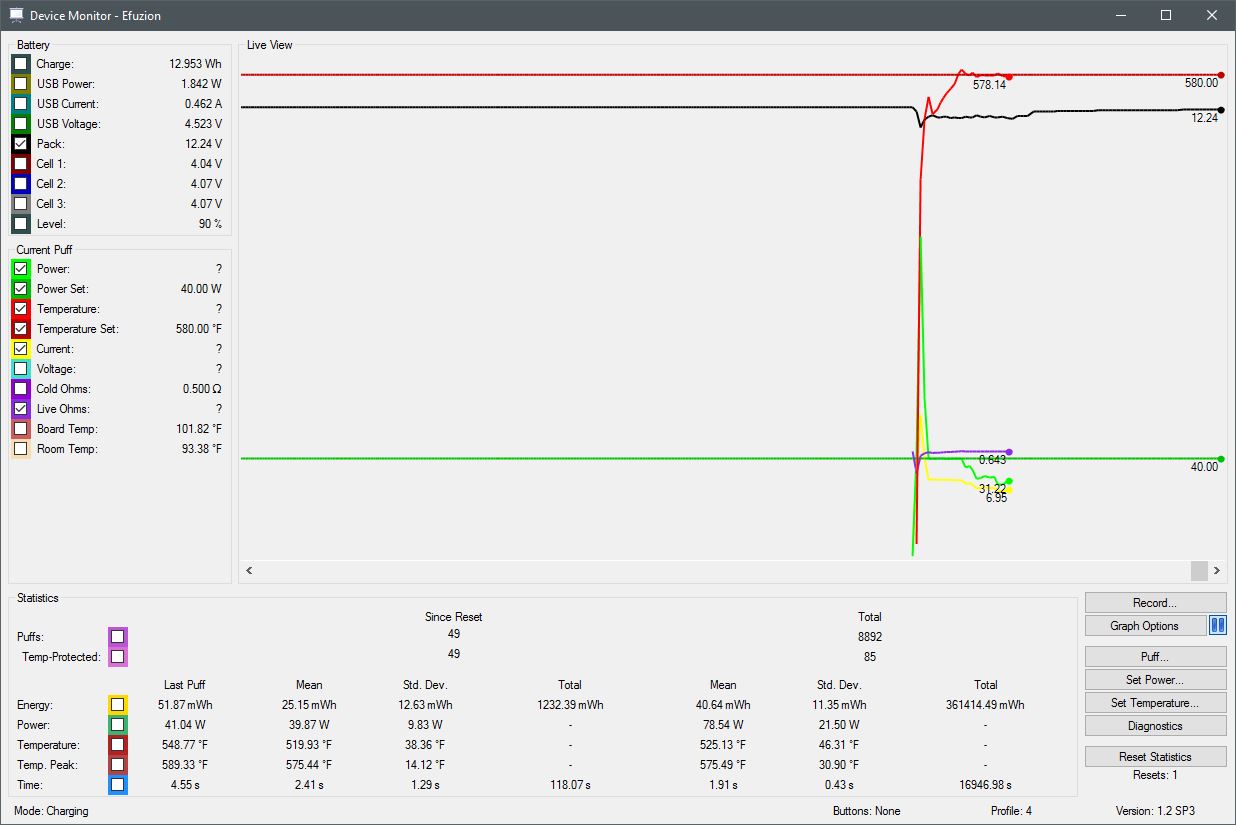

Ethrem Posted October 21, 2016 Report Posted October 21, 2016 kidrock247 said: https://forum.evolvapor.com/topic/65874-topic/?do=findComment&comment=891734Try the profiles listed in the above post. v3.25 works best for me(using a ss 316l 0.4 phm clapton coil head for the asipre cleito on a vt133) Expand 3.25 still doesn't have the smoothness that even my Coolfire IV TC100 has using the same coils you are. I switched to 3.5, dropped the preheat to 1W, soft punch, 1s, 55W power and I run it at 550F and it's somewhat comparable to the TC100 at 530F but it still feels off. I also don't get how the Coolfire handles TC so well with Crown SS coils even though they are meant for TC and the DNA can't handle them at all. At least it doesn't kick me out to power mode like I've heard of in the past but it's definitely irritating.

Ethrem Posted October 21, 2016 Report Posted October 21, 2016 VapingBad said: Do you have the latest firmware (V1.2SP3), you can see the version in the bottom right had side of device monitor. Expand My Triade came with SP3, it didn't work and it doesn't work on SP4 either unless I totally messed something up (which is possible, it's my first DNA after all).

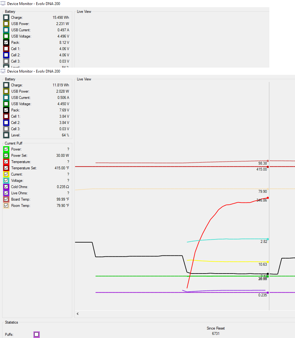

arby Posted October 23, 2016 Report Posted October 23, 2016 I built some dual 10 wrap contact 24 gauge 316L which cold reads at .2117 and when locked at that value it really sucks but if I force it to lock at .23 or .24 I get way more vape and it doesn't hit temp cut off quickly. Is this safe to do? I can't find a successful vape and I've tried the UD 3.25 and 3.5 values posted here in this thread without locking it at a higher ohm.
Azzitude Posted October 23, 2016 Report Posted October 23, 2016 The Cubis coils BF 316SS coils won't work in SS316 or SS316L modes for crap, But they DO work albeit @580F in SS304 Very Well on the DNA20040W580F200 Ramp @ 2 secHits Temp very fast and holds steady using about 31w in the end

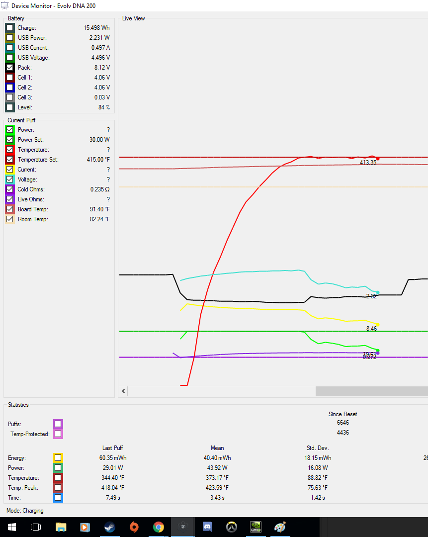

arby Posted October 23, 2016 Report Posted October 23, 2016 dual 10 wrap contact 24 gauge 316L which cold reads at .2117 but I locked at .235; power 30W, temp 415F, preheat 1W @ 1 PHpunch and time of 1s. Works great in my Griffin 25. Flavor is nice, it's warm, and I'm using DJaquith V7 for SS 316L. First puff takes a second to warm up but it holds a nice steady stream of vapor even up to the temp cut off and it starts to get weakened a bit but not as bad as it did before I tweaked it. If I set the temp to 420 or even 425 it gets warmer but I feel like the cotton gets kinda dry at those temps. Might be my wicking and could use less cotton bacon but for now it's great.Thanks DJ for all the CVS files!Running on a Vaporflask 133 by Vapor Shark. EDIT: After rewicking it with less cotton I think the better juice flow keeps my temps from climbing even more and it doesn't even hit 400 now. This is AWESOME!
aabbas Posted October 23, 2016 Author Report Posted October 23, 2016 arby thank you for the wicking tip.
aabbas Posted October 23, 2016 Author Report Posted October 23, 2016 Finally got what was wrong, it seems that locking the ohm is essential for TC. Thanks to Joel Al last enjoying my DNA200
arby Posted October 23, 2016 Report Posted October 23, 2016 aabbas said: Finally got what was wrong, it seems that locking the ohm is essential for TC. Thanks to Joel Al last enjoying my DNA200 Expand Glad to see another vapor enjoying their temp control. I know that feeling of success, it's great.
