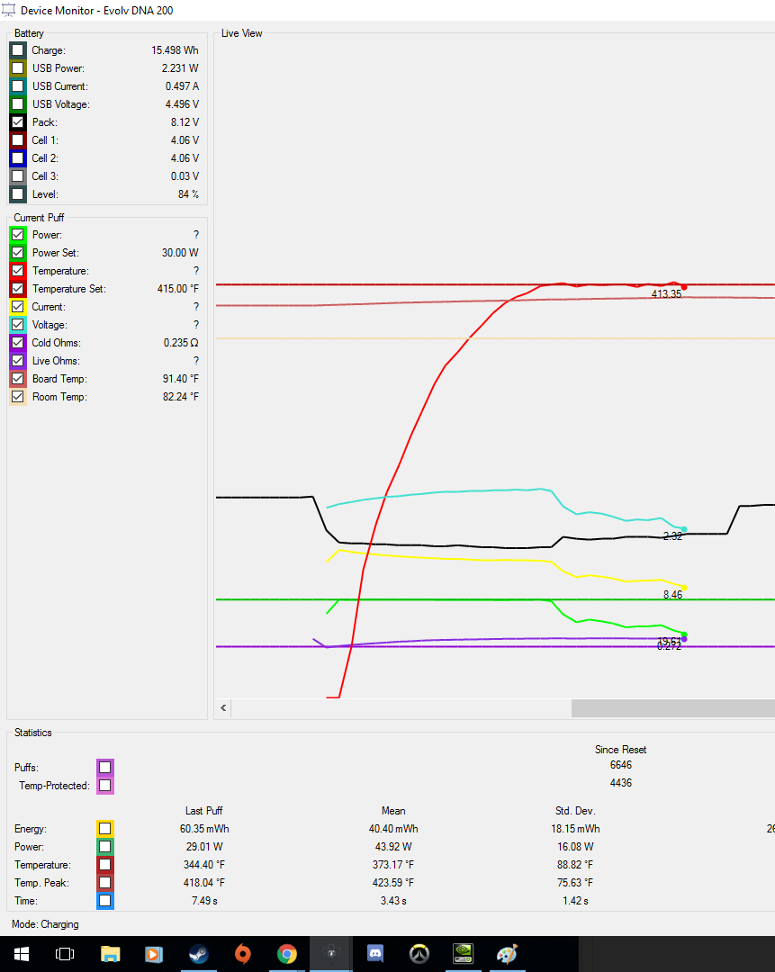

  11. arby
    SS316L Again
    dual 10 wrap contact 24 gauge 316L which cold reads at .2117 but I locked at .235; power 30W, temp 415F, preheat 1W @ 1 PHpunch and time of 1s. Works great in my Griffin 25. Flavor is nice, it's warm, and I'm using DJaquith V7 for SS 316L. First puff takes a second to warm up but it holds a nice steady stream of vapor even up to the temp cut off and it starts to get weakened a bit but not as bad as it did before I tweaked it. If I set the temp to 420 or even 425 it gets warmer but I feel like the cotton gets kinda dry at those temps. Might be my wicking and could use less cotton bacon but for now it's great.Thanks DJ for all the CVS files!Running on a Vaporflask 133 by Vapor Shark. EDIT: After rewicking it with less cotton I think the better juice flow keeps my temps from climbing even more and it doesn't even hit 400 now. This is AWESOME!
  12. arby
    SS316L Again
    I built some dual 10 wrap contact 24 gauge 316L which cold reads at .2117 and when locked at that value it really sucks but if I force it to lock at .23 or .24 I get way more vape and it doesn't hit temp cut off quickly. Is this safe to do? I can't find a successful vape and I've tried the UD 3.25 and 3.5 values posted here in this thread without locking it at a higher ohm.
