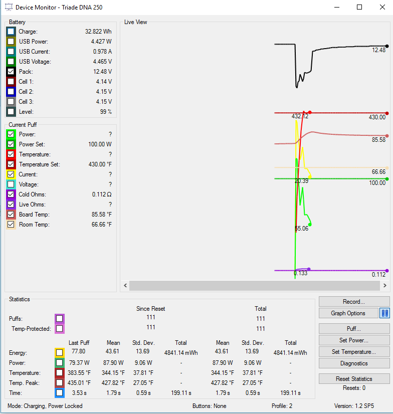

Viruk Posted December 5, 2016 Report Posted December 5, 2016 Sorry to disagree with Car147 - but this is just what works for me. You just need to experiment and use whatever works for you... on to my setup: I use fused Clapton in SS316L, I don't space my coils. I never lock my resistance and can get a very nice vape. I use the steam engine settings for SS - they list it on their wire wizard page as "SS316L / Elite" http://www.steam-engine.org/wirewiz.asp#Select the coil material and click the DNA200 button next to the temperature control results then you can grab the csv to upload to your device.I posted this screenshot in a different discussion yesterday, but its appropriate here: I've found a low punch works well for me with a high wattage, but you'd need to find out what works for you depending on your coil setup and resistance. I'm just using a single coil setup in a new dripper tank - its quite a big coil but still using stainless. I'll get a shot of that and a shot of device monitor too if you're interested. Check your resistance is stable using atomiser analyser and make sure the setup has time to drop to room temperature after you've built on it and fire it for the first time so you get an accurate resistance. There are lots of ways it will work well depending on your setup and preferences - good luck

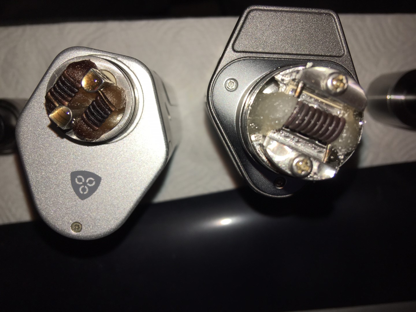

Viruk Posted December 5, 2016 Report Posted December 5, 2016 The builds... On the left (on the Wismec Reuleaux DNA200) is the dual coil SS316L fused Clapton that is shown on the shot in the previous post - although that device monitor shot was firing that setup on the lost vape Triade. On the right (on the Lost Vape Triade DNA250) is a single coil using the same SS316L fused Clapton. The temp control can be seen working in this shot of device monitor:

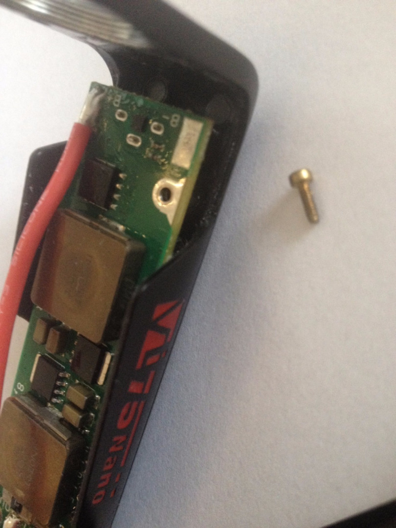

giz_60 Posted May 27, 2017 Report Posted May 27, 2017 You might try checking the ground screws on the board. If not tight, can cause issues! 2
Canadianvape Posted May 27, 2017 Report Posted May 27, 2017 15 hours ago, giz_60 said: You might try checking the ground screws on the board. If not tight, can cause issues! That fixed it! Thank you very much... I'm still on the fence on the dna250 since I don't use 200w on the 200 ( 6 months and no problems)
